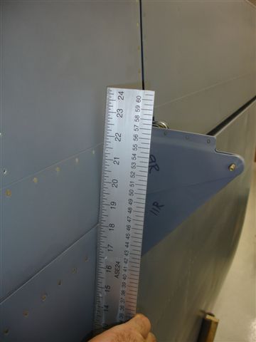

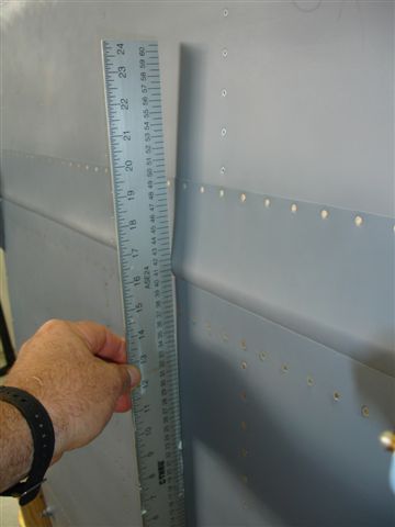

OK. Pictures are worth a thousand words. Below are several pics I took of the flap wing gap.
The first pic was taken between the two inboard flap hinges. Notice how the flap sticks out below the bottom skin.
The second picture is a closer look. Pretty ugly.
The third pic was taken right next to the middle flap hinge bracket. Perfect!

Vern(at)teclabsinc.com Guest
Posted: Mon Jun 12, 2006 2:30 pm Post subject: Trailing Edges |
Hi Zack,
Don't know if I can be of much help. I jumped over the fuel tanks and
skinning the bottom of the wings so I'm not able to hang my flaps at
this time.
After looking at your pictures here are some things to think about. Is
the distance between the hinge pivot and the bottom skin the same for
each hinge (check both the wing half of each hinge and the flap half)?
Is the nose skin of the flap more reflexed (sagging) at the inboard end
of the flap? If you have access to a digital protractor clamp the flap
in place so it won't move and take angle readings off of the main skin
(from front to back) along the length of the flap and wing.
Here is the thinking behind it. If either half of the hinge points
progressively run down hill in reference to the skin the whole flap
would droop at one end. Don't know how this could happen with the
pre-punched kits.
If the protractor reading progressively gets worse down the length of
the flap then the problem may be the twist in the flap is centered
around the spar flap (this would cause the leading edge to droop and the
trailing edge to rise or via versa. Well that's my $.02.
Vern (#40324)

toaster73(at)earthlink.ne Guest
Posted: Tue Jun 13, 2006 3:39 pm Post subject: Trailing Edges |
Zack
I checked my flaps, I have good alignment of the trailing edges of the flaps
and ailerons. I built one aileron all dorked up and twisted (in a hurry). SO
I built another one. But what I did notice on my flaps using your ruler
technique is that between the nose ribs of the flap along the leading edge
of the flap the nose seems to bulge out a bit and I get that nose area to
be a little lower than the bottom skin. If I move the flap from neutral
(neutral being the slightly reflexed position of the nose resting against
the rear spar at the ing root) the bottom nose of the flap moves in
alignment with the bottom skin in those bulging areas. It seems too that a
slight relocation of the hinge centers could affect things too, that could
be done by machining off center bushings but this would be a pain. I think
massaging the bulging area carefully could help too and also not setting the
flap at the full reflexed postion or a combination. I am going to stick with
mine. Since you have trailing edge problems you must have twist too.
-Chris Lucas

zackrv8
Joined: 14 Jan 2006 Posts: 133
Posted: Tue Jun 13, 2006 4:23 pm Post subject: Re: Trailing Edges |
Guys,
Again, I agree with everything you guys are saying that are possible reasons for the twist in the flaps and the bulging of the nose skin of the flaps below the bottom wing skin.
Because of the geometry of the way the flaps move when extended, they move away from the wing. I noticed on one flap/aileron alignment that the trailing edges match up perfectly when the flap is resting its nose against the back spar. As Chris said, the flaps are reflexed in their neutral position. However, the bottom of the flap bulges below the skin. I can move the flap just a hair and the bulging flap problem goes away (because of the geometry). But then the trailing edges don't line up.
So, maybe the flap nose skin is not up tight against the nose ribs. Maybe the spar is so twisted that it forces the nose ribs downward. Either way, I can't accept it.
So, I will build 2 new flaps. This time, I will deviate from the plans just a little. I will pin the skeleton on the wing first and check alignment. I may then clamp the aileron and flap trailing edges together in alignment with some very long straight edges. Then, I may even rivet the sucker together right on the wing. That way, it should turn out fairly well in alignment. The wing should make a perfect jig for holding the skeleton in place while riveting.
What do you guys think? Think it can be done that way?

I'm just confused about what I'm seeing back and forth in the emails.
I saw your 3 pictures and I can't even begin to imagine how it came out
that way. I'm not trying to be insulting, so please don't take it that
way, but man, somethings wrong there. (I know you know that. )
I only wish I could come up with a good reason.
I would durn well hope that the problem isn't with how the flap attach
brackets are, that are riveted to the wing....if they're bad, I'd hope
that they're bad on the FLAP side, not the wing side. You may want
to use a ruler and square and whatever you can, and verify that the
approximate orientations and distances to the holes on the flap brackets
on the WING side are all symmetrical with eachother. I mean, measure
from the skin edge or rivet line, or center of rear spar, to the holes
in the flap brackets, and make sure they're all identical. I'm
almost 100% sure they should be. If they are, then you can breathe
and sleep better knowing that the wing is OK, and the flaps are all
that's wrong.
When you get them right, it will be just like you imagine....they'll
all look like your 3rd picture. When the flaps are all the way up to
the rear spar, they're actually reflexed about 3 degrees I think.
I *think* if I remember right, that's the orientation I had them when
I lined up the trailing edges with my ailerons.
Now, I built that section 100% following the plans. I don't know if
you had bad parts, or slipped up somewhere, but if the parts were good,
I don't think it would be that easy to make that nasty looking of
a mistake. Make sure when you get the new parts that they're
also all symmetrical.

zackrv8 wrote:
| Quote: |
Guys,
Tim, I am very curious if you have any of these flap problems that I
have been talking about.
zack

zackrv8
Posted: Tue Jun 13, 2006 5:36 pm Post subject: Re: Trailing Edges |
Tim and all the others that have been so helpful....
The first thing I checked when things were not lining up was the hinge brackets on the wings. The are dead nuts on. Thank you Tim....I will sleep well tonight!
Anyway, I'll report back to you guys as soon as I get the new parts. Also thanks to the many suggestions out there for building straight control surfaces. You guys are the best for sharing!
Zack

indigoonlatigo(at)msn.com Guest
Posted: Wed Jun 14, 2006 11:50 am Post subject: Trailing Edges |
After reading all the post that came after this email, I can't help but
wonder whether the flap brackets could be somehow accidentally mixed up so
that rt became left and left became right. I mean, backwards. Because of
the computer designing and hole seperation spacing, some of the kit parts
fit together even when they are backwards.
I am no where near this part of the project so forgive me if this is so
stupid of a posible answer to the problem.
JG.
