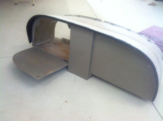

Graham,
Do you mean like this? Photo is of my instrument panel ready for installations. Both sides are hinged, with 2 Camloc fasteners for each side; both are hinged, with one shown closed and the other open. Opening one takes 10 seconds.
Jerry Fisher
[img]cid:031550D7-CB78-455D-AA23-9B76EA61CE70(at)hsd1.ma.comcast.net.[/img]
On Sep 17, 2013, at 5:00 AM, GRAHAM SINGLETON wrote:
Tony
excellent idea to think about this. I've been working on an old Classic and several times wanted to check things
behind the panel. Accessibility on a standard plans built Europa is a long way from being good. Factory was so
stressed at design time that they laft all that to we builders and there were a few good ideas tried.
One I haven't seen is a hinge at the bootom of the panel.
Most important is to keep it light, early panel installations with a lot of steam age stuff in them weighed anything
up to 40lbs!
Digital stuff has made it a lot easier and engine management systems ease the workload of single crew VFR.
Graham
