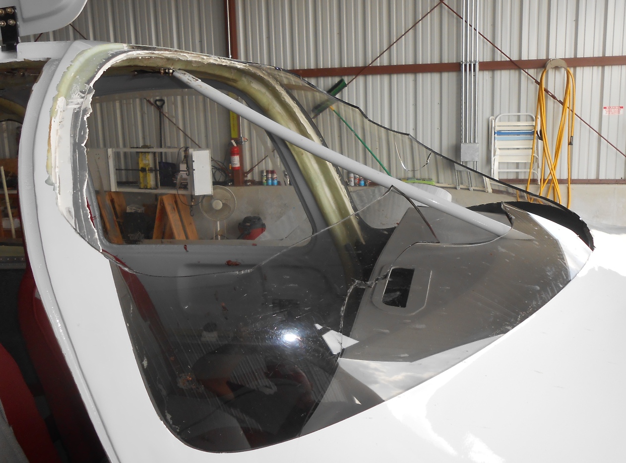

N312F had an encounter with a vulture today.  The pilot flew some 30 miles back to Lexington Airport and landed safely.   Only one person on board.  The bird did not survive the encounter with either the windshield or the rear bulkhead.  The pilot had minor injuries but was able return and land safely.
The entire front windshield is shattered.  The bird went down the top center of the cabin and impacted the top rear baggage bulkhead at a high rate of speed.
N312F is down for repairs.

I am glad pilot and plane made it back safely. It looks like it took out left door strut too...right above pilot's head. Wow! Was pilot wearing glasses? What airspeed and altitude?

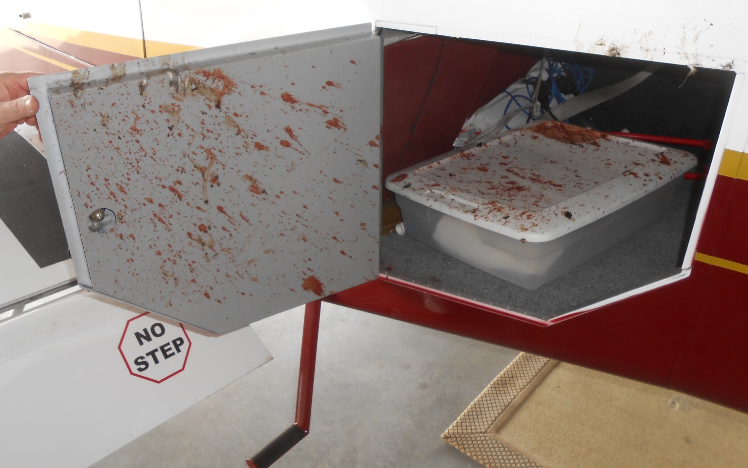

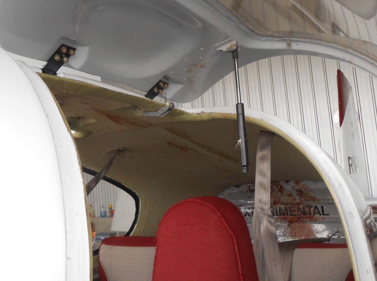

Quick update,
I was not flying the airplane.  We have several people who regularly fly the airplane.
This was a VFR afternoon flight with only the pilot on board.  I did get a chance to talk to him late yesterday, after spending some time
taking off the rear bulkhead covers for cleaning and inspection.  The bird was a Turkey Vulture.  Its a large bird.  He spotted the bird and
tried to avoid it but with no success.  He was close to 150Kts at 3000 (2000 AGL) and some 60 miles south of KLEX airport (Home Base)
The impact with the bird / windshield broke his glasses and headset as well.  I believe the rear door strut breakage was caused by the pilots head.
The bird appeared to have traveled down along the center of the cabin top inside the cabin just right of the center support and impacted the rear
baggage bulkhead.  Pieces of the windshield were found in seats and floor areas including the baggage area.  Pieces range from 2" up to 6".
All were very sharp. There is no evidence of any impact forward of the windshield or with any other parts of the aircraft.
The pilot engaged the AP at that point and realized his headset was broken and managed to retrieve a second headset from one of the rear seats.
One of the lenses from his glasses were in the floor of the co-pilot side of the aircraft.  At that point he declared an emergency and proceeded
back to Lexington at a reduced speed (Approx 100Kts).  He requested medical support which arrived as he taxiing off the runway.  The FBO at
Lexington towed the airplane back to our hanger.  By the time I arrived, the airplane was sitting in the hanger and pilot was at the emergency
room waiting for stitches.  The pilot said the aircraft flew fine but was a bit more noisy and windy than usual.
Coming back to a towered airport with ATC actually was a good thing at this point.  They were waiting and assisted his exit from the aircraft
The pilot did have injuries but is expected to have a full recovery.  The airplane will need repairs.
Two things to be noted from all this:
(1) - AVOID Birds!  They are the equivalent of rocks in the sky.
(2) - Fly the airplane!  The pilot did a great job of flying the airplane and using the AP in the emergency.
The bird did not survive the incident.  I am still trying to get pics from the airport operations folks.  They took the bird from the airplane.
Jim Combs - N312F - 500+ hours
On Sun, Sep 29, 2013 at 1:50 PM, Karol Hansen <karolamy(at)roadrunner.com (karolamy(at)roadrunner.com)> wrote:
[quote]--> RV10-List message posted by: Karol Hansen <karolamy(at)roadrunner.com (karolamy(at)roadrunner.com)>
Wow, BIG BIRD! How about, "an almost frozen turkey"! Compliments to the pilot, if that was you, Jim, for maintaining composure and getting her down safely. I feel for you having to do another windshield and paint.
Man, that thing even bent the center post. Did the pilot get his/her headset and glasses knocked off too? Hopefully not too many war wounds for the pilot???
Rich Hansen
