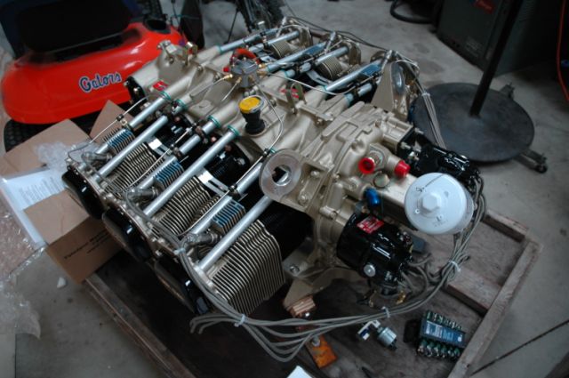

Heads up! There is a physical incompatibility between the B&C SD-20 auxiliary alternator (mounts on vacuum pump pad) and the oil filter adapters that puts the filter in the 10 o’clock position. If your electrical system is depending on the SD-20 you will be precluded from using the angled oil filter adapter. After discussion with B&C I investigated the possibility of moving the SD-20 to the hydraulic pump pad but total length of the alternator + hydraulic pump adapter precludes the SD-20 from being mounted there.
Also, if you go with one of the angled oil filter adapters (at least the one from B&C) you need the 1.4” spacer to clear the engine mount cross member.

Bob, are you saying that B&C’s own oil filter adaptor won’t work on an IO-540 with the SD-20?

Why don't you just use a remote mounting for the filter?
All you'd need is an Engine-Adapterplate, two short hoses and a Filter Mount.
AND you can mount the filter right side up for less oil mess when changing it.

The Mattituck engine came with the angled adapter. That will be VERY NICE for changing oil. It is in the 2-o’clock position when looking at the engine from the front. Is this the same one you are talking about? I wasn’t planning on the aux alternator anyway, but that’s good to know.

That is correct! Specific problem is caused by the spacer. The bosses on the alternator overlap into the space where the spacer wants to be. Explanation from B&C (Tim) was “that’s a combination that we didn’t anticipate”. Apparently somebody else has also talked with them about that problem within the last couple of weeks. His only suggestion was to try it on the hydraulic pump pad. I looked into that but the total length is an issue. I suppose you could get around that by modifying the firewall but it’s not worth it to me - I’ll just go with the normal oil filter adapter and the SD-20 on the vacuum pad.

Adapter is similar to B&C’s – they both have a spacer to clear the engine mount and that’s what specifically causes the issue.

I may go that route but at the moment have the original filter adapter back on.

Yes, Ed called me last week telling me of the exact same
situation he has with his system. SD-20 + Angled adapter = no-go.

Anyway to machine a little bit off the adaptor to make it work?

I don't think so - that spacer is really a collection of hollow chambers
with relatively thin walls. On the alternator, it's the bosses for the
screws that connect the front and rear sections together that cause the
issue.

Hmm. I'd have to go take a look, but any chance the B&C adaptor
#BC708-1 would work? It puts the filter in the 6:30 (down) position,
instead of 11:00 (up) position. Would the spacer still be required?

I would think it would work fine with no spacer. Reason the spacer is
required is because with the 11:00 (up) version the top of the filter is
above the diagonal cross member on the engine mount by about an inch or
so. The 1.4" spacer is the minimum that it takes to get the filter aft
far enough to clear the engine mount. I may give them a call and see if
they'd be willing to swap - interesting that the listed price is $55
different between them...

I just got off the phone with Bill at B&C - they have a solution. I
will provide specifics when I confirm it will work.

Is yours supposed to be in this position? Where is the alternator supposed to go?

Yes, that’s the position. Alternator is a 20 amp auxiliary unit (http://www.bandc.biz/sd20desc.html) that goes on the vacuum pad (all electric plane). Interference is between the corner of the filter adapter/spacer closest to the vacuum pad and one of the case screw bosses on the alternator. The folks at B&C have a “clocking adapter” that they believe solves the interference problem by rotating the alternator 45 degrees and moving it aft by 5/8”. They are also looking at changing one bolt for a cap head screw on the oil filter adapter. They are going to try the combo tomorrow and if all goes well will let me know.
Another builder (Ed in Oregon) also reported this to them about 2 weeks ago. Apparently B&C understood that he was using a 2.5” spacer instead of the 1.4” and based on that it was proclaimed a “no go” by B&C. Based on updated info on the size of the spacer they are certain that it will be a simple fix. Standby for confirmation of the simplicity…

jesse(at)itecusa.org Guest
Posted: Fri Jun 16, 2006 8:25 am Post subject: Oil Filter Adapter Incompatibility |
I think mine has the 2.5” extension. Based on your calculations, will that be a clearance issue with the firewall or engine mount?
Do not archive.
Jesse Saint
I-TEC, Inc.
www.itecusa.org
W: 352-465-4545
C: 352-427-0285
From: owner-rv10-list-server(at)matronics.com [mailto:owner-rv10-list-server(at)matronics.com] On Behalf Of Condrey, Bob (US SSA)
Sent: Friday, June 16, 2006 10:20 AM
Subject: RE: Oil Filter Adapter Incompatibility
Jesse,
Bob
From: owner-rv10-list-server(at)matronics.com [mailto:owner-rv10-list-server(at)matronics.com] On Behalf Of Jesse Saint
Sent: Thursday, June 15, 2006 11:03 PM
Do not archive.

bcondrey
Joined: 03 Apr 2006 Posts: 580
Posted: Fri Jun 16, 2006 9:06 am Post subject: Oil Filter Adapter Incompatibility |
Jesse,
Based on actual installation (not calculations) the 1.4” spacer is the minimum needed to clear the diagonal cross member on the engine mount. I’ll take a look tonight and let you know if another inch will cause problems.
Bob
Posted: Fri Jun 16, 2006 10:26 am Post subject: Oil Filter Adapter Incompatibility |
The horizontal one gets very tight with the firewall. In fact, without that box, I think it would not even fit, and certainly not be removeable, which would kind of defeat the purpose. The angled one will be much easier to change, and from my research it sounds like punching a hole in the filter, especially the angled one, will allow air in and allow the oil in the filter to run out before removing it. There will still be some left, but not as much as with the horizontal one. Remote would be nice, but that adds more complexity as well.
As far as reports on how it works, we hopefully will have some in about a month. If we aren’t doing an oil change by then, we will be way behind schedule (knock on wood).
Do not archive.
