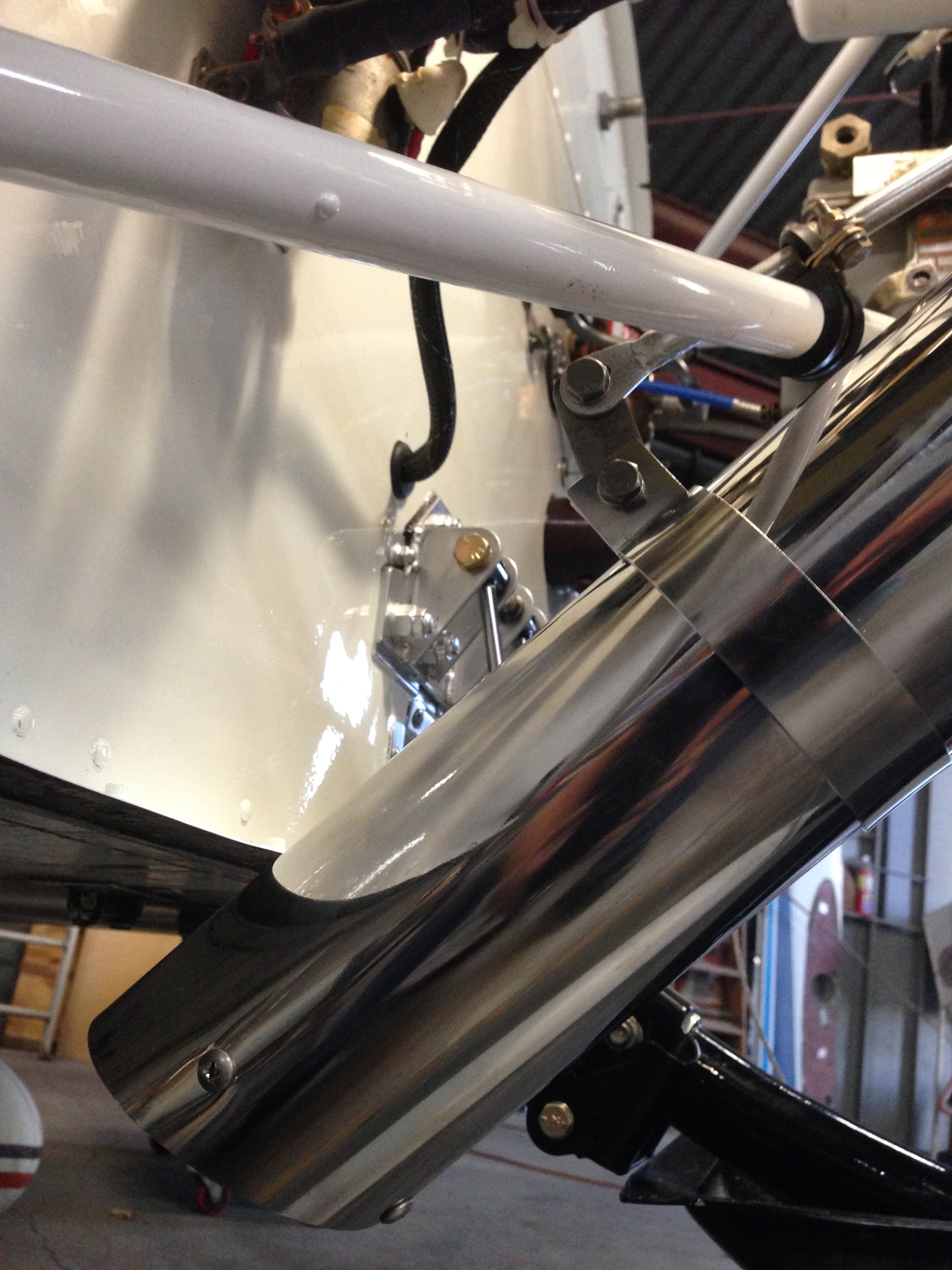

Haven't posted many pics on here because it's just too much work. If you want to see the whole project, "LIKE" the AuCountry Facebook page.
First pic is how I hang the Power Flow. I started this about a year ago and I've converted 6 planes to this mount. It stops the beating of the muffler against the exit ramp without breaking the thin brace from the engine mount to the support strut.

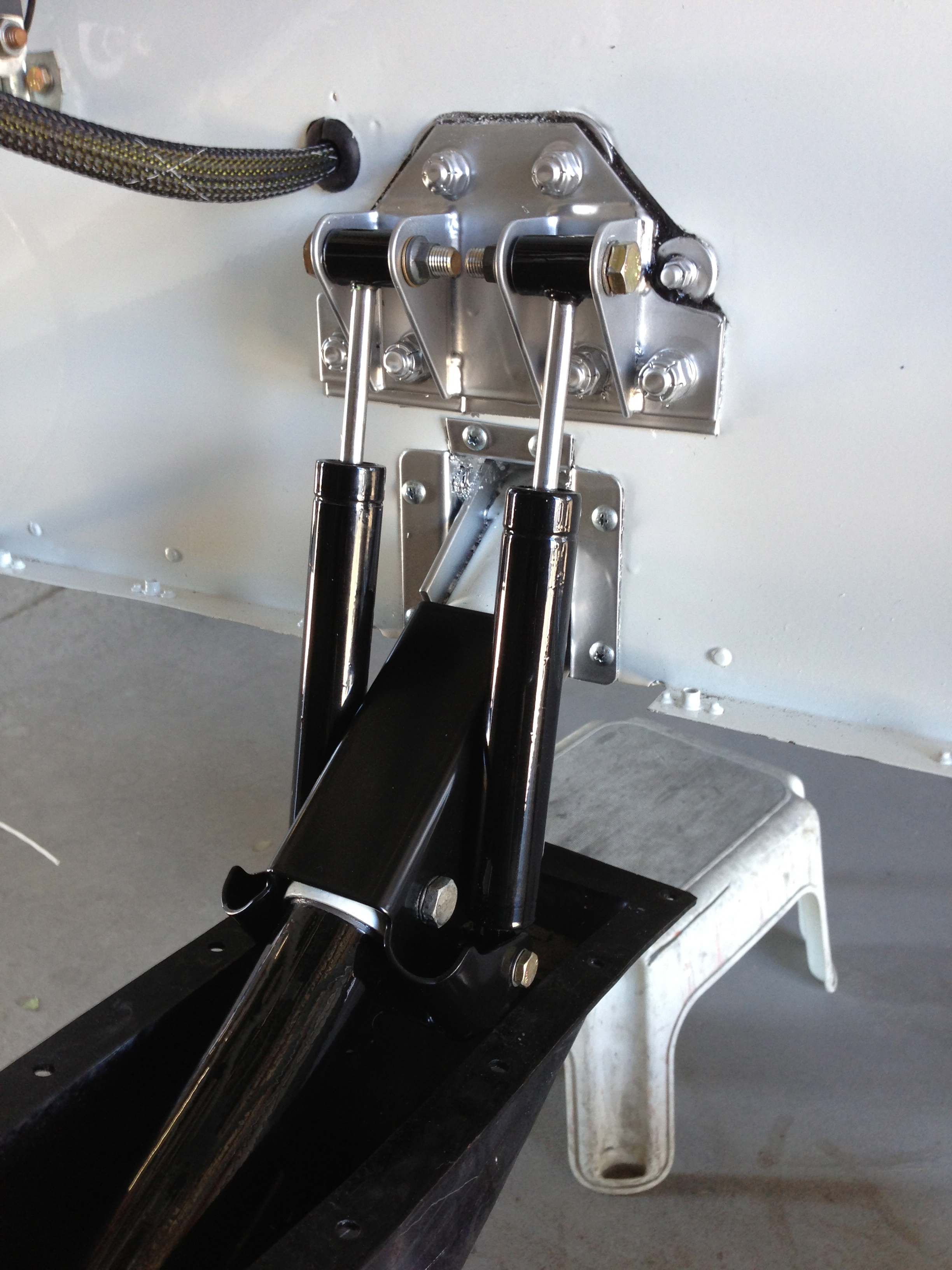

Second pic is the shocks all detailed. They are painted with Black Imron.

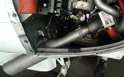

Power Flow should give options for mounts. The way they mount on a Mooney might work on a Tiger.

Ned:
Is that a standard system for a Mooney or was it modified?
The weld looks different.
Barry

PostPosted: Tue Oct 15, 2013 10:19 am    Post subject: Cheetah to Tiger conversion Reply with quote
Barry,
I just pulled the photo from Power Flow's website. It's from their product page for O-360 M20
http://www.powerflowsystems.com/products.php?cat_id=5&pid=26
So I assume its a standard part of their kit
Ned

PostPosted: Wed Oct 16, 2013 7:59 am    Post subject: Cheetah to Tiger conversion Reply with quote
I designed a hanger like one from a Cessna that was similar. I sent it to Darrin and said we needed something like that. He said I could make my own stc.
now mount them as shown in the pic
