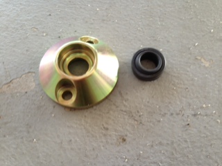

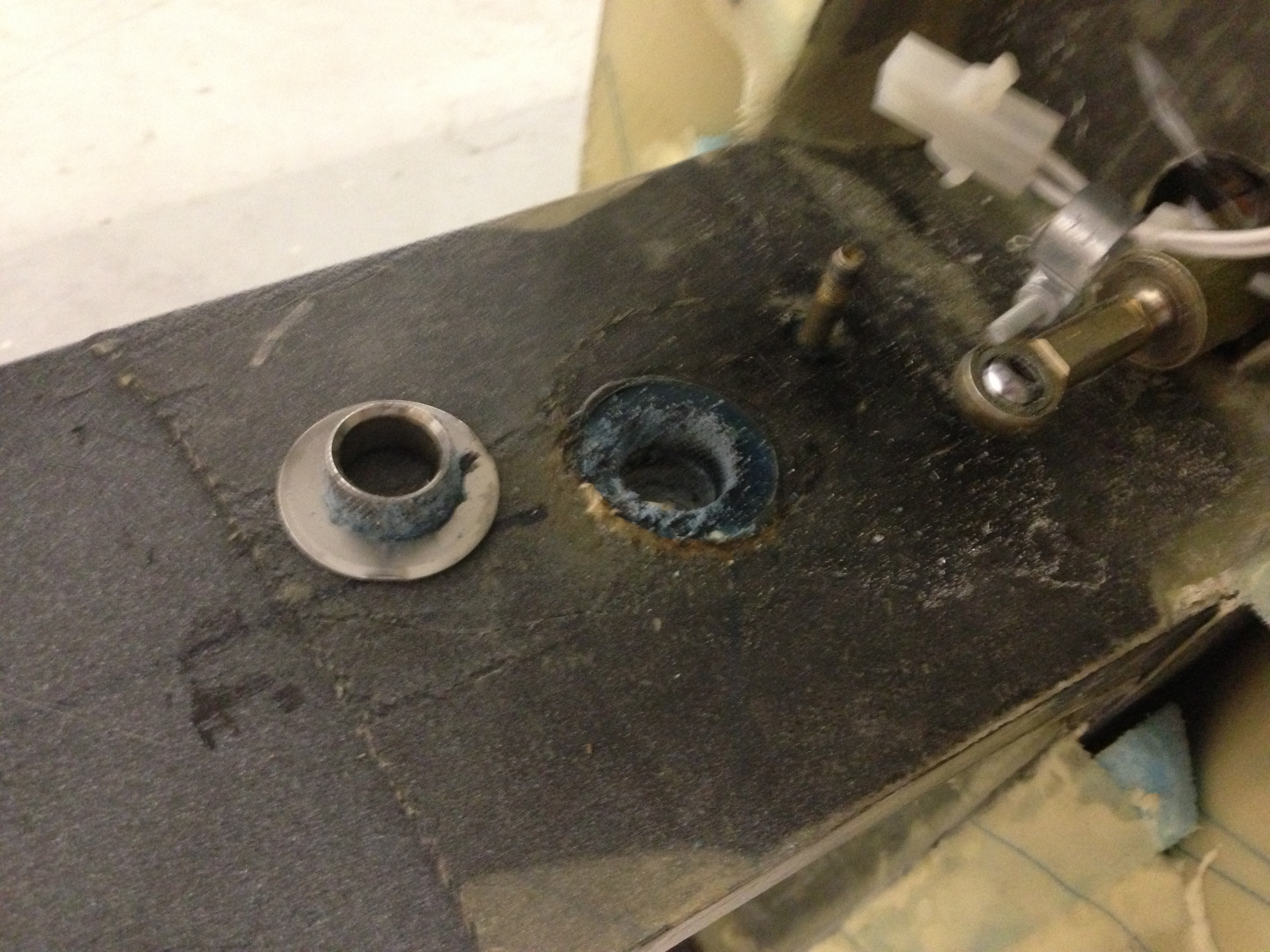

Well..... I didn't notice the two little boxes with bearings that must be pressed into the sockets. That is the difference, because with those in there, the fit to the pin is very good. That issue is solved.
I'll just say this for the record. The aviation business has always amazed me. When a company makes a mistake in design, the customer ends up paying the price to resolve the issue. It almost makes you wonder if companies will make mistakes on purpose so they can make money on the users fixing their design screw ups. I know the Europa is a good airplane and I am sure they did not do this on purpose, but I just shelled out a huge amount of money for what is essentially very little hardware to fix a design problem they created. To make matters worse, if this doesn't go right, I could end up destroying my airplane.
The airplane is great to fly. It is extremely fuel efficient. With the 914 engine, it climbs like a U2 and goes as high as I want to go. If you lose and engine, all you think about is what caused it and not the urgency of landing in a field. It is the first general aviation airplane I have flown that I need to pay attention to how high I am going, because even in cruise climb of about 95 knots, it climbs about 800fpm all the way to 18,000 feet. Now if I can just make the wing strong enough to keep me from worrying about it breaking!
I attempted to attach a picture of the forward socket with the little bearing next to it.
I'll post updates as the mod goes forward. My plan is to start it on Monday.
The spar is the wing, therefor it is extremely important to get this right. The rest is fluff.
Dave
A227
914 Motorglider 500TT

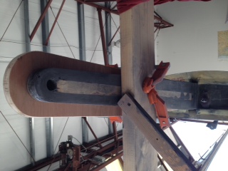

Thanks Nev! I am copying your notes and taking them to the hangar. I am getting a bit lost in the terms "tows". "rovings". I'm a bit confused about the packing of the carbon fibre in the mold. Does it wedge into the narrow end and stop, or does it loop and come back out? I am guessing it wedges in, but I am not sure what the significance of the 17 foot length is. It would be great if Europa had a video of the installation of the carbon into the mold.
I am committed to the project now. I've been thinking for month about how hard it would be to remove the bushings from the spar tang. It went very well with heat and it looks like I will be actually grinding tomorrow or the next day on the first victim. I bought a 6 inch pneumatic grinder and hope that will work, but I might be able to fit a 4 inch head on it if necessary.
I did a test fit of the intensifier board and it looks like I have plenty of clearance from the tank and the items below.
Is it necessary to remove the fibre glass layers from the root rib, or could I sand and glass over them - making it thicker and heavier, but avoids grinding at the root rib - along with the glass used to secure the wing root fairing.
Thanks! Dave

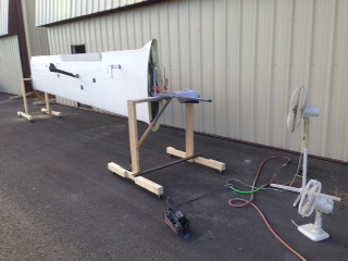

Update on Mod 78.
Taking my time and being careful makes this go smoothly so far. I did not intend to grind today, but ended up completing about 1/8th of the dirty stinkings job. So far, so good.
Dave
Setup to grind spar tang
 Filesize:  34.86 KB
 Viewed:  19450 Time(s)

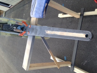

Thanks Nev. I have ground one spar tang today. Had to quit due to roasting in the sun and just the mess of it. I'm wondering if anyone has done this mod on a flying airplane. The reason I ask is that the speed brake control tufnol block is right there where the fiberglass is layed up against the root rib. To grind those payers off the root rib, I would ahve to remove the controls for the speed brakes and also the ailerons. What I was hoping to do is leave the fiberglass on the spar out about 2 to 3 inches and then add the new layers as called for in the build manual, but only run them up the root rib where possible. Otherwise, the new plies would essentially splice onto the existing pile on the root rib. Where I can run them up the root rib, it would be thicker than called for in the manual. There is also the issue of the glass that is holding on the wing root fairing, which is why I'm asking about not taking off the layers that are now on the root rib.
I'm still getting lost in the terminology - roves - tows, etc. Is there a source on the internet that defines what these terms mean?
I'm attaching a photo of it now, with the intensifier board on top for scale.
Oh - How far does the carbon fibre cloth go toward the rot rib? ALl the way to the 90 degree corner?
Off to shower off the dust - you are right - it goes everywhere. I am wearing a space suit and I still get it on me.
Dave
PS On one spar, There was a spot of somthing that looks almost like sap in a spot when I was grinding the shear web layers - toward the wing root. Like a pocket of sap or a pocket of something that was not cured. This is about a 12 year old spar.
Dave

Graham,
The idea would be to have the same plies of fiberglass on the spar, but use the existing plies that are on the root rib, buried behind the wing root fairing and control hardware. I would have about a tapered overlap in the corner between the spar tang and the root rib. That is my thought anyway. The only way to get the plies on the root rib off would be to create a huge amount of work over what is already required.
The instructions for the mod seem to be for a wing that has not yet been installed. I hope that I can bond the old plies with new ones and accomplish the same thing as disassembling the entire wing!
Dave

Dave,
Wow - we were just feeling sorry for ourselves because we have to deal with changes needed on the fuselage. Working with the fairings & controls already on would be really difficult. Nev's tips are really helpful.
One thing we did, that wasn't in the instructions, was to make a template for the location of the hole that holds the aileron quick disconnect bracket in the spar. We were worried that once the bid was on, we'd never find the right spot again Wink
Jim & Heather
