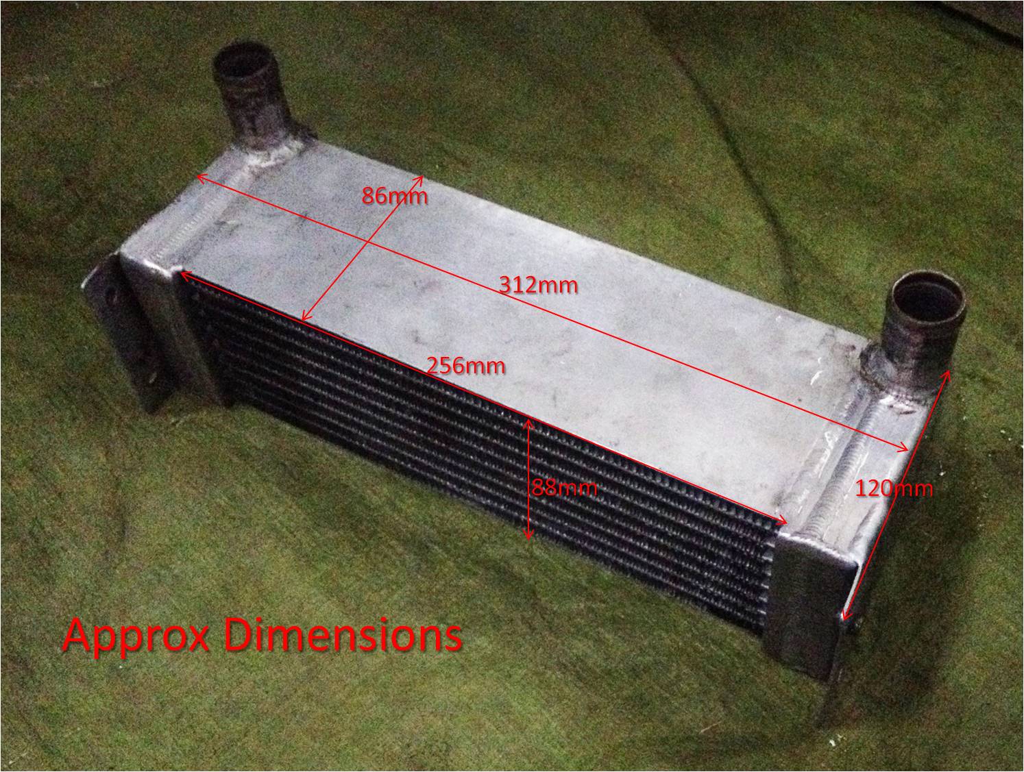

The coolant radiator in G-CHOX (XS Rotax 912ULS) is leaking. We need to replace it asap. Europa O4 are out of stock.
Does anyone know of any other source?
Goff Moore
The leaking radiator
 Filesize:  289.19 KB
 Viewed:  15188 Time(s)

PostPosted: Wed Oct 23, 2013 5:36 am    Post subject: Coolant Radiator Reply with quote
Goff,
Mine is a Rotax UL but I had the same problem last April and Europa factory could not help.  It is actually a motor cycle radiator and my engineer contacted the original manufacturers (who had previously supplied Europa).  I know they provided an excellent service very quickly, they did not replace the radiator but repaired it and gave it a full renovation job for about a third of the cost Europa would have charged for a new one.  It came back looking like new and in perfect condition.
I have spoken to my engineer and inspector, Gary Johnson, he recalls (from memory) it was a company in Saffron Walden, but will check out the name and contact details tonight and send them to you.  He can be contacted on <thehighflyer(at)aol.com (thehighflyer(at)aol.com)> .
I have just searched on Google and found a firm of motor cycle repairers and restorers in Saffron Walden called Motorcycle Restoration Company (next to Audley End Station), Unit 3, Wenden Court, Station Road, Wendens Ambro, Saffron Walden, Essex, CB11 4LB, tel. 01799 542323/07734 591456, www.motorcyclerestorationcompany.com.  There is also another motorcycle shop in Saffron Walden, Bert's Motorcycles, 13b Debden Road, Saffron Walden, Essex, CB11 4AA, Tel. 01799 525611.  I have no idea whether it was either of them or neither, but worth a phone call. Otherwise contact Gary tonight or he will contact you.

PostPosted: Wed Oct 23, 2013 5:55 am    Post subject: Coolant Radiator Reply with quote
Try Neville Eyre he may be able to help
He had one made for me last year

PostPosted: Wed Oct 23, 2013 6:04 am    Post subject: Coolant Radiator Reply with quote
Try Richard at
http://www.eesaviation.com/ Has had radiators repaired, and if really bad re-cored , his contact details are
01858 880807 His hanger / workshop is at Coventry Gliding club ...Hanger 3 , LE17 6JJ,

PostPosted: Thu Oct 24, 2013 1:55 am    Post subject: Coolant Radiator Reply with quote
-----BEGIN PGP SIGNED MESSAGE-----
Hash: SHA1
Take a look at www.aluminiumradiators.com
They produce the Rotax radiators. The quality is high, support is
excellent and the prices are very reasonable.
They are also quite easy at building radiators at custom spec. I had
my special radiator made there too.
If you replace the standard SX-radiator, you might consider to make it
"thinner" (less "depth"). Although this sounds contradictionary, this
improves the airflow through the radiator and enhances cooling. The
standard radiator is way too thick.
Think about it this way: the air flowing through the radiator is
picking up heat. When it arrives at the rear half of the radiator, the
air has been warmed up during its journey through the front half, and
is unable to offer much further cooling.
The math says that if you double the depth of the radiator with 100%,
it only offers 25% more cooling. However the airflow reduces due to
internal friction, so at some point a thicker radiator will even offer
less cooling than a thinner one. The Europa-XS radiator is way past
the top of that curve, especially at lower airspeeds (like on the ground).
You won't find such a thick radiator in other modern airplanes. Yes,
the P51 had a thick radiator, but it was flying with quite a different
speed than your Europa.
In my airplane I have a thin radiator, and it was only when I took out
the large bulky radiator that all my cooling issues disappeared.
So, if you have to swap your radiator anyway, it might well worth it
to allow for a little improvement.
Frans

Philip, Gary, Mike, Kevin, Bob & Frans,
Thanks so much for your replies, so many good sources out there. I've learned a lot.
Based on Philip & Gary's recommendation we shipped our radiator for repair today to http://www.gmxradiators.co.uk/
This is probably the cheapest and easiest option for us at the moment, but I love Frans' idea of a thinner rad. For five years we've had to manage coolant temperatures rather than forget about them. We'll certainly look into this.
Goff

PostPosted: Thu Oct 24, 2013 8:34 am    Post subject: Coolant Radiator Reply with quote
Philip,
I'm afraid I have to tell you, you are talking out of your southern hemisphere !
The XS radiator was made specifically for Europa, by a well established Motorsport supplier, never was from a motorcycle, and not from anyone in Saffron Walden, or in fact anywhere in Essex. I know who and where, 'aint in Essex !
The company who make these for Europa have a very long lead time, I understand a new batch is due to arrive at Europa some time very soon. Having one custom made will cost more than having a stock one from Europa.
Having said that, I would look at having the original one repaired, any good alloy welder could do it easily. Do a pressure test, in a bucket of water to be sure all is well before refitting.

PostPosted: Thu Oct 24, 2013 8:46 am    Post subject: Coolant Radiator Reply with quote
Hi
Had mine repaired and pressure tested for $50 by local radiator shop. Failing that I have a second hand one that I probably won't use if you want to buy it.
