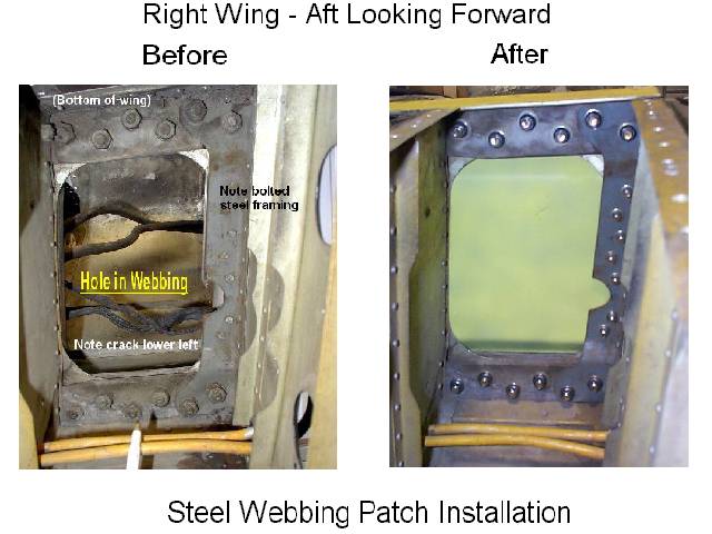

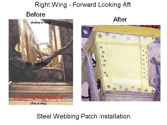

Subject: CJ6 Mysterious Wing Mods. Repaired Description: The forward spar webbing in both wings has been repaired by bolting and riveting 4130 steel patches over the holes that had been cut in the webbing in China. The pictures show before and after shots looking forward and aft in the right wing.
