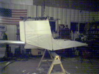

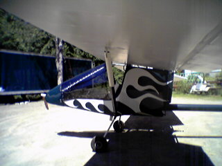

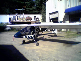

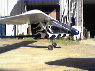

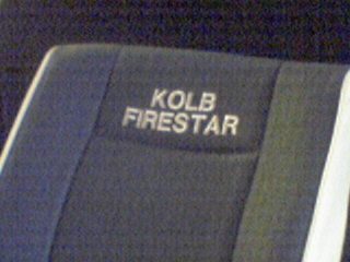

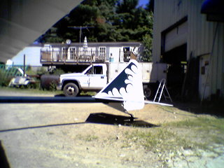

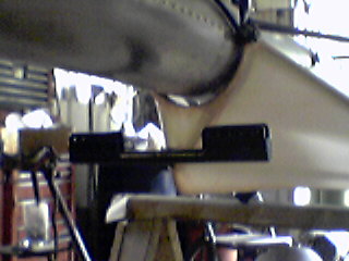

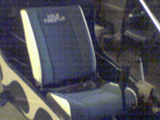

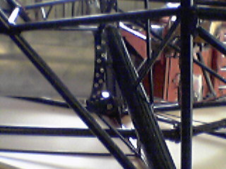

aleron_con.jpg I redesigned the aileron control like the New Kolbs angle_gear.jpg I replaced the gear Leg sockets to 1 1/4" and moved the top of the gear Leg sockets two inches aft to move main gear ahead covered.jpg Full enclosed the back of cage with sharp trailing edge to reduce drag full_view.jpg Waiting for wheels Brakes and a Prop. kolbseat1.jpg Built a adjustable custom seat kolbseat2.jpg Had it ulpostered with Memory foam inside left_side.jpg Left side View right_side.jpg Right side View tail_view.jpg Tail View
