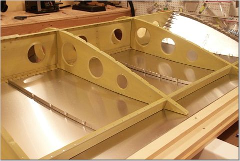

Subject: 701 False Ribs Description: To keep the skin from oil canning between ribs 4&5, 5&6 I added these to the top rear and bottom rear skins. Used crimp pattern from rib itself and used same rivet layout as rib (pitch=50). They do work very well. They do not touch the spar or rear channel.
False_Ribs.jpg False Ribs
