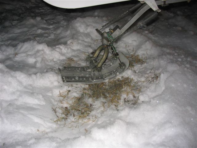

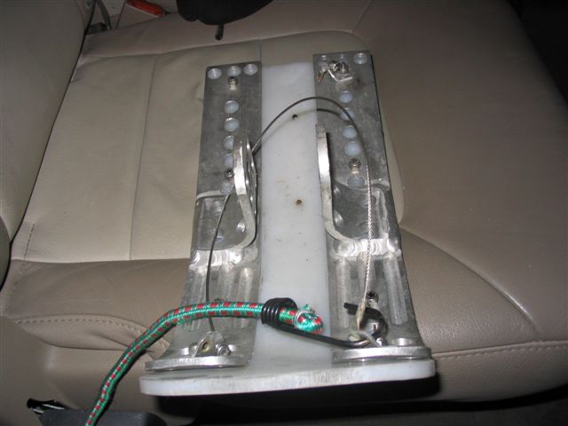

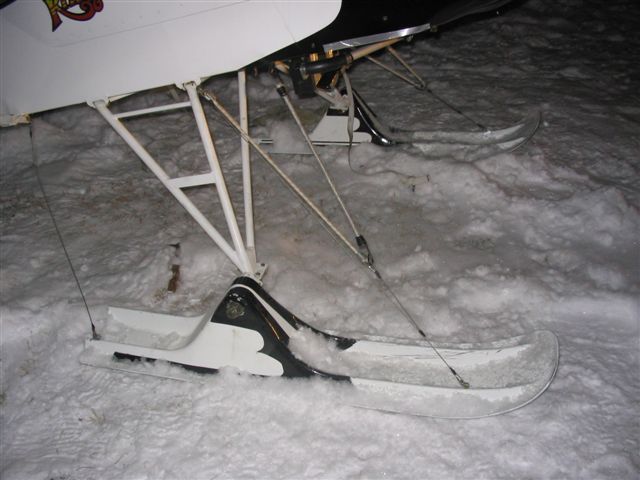

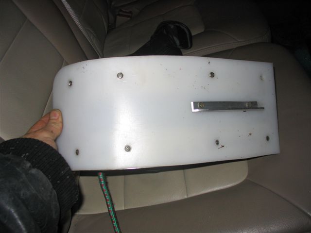

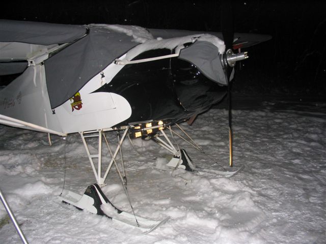

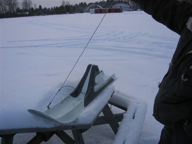

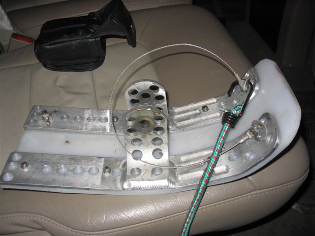

Subject: Ski setup for Kitfox Lite2 Description: Ski setup for Kitfox Lite2 / Model 4 using Skystar Fibreglass main skis and home made Tail ski.
C-GVW_Skis_002.jpg Short Cable attaches to twin bungees - long cable attaches to plane C-GVW_Skis_003.jpg Tail Ski manufactured from 1/4" Aluminum and plastic C-GVW_Skis_004.jpg Tail Ski C-GVW_Skis_005.jpg Bottom of tail ski with 1/8" Aluminum angle runner C-GVW_Skis_006.jpg Twin bungee set up and safety cable C-GVW_Skis_007.jpg Tail ski mounted to existing wheel mount C-GVW_Skis_008.jpg Completed set up
