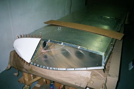

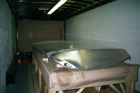

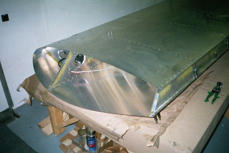

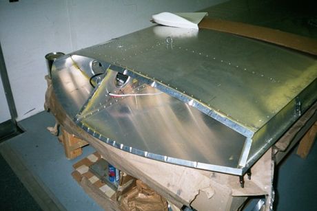

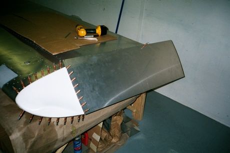

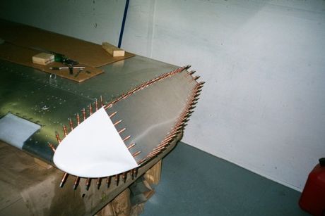

017.jpg The wing trimmed for the 45° Horner wingtip. The extra nose rib to support the landing light cutout is visible. 019.jpg The angles are installed. 020.jpg The fiberglass is clecoed in place. 021.jpg The aluminum panel is pre-installed before trimming to mark the trim line. 022.jpg After trimming and clecoing. 024.jpg Completed.
