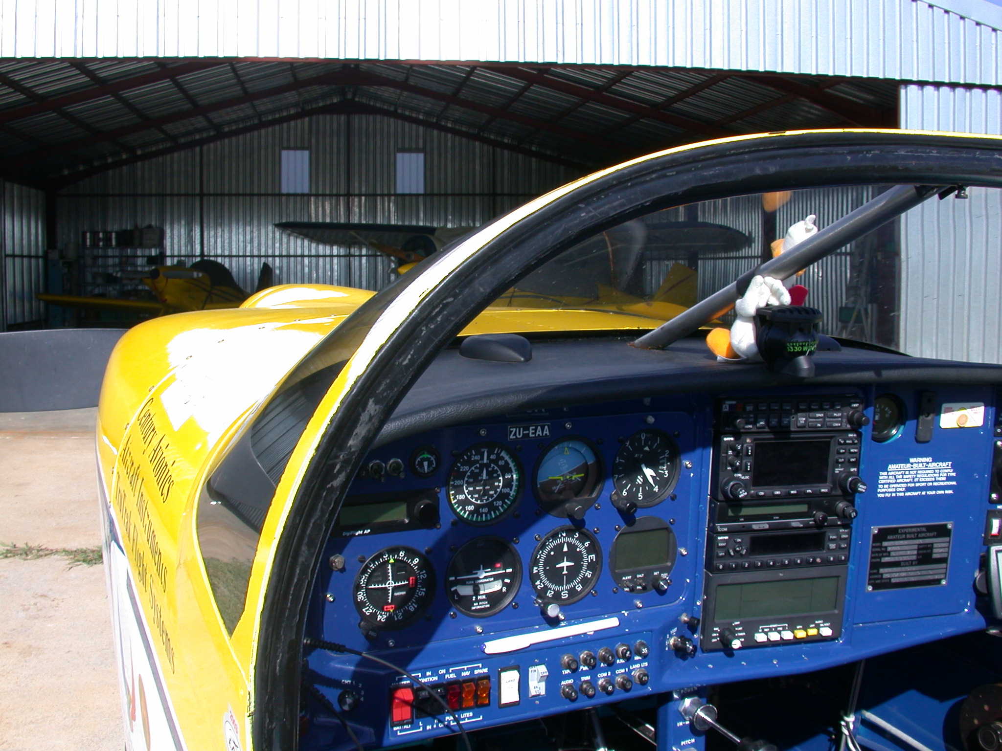

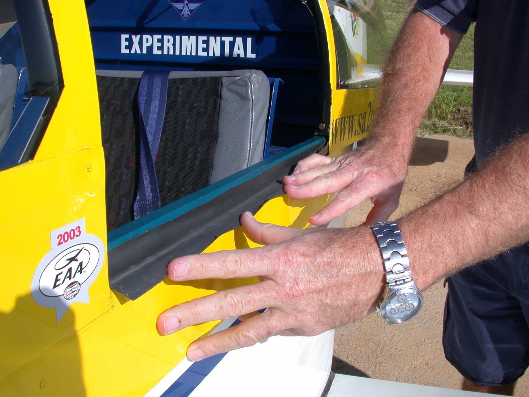

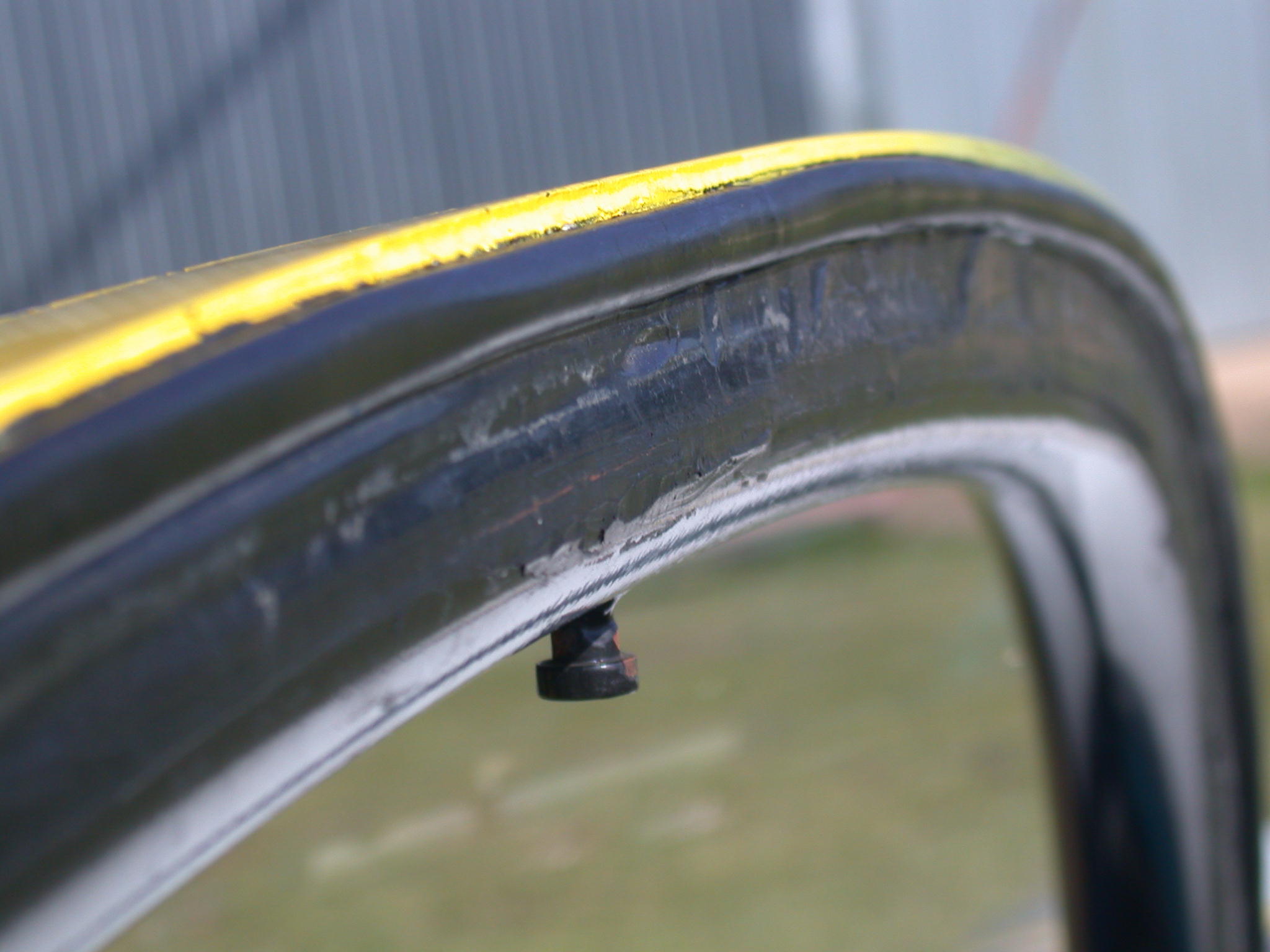

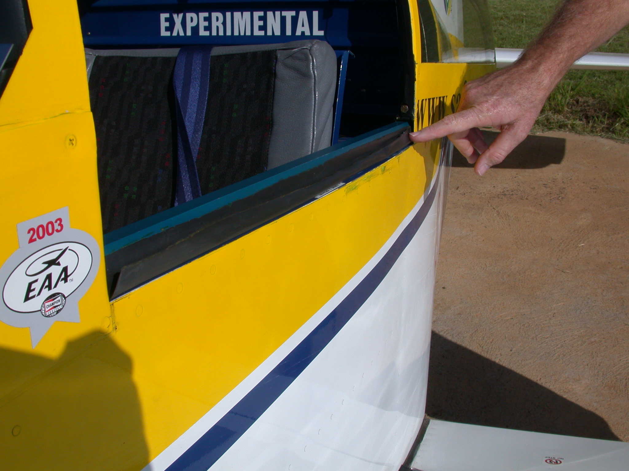

Roll_bar_+_seal_01.jpg Roll bar with tubular seal that the canopy butts against. Roll_bar_+_seal_02.jpg Roll bar with tubular seal. Shrink_sleeve_LHS_01.jpg Shrink sleeve seal between the lower edge of the canopy and the canopy rail. Shrink_sleeve_LHS_02.jpg Shrink sleeve.
