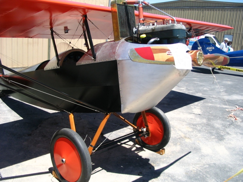

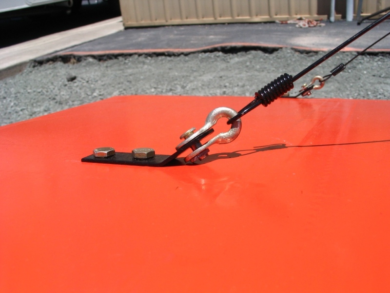

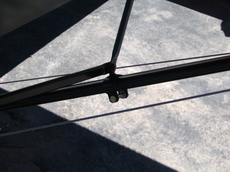

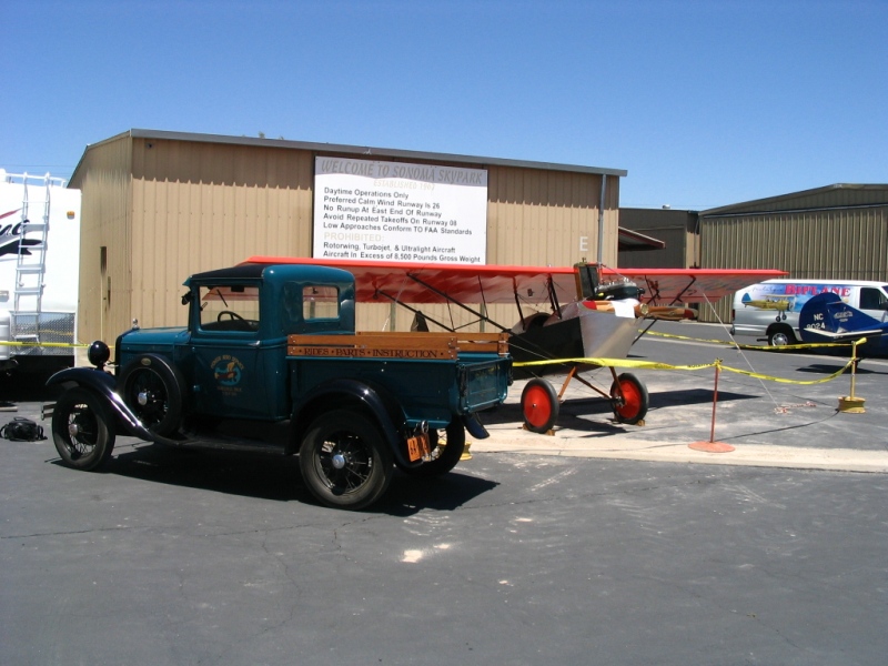

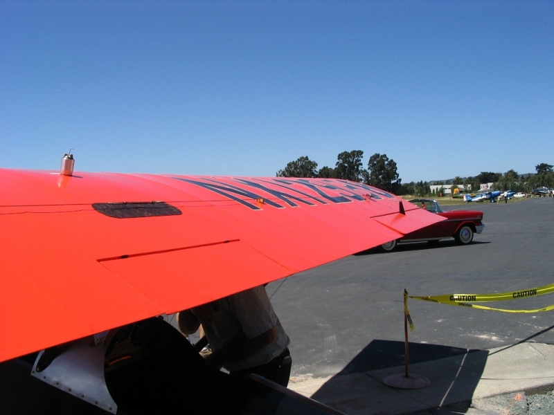

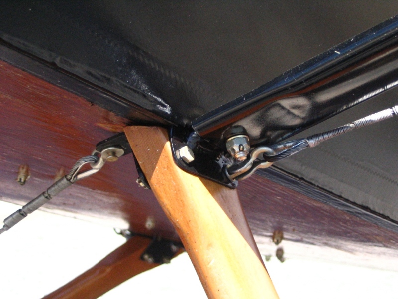

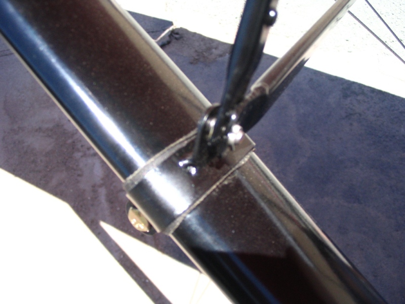

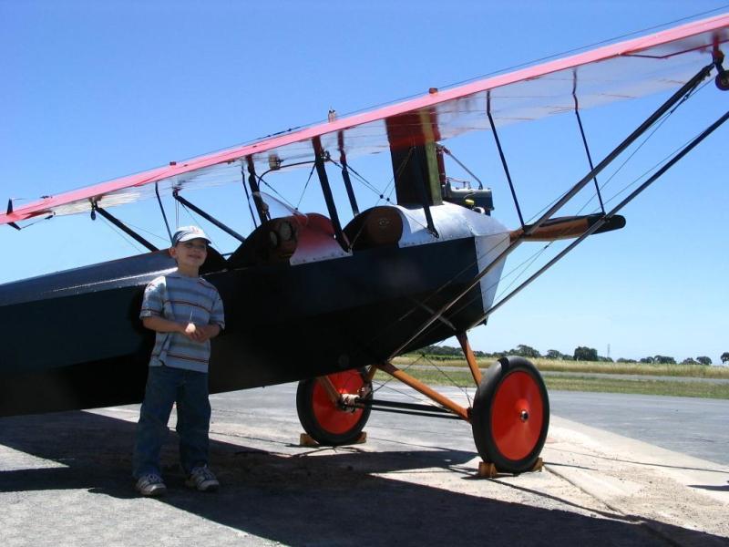

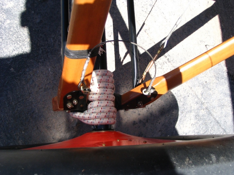

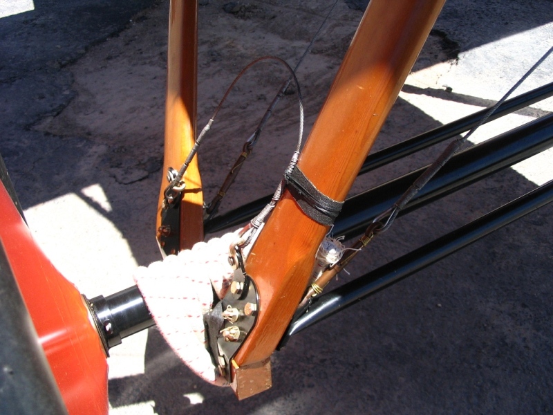

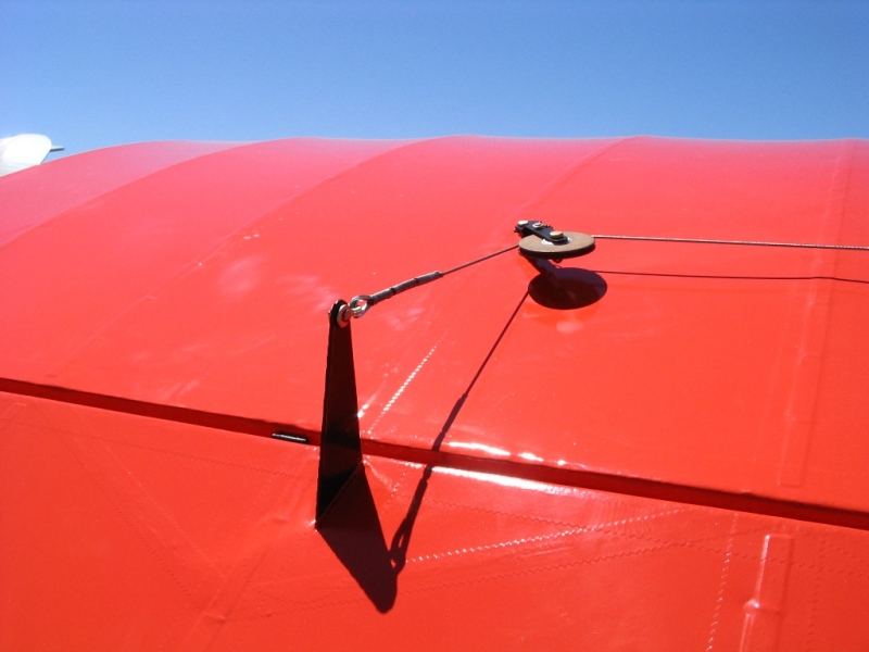

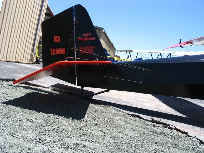

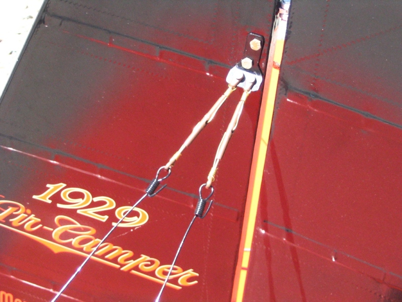

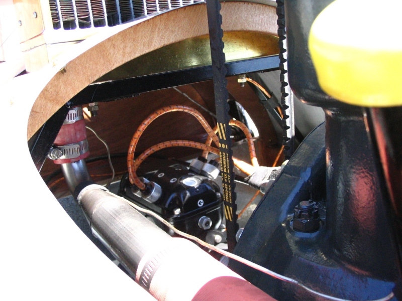

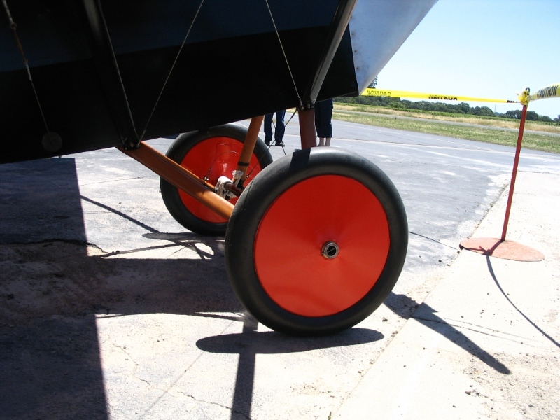

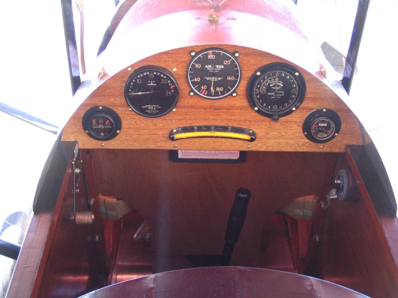

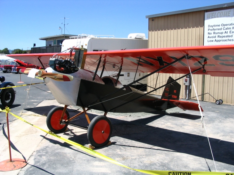

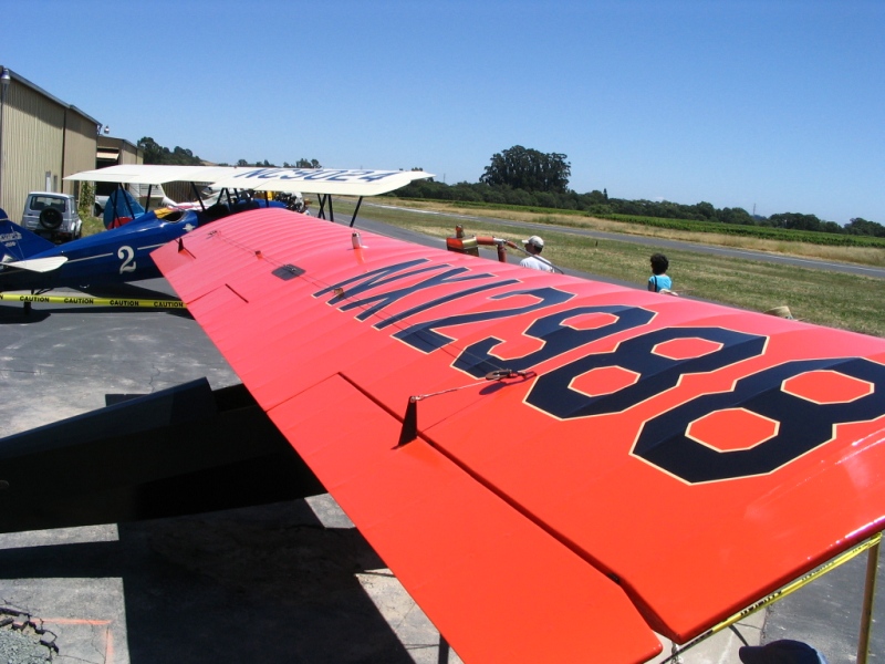

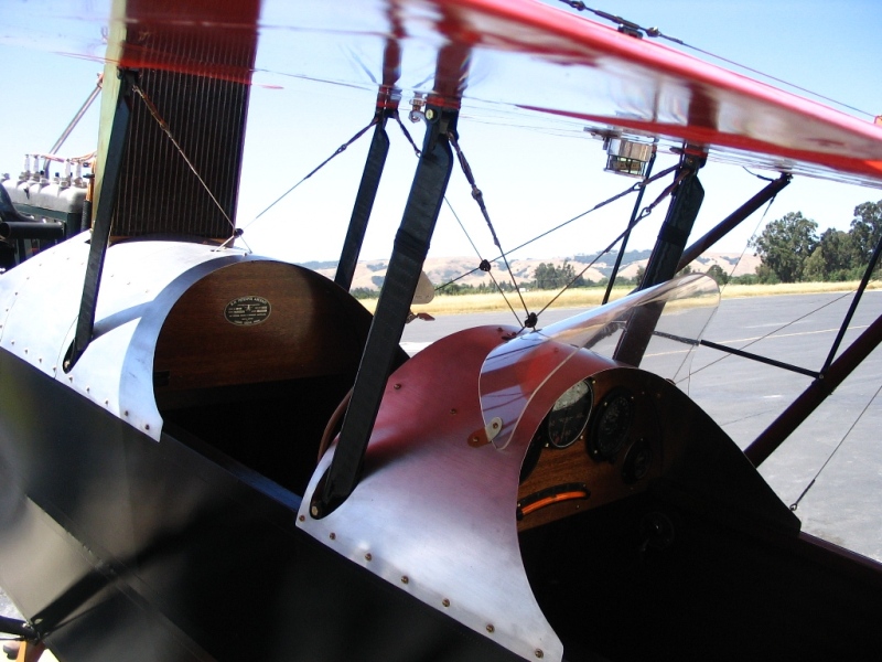

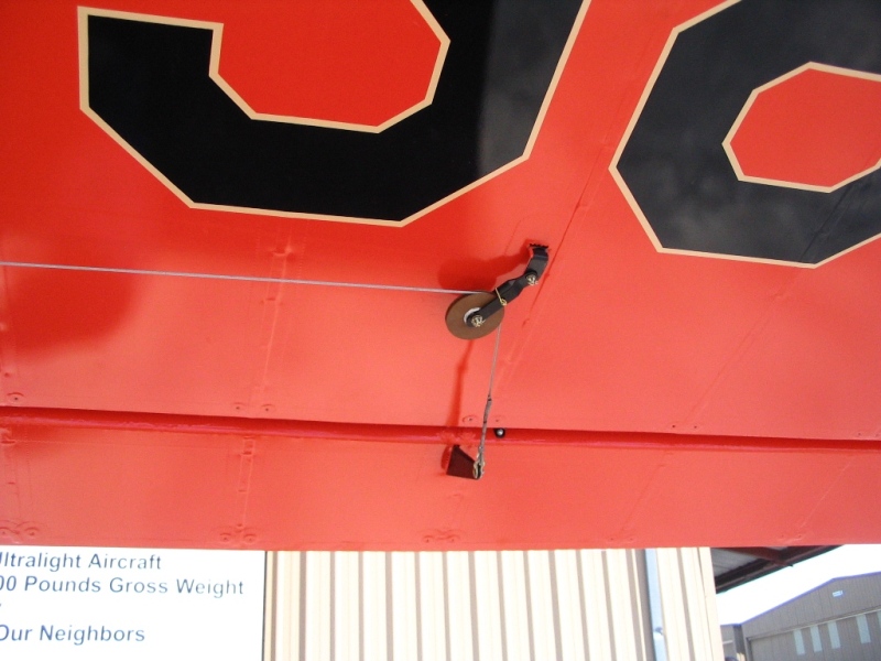

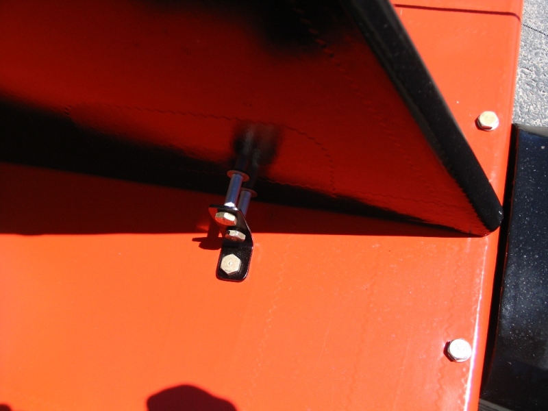

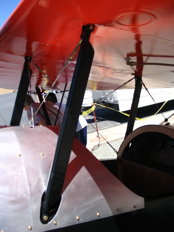

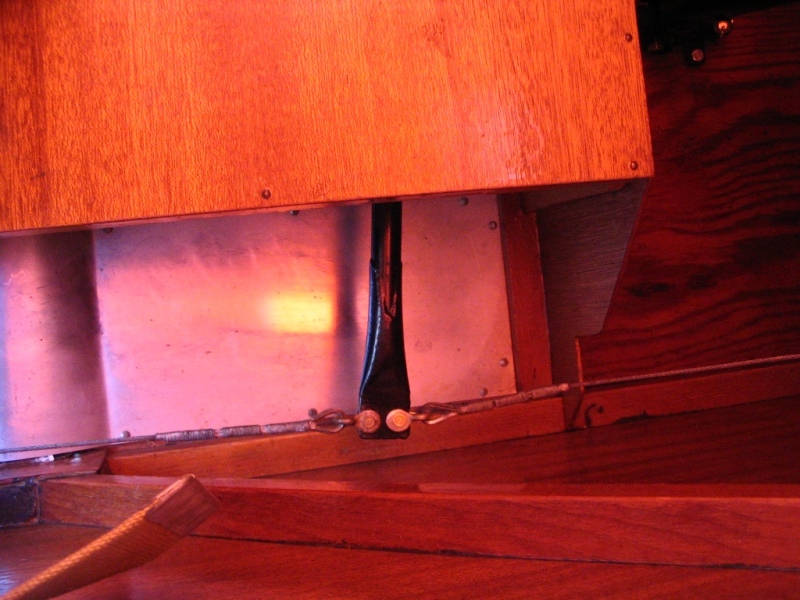

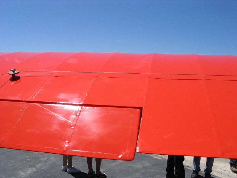

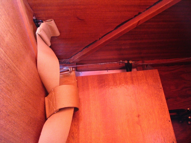

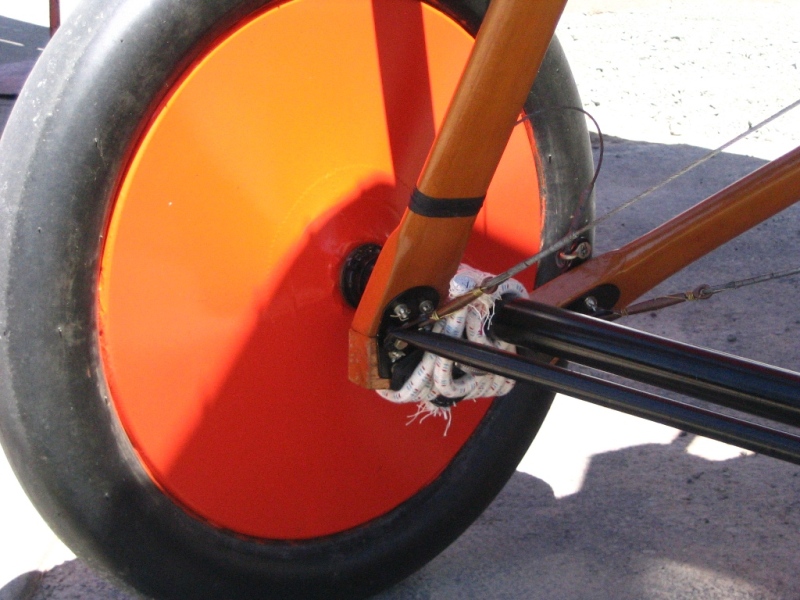

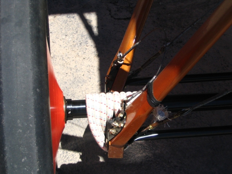

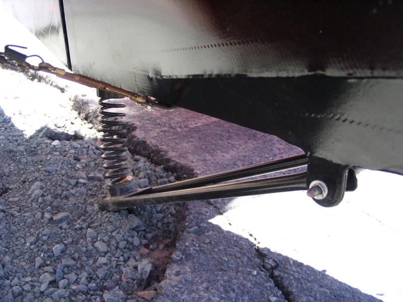

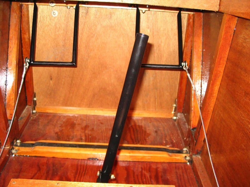

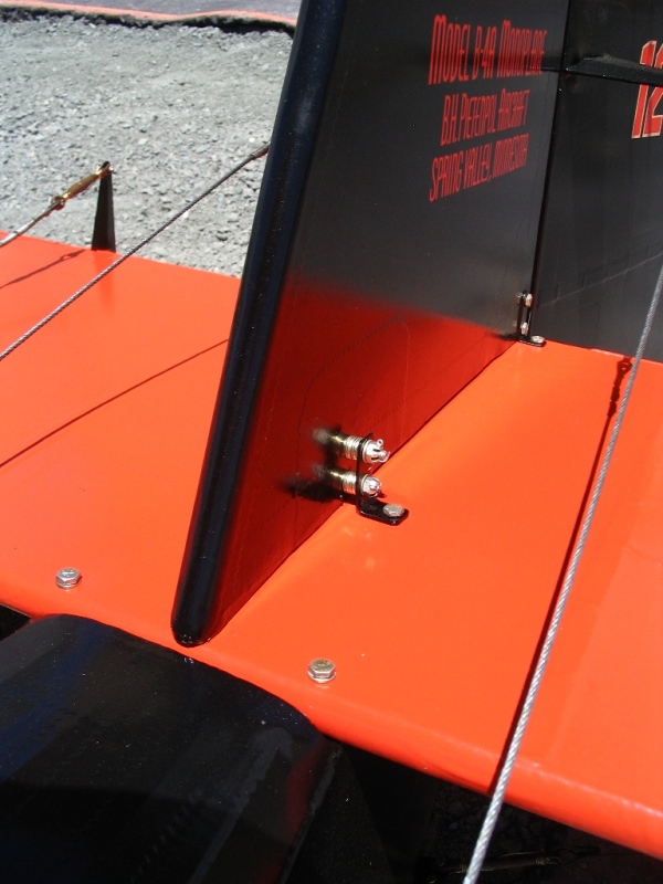

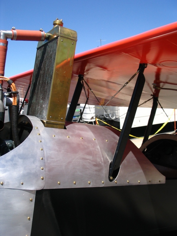

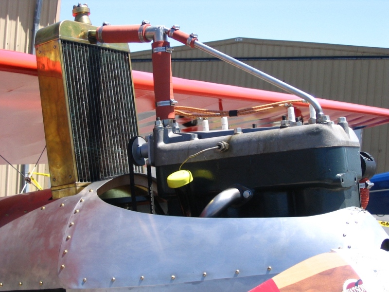

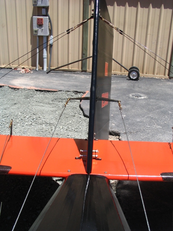

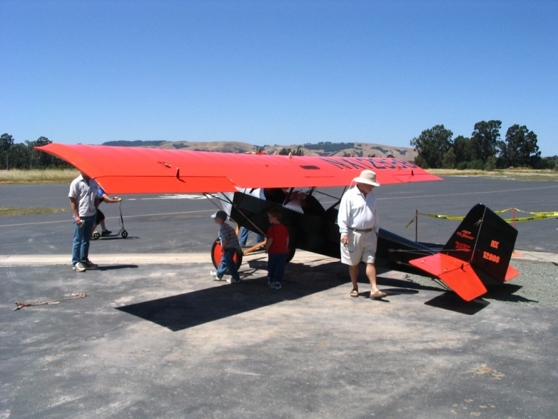

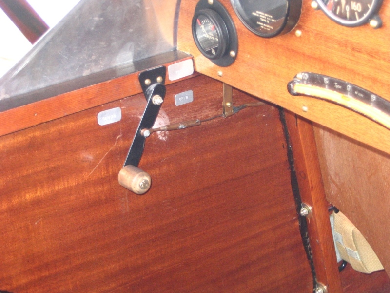

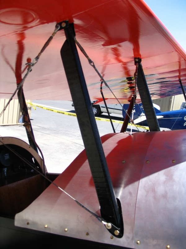

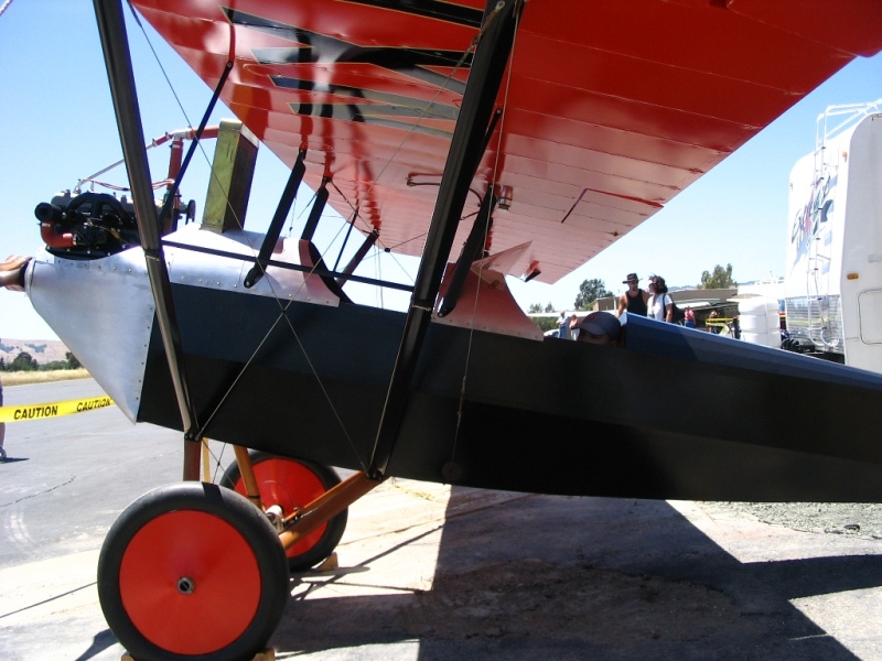

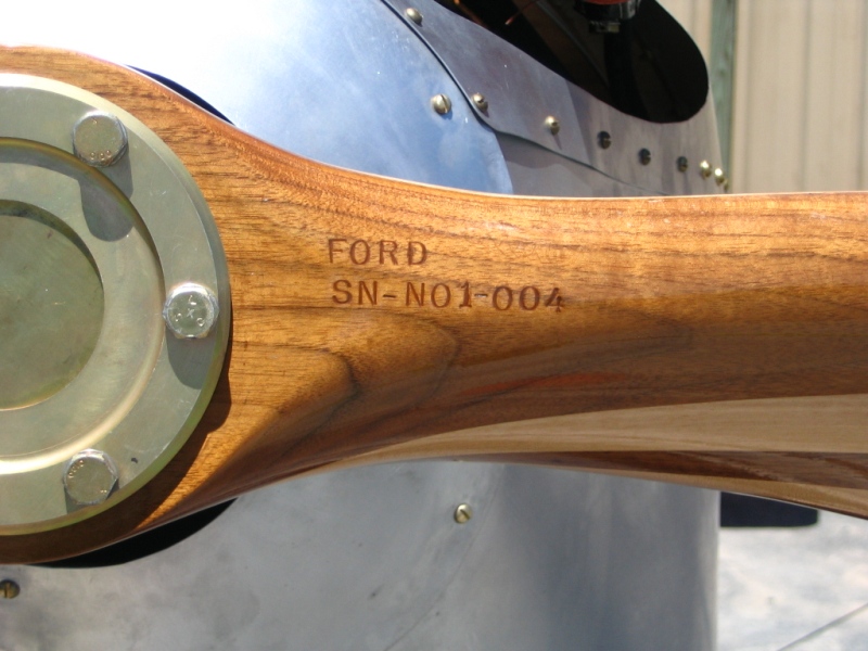

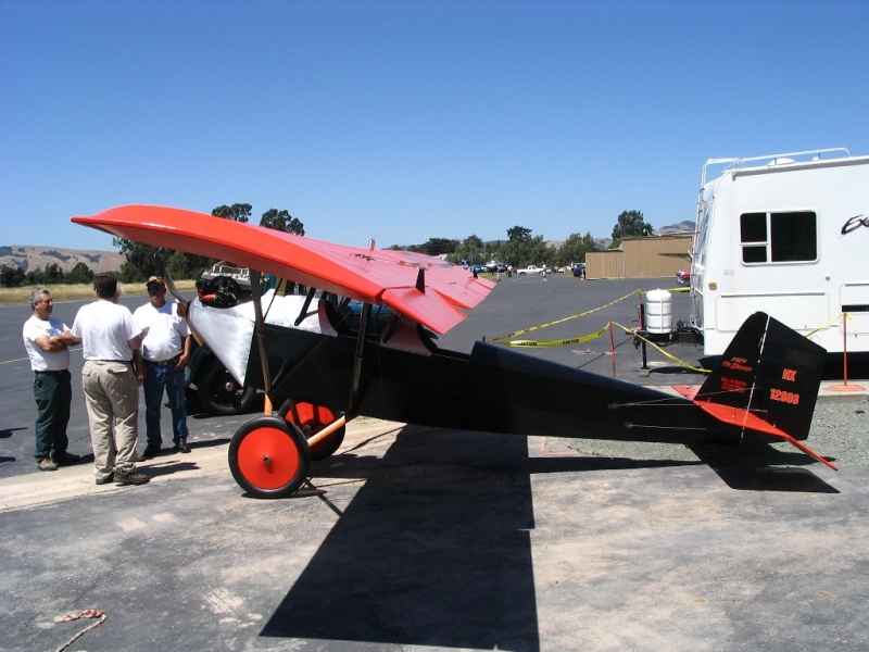

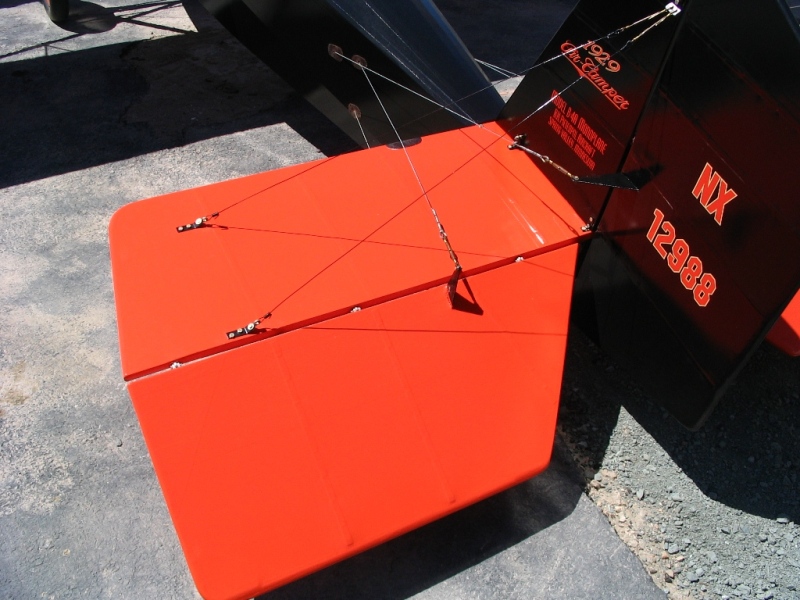

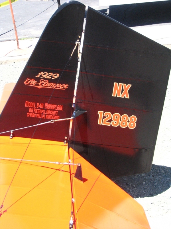

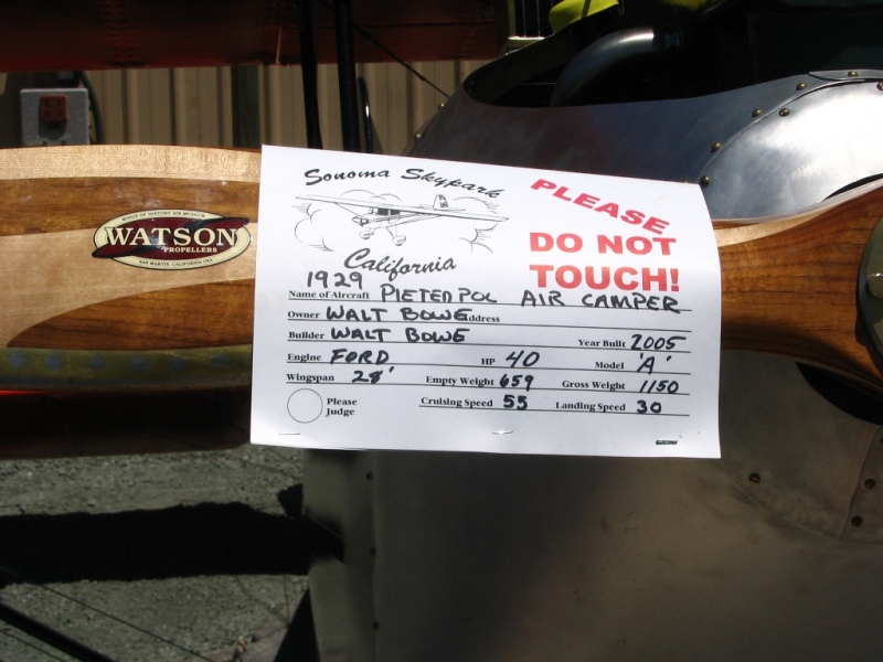

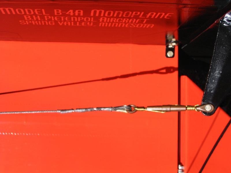

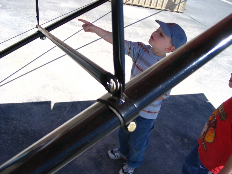

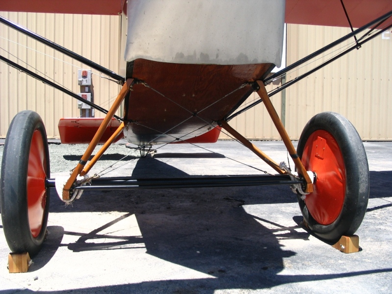

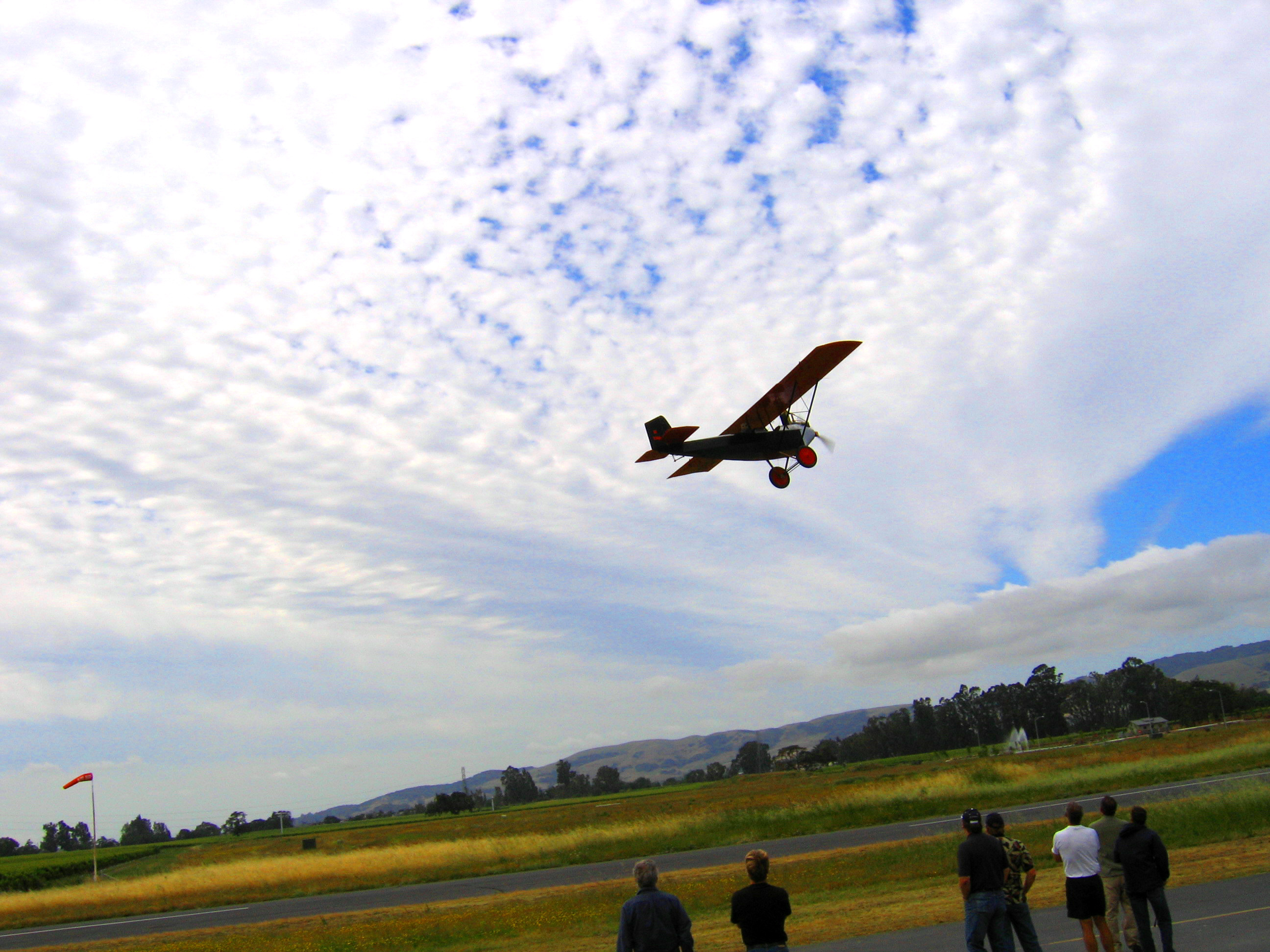

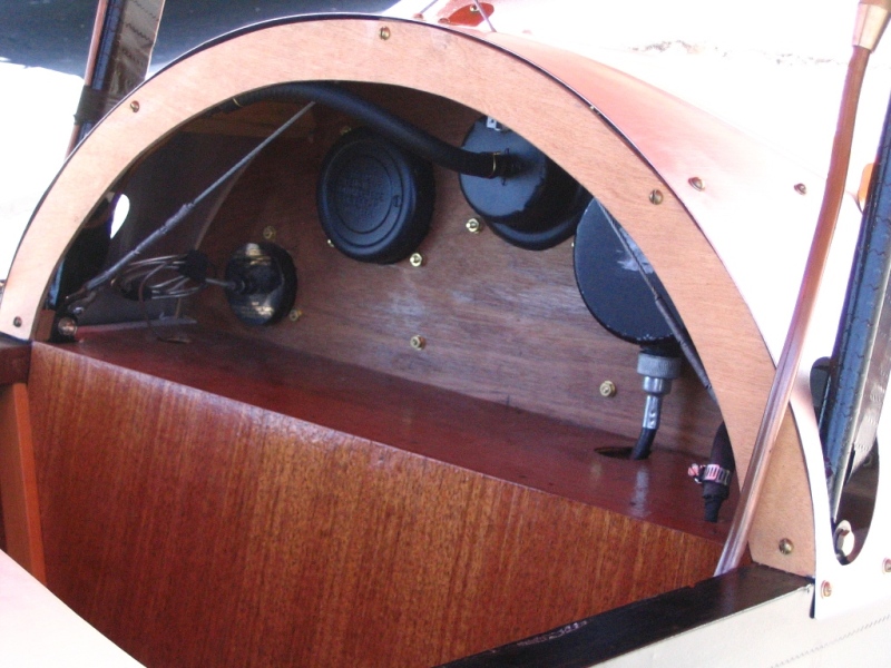

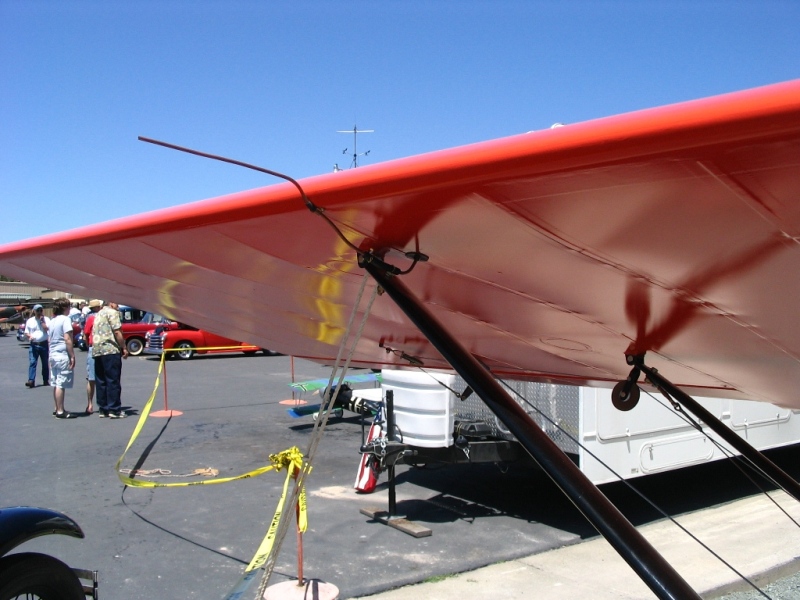

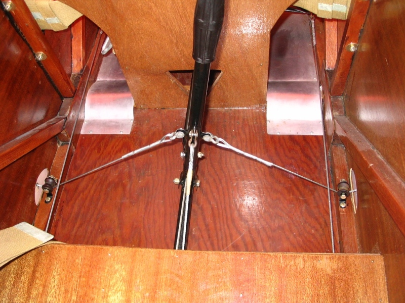

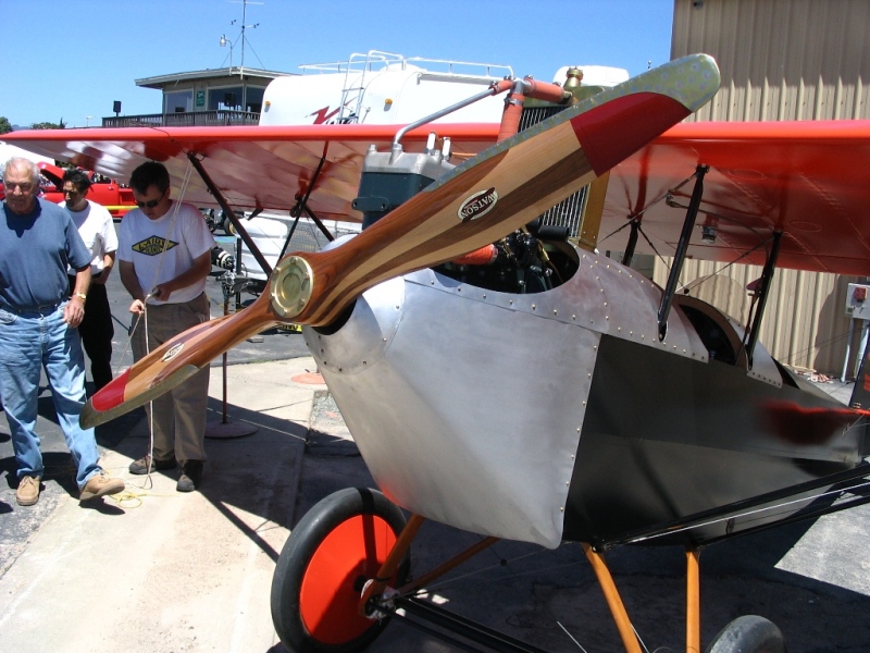

Subject: Walt Bowe's Ford powered Pietenpol Description: This is Walt Bowe's Ford powered Pietenpol that he completed last summer. It was built using the 1929 Flying and Glider plans. The major difference is the way the control cables are routed in the cockpit and the wing. You will note he tried to keep it as period as possible using hard wire on the tail and soldered eyes on the cables. The pictures don't do it justice.
