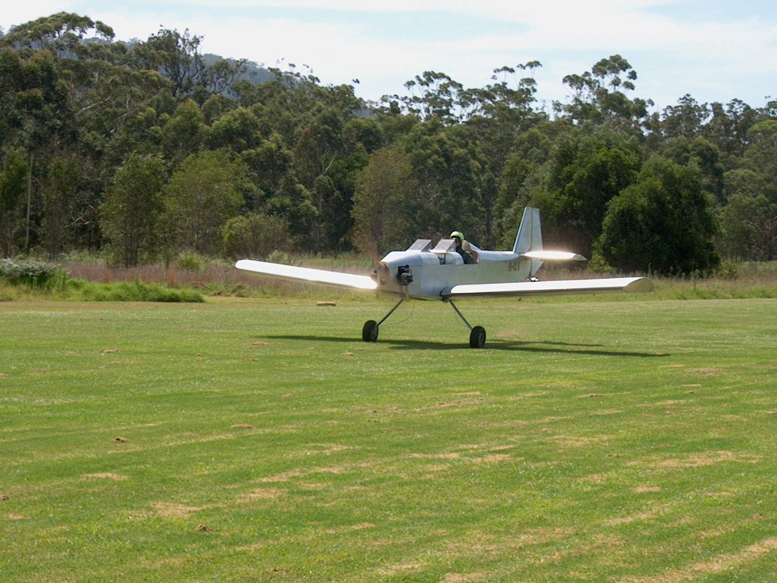

    KISS01~1.jpg First taxi, still needs fairings.

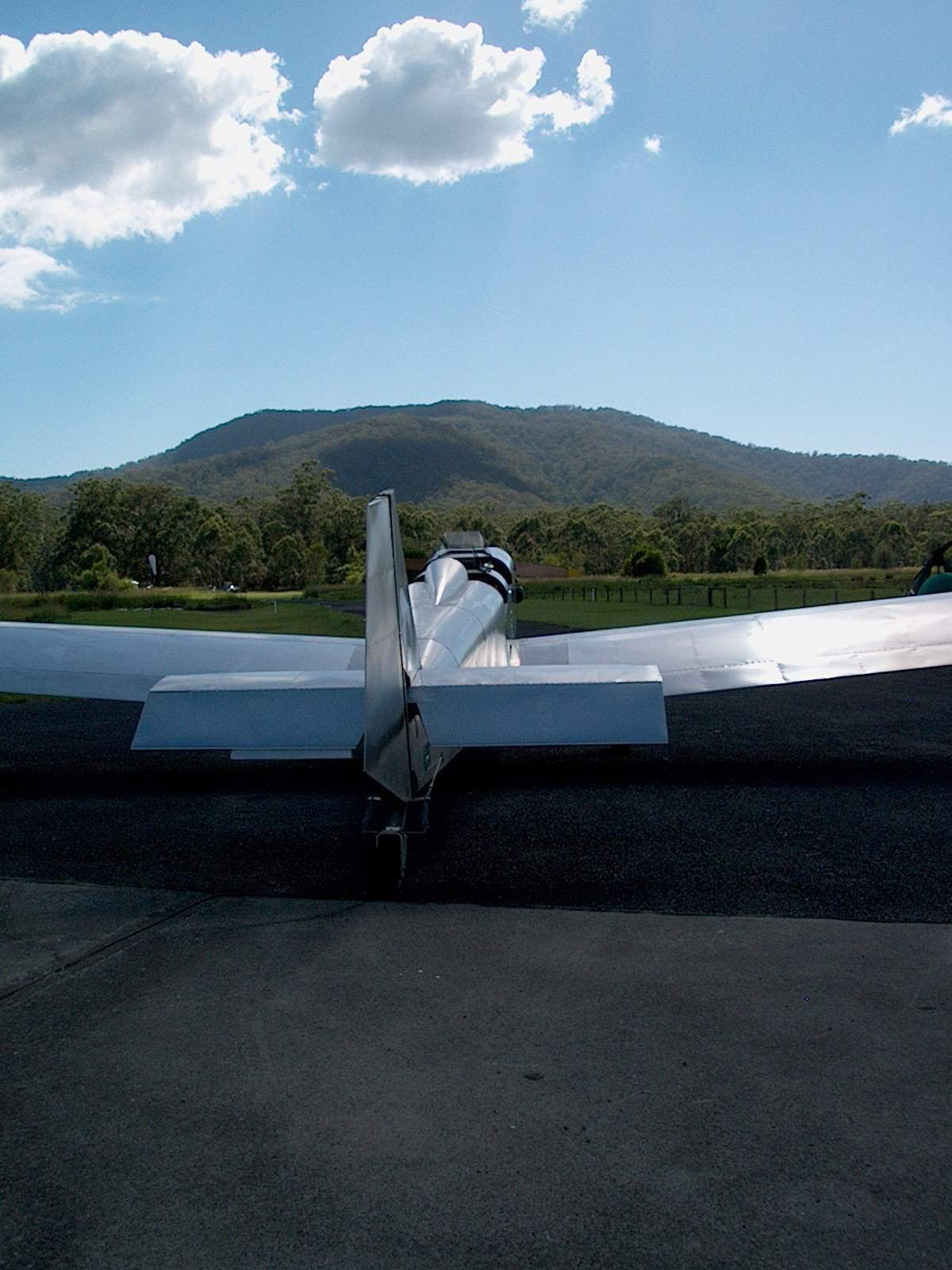

    REAR.jpg Rear view with the turtle deck.

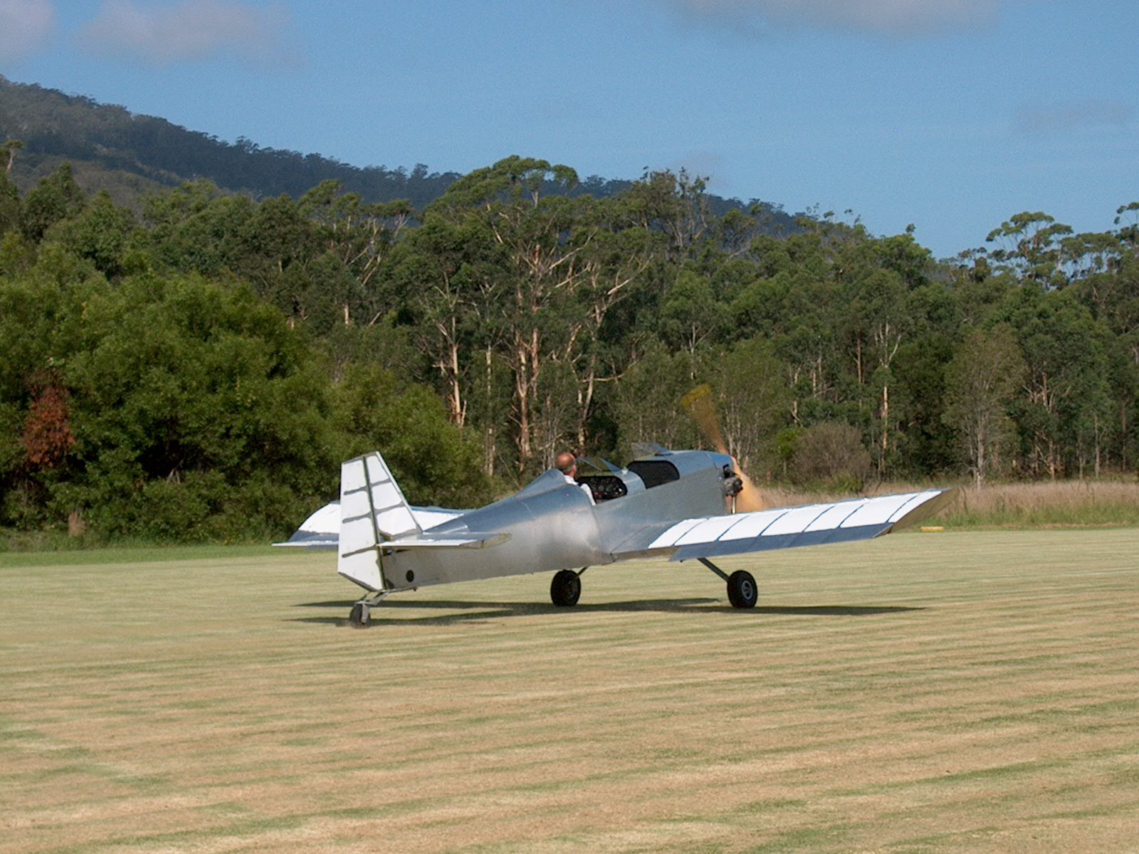

    TAXI.jpg Fast taxi, ready to go.
