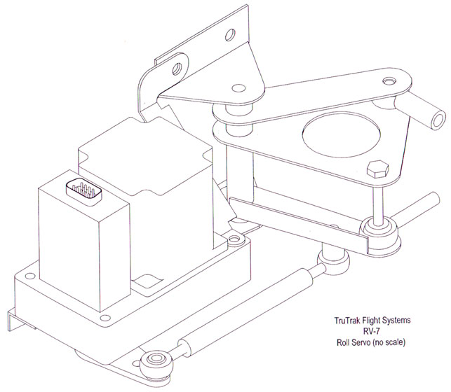

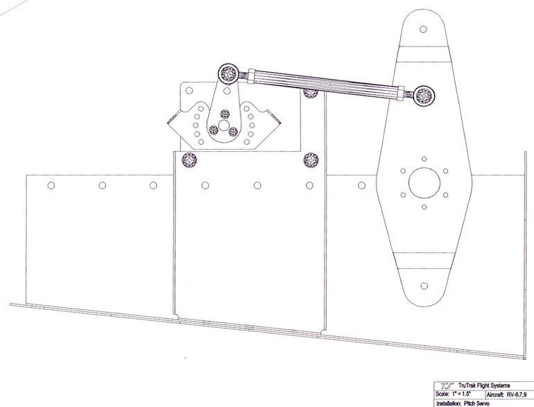

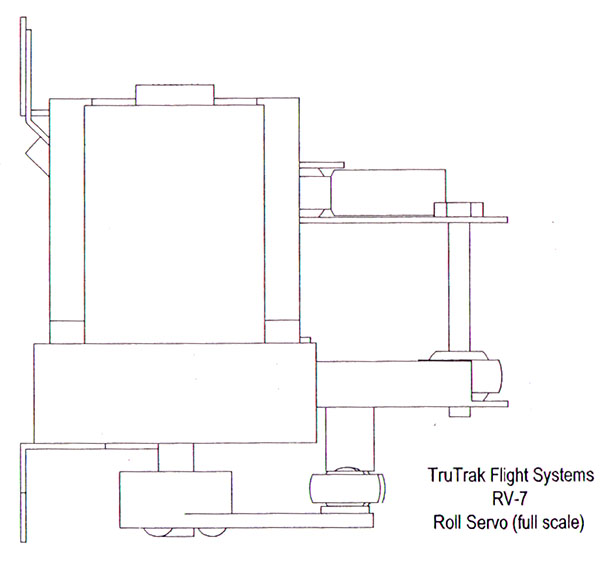

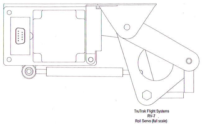

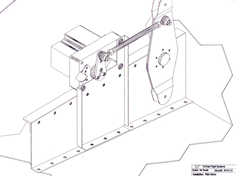

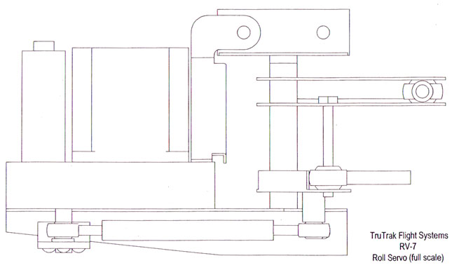

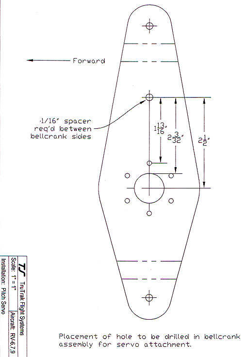

Subject: TruTrak autopilot installation diagrams Description: This was scanned from TruTrak's information packet, which shows the installation on an RV-6, RV-7, RV-8, etc.
pitch_servo1.jpg Pitch pitch_servo2.jpg Pitch pitch_servo3.jpg Pitch roll_servo1.jpg Roll roll_servo2.jpg Roll roll_servo3.jpg Roll roll_servo4.jpg Roll
