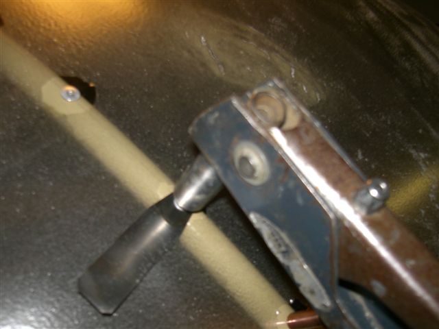

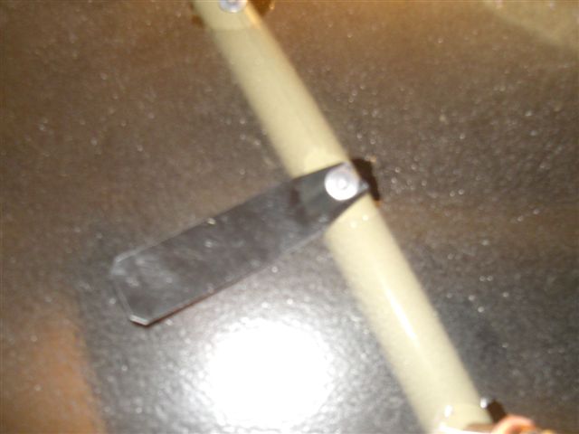

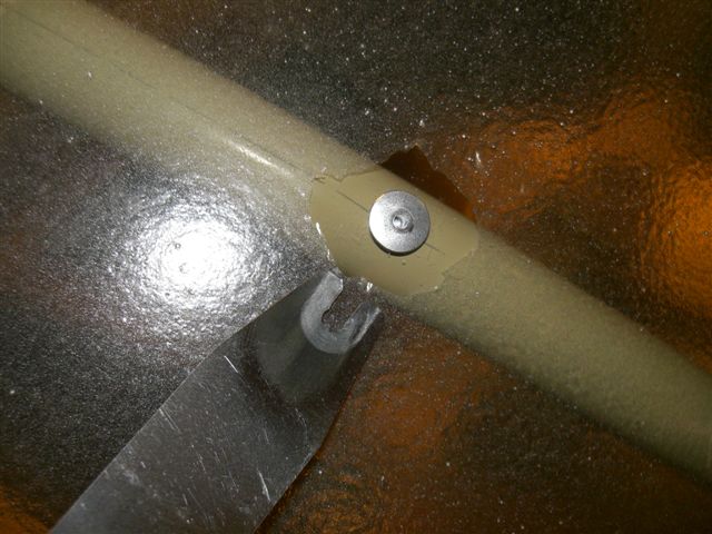

Subject: Canopy Fastening Description: Thought you might be interested in how I did my canopy. The rivits are intended for fabric covering, and are all aluminum, #11-57 from Wicks Aircraft. I drilled 3/16" holes in the canopy, and used .004" thick forked shims to remove all preload after riviting, so the canopy can move as intended. These rivits also drill out very easily if needed. I'm very happy with the results, but I reailze there are many good ways to git-R-done.
