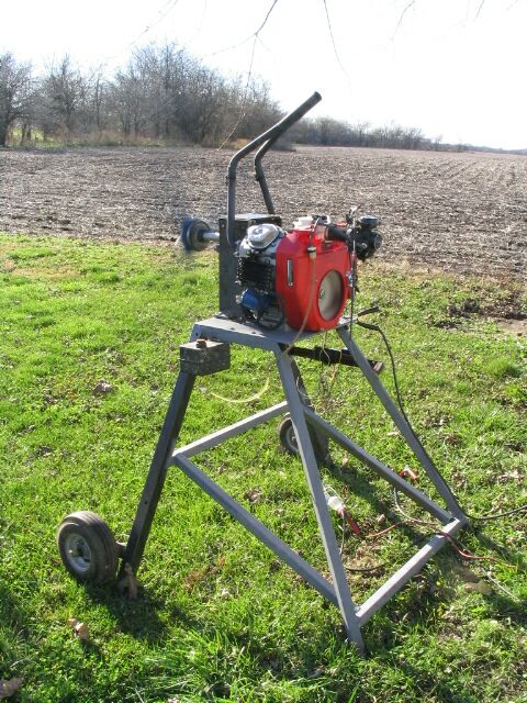

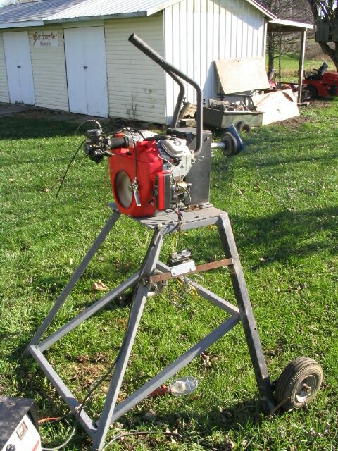

Subject: Honda Test Stand Description: Here is a pic of the Honda running on a test stand...4400 rpms...3 blade 60" IVO...2.2 :1 reduction 30 minute test at 4400 rpms...CHT stable at 270F. Pitch set the same as will Propell a FireFly at 60 mph at same prop hub speed.
