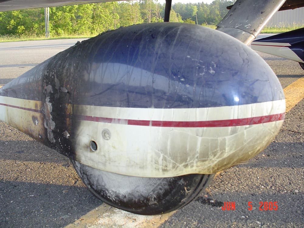

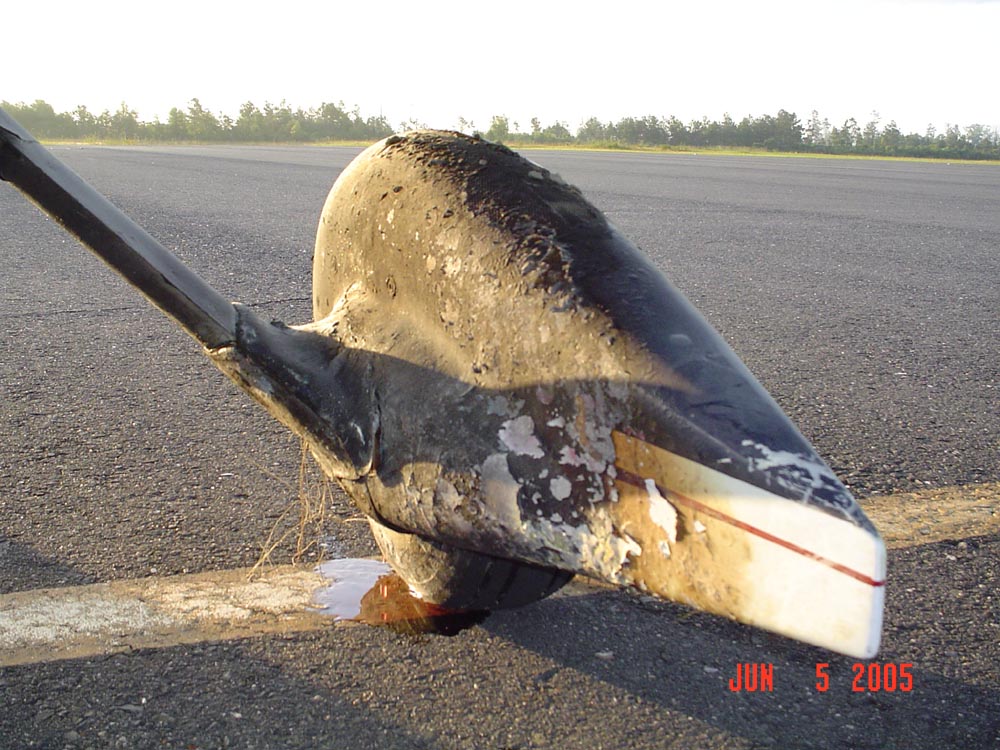

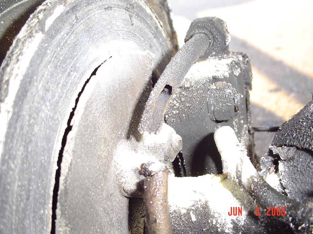

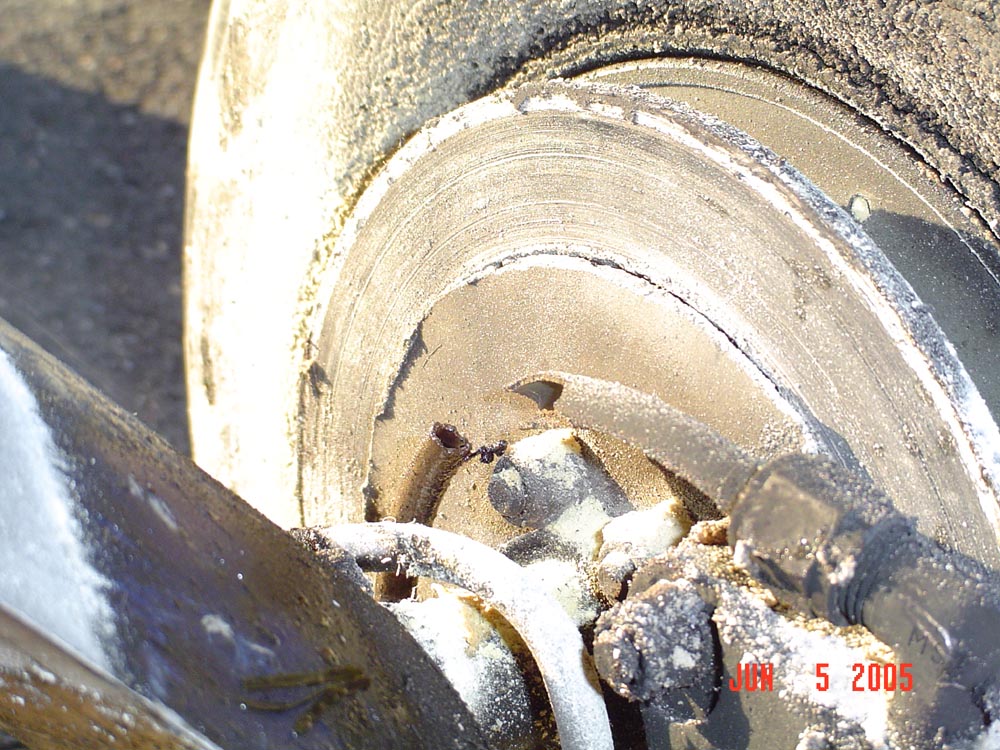

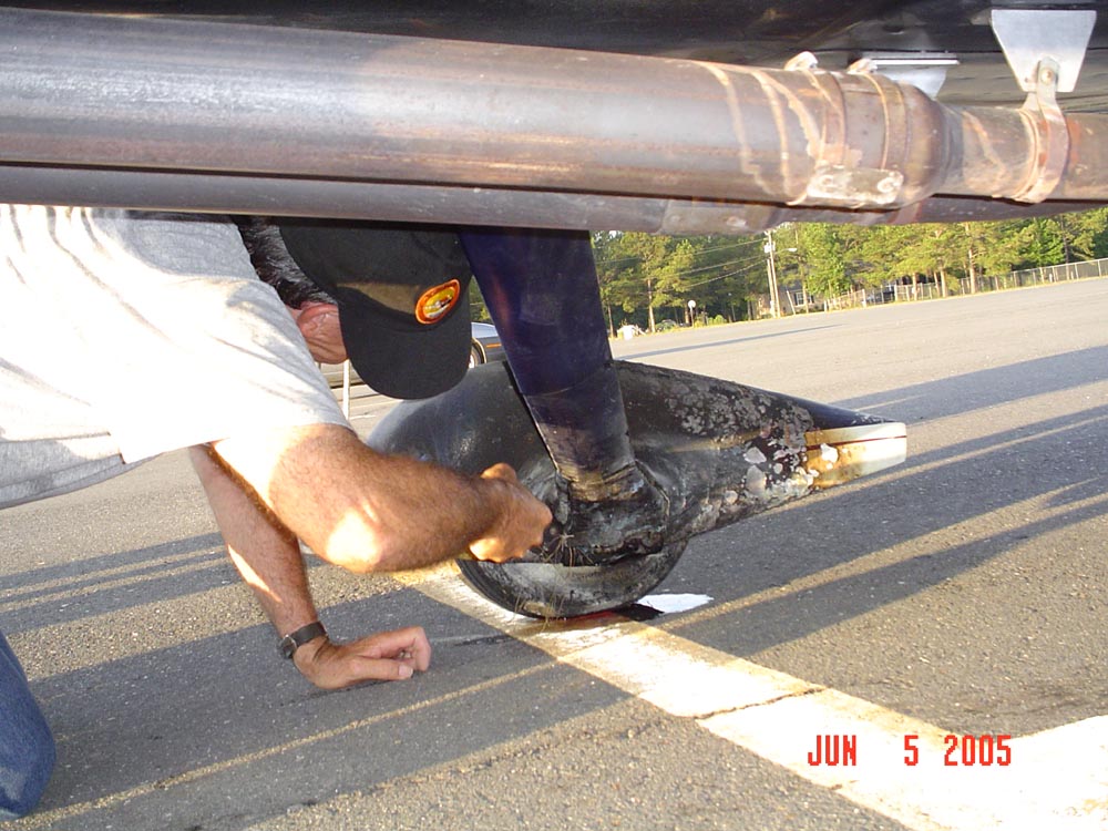

Attached are several photos of the results. It appears that the brake line failed due to Fatigue with a long chunk blown out of one side.
The only permanent damage appears to be to the tire and wheel pant. The tire was a brand new Michelin (sob!) and although puckered by the heat still remained inflated. Thoroughly clean the entire wheel and brake assembly, replace the piston "O" ring and replace the brake line with stainless steel braided brake hose. I was concerned about the effect of the heat on the rear bottom skin panel but tapping it with a coin produced the same tone as the other side of the wing - so I concluded it was not damaged.

Strongly recommend anyone with the aluminum lines check for damage or leaks. The line could have failed due to stress during installation, material defect, or unnoticed damaged someplace along the way. But, the way the line has an approx 1" chunk blow out from the side which indicates metal fatigue to me.
