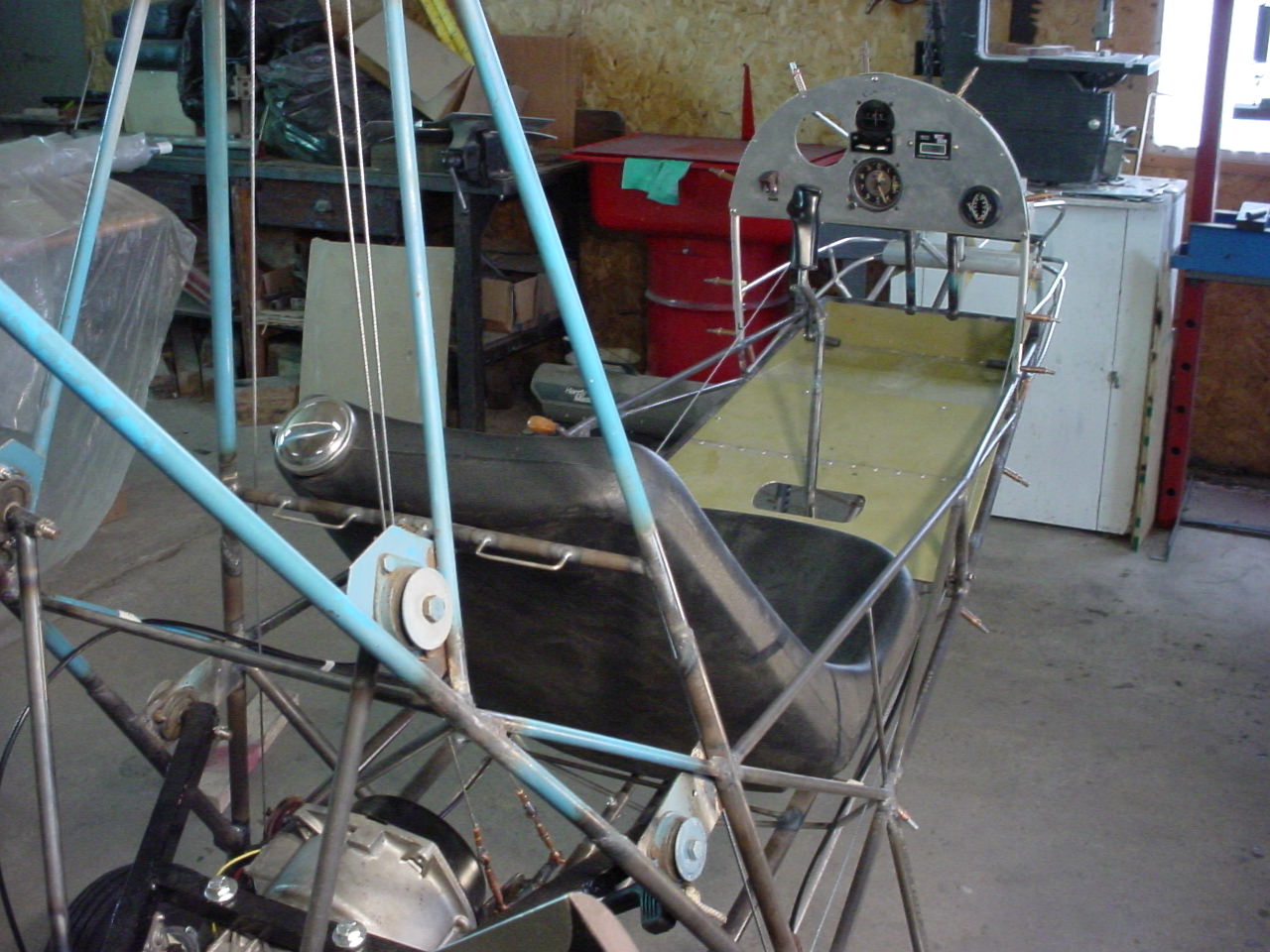

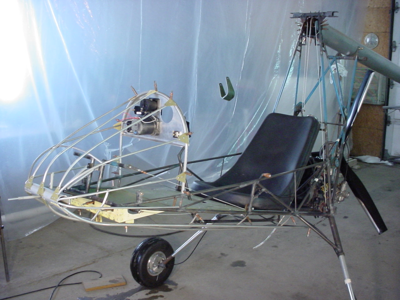

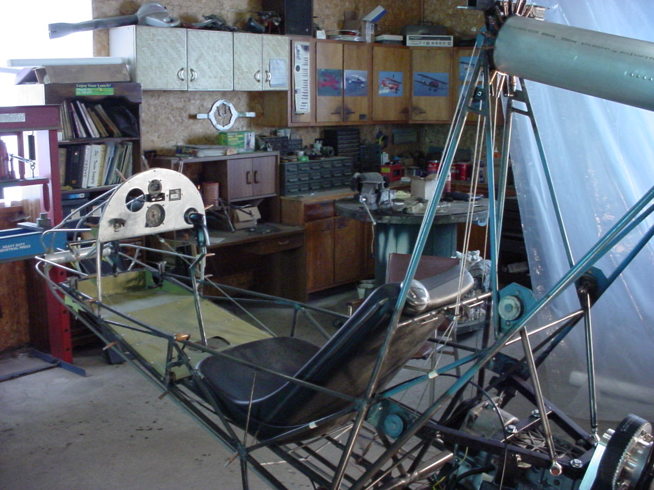

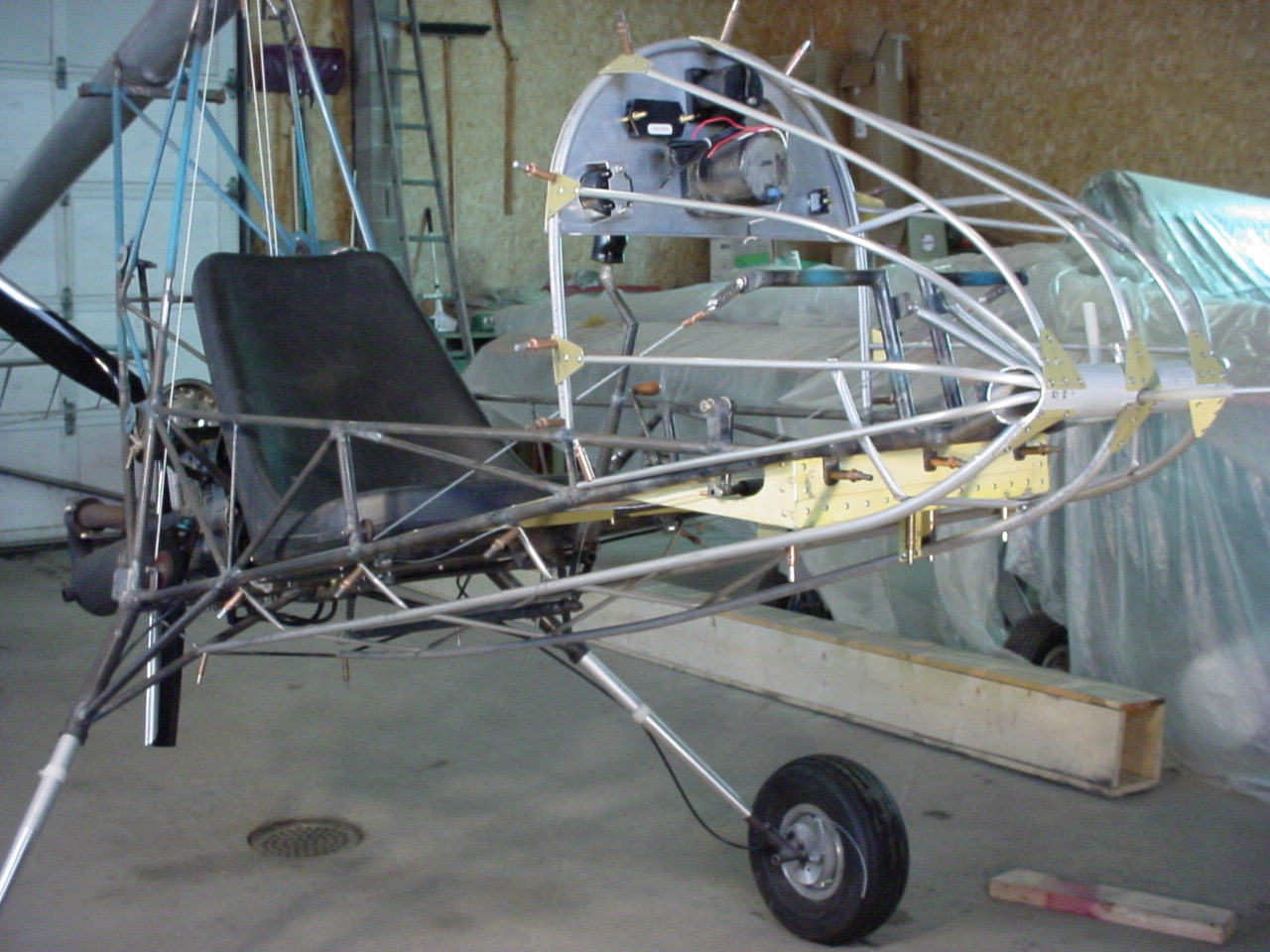

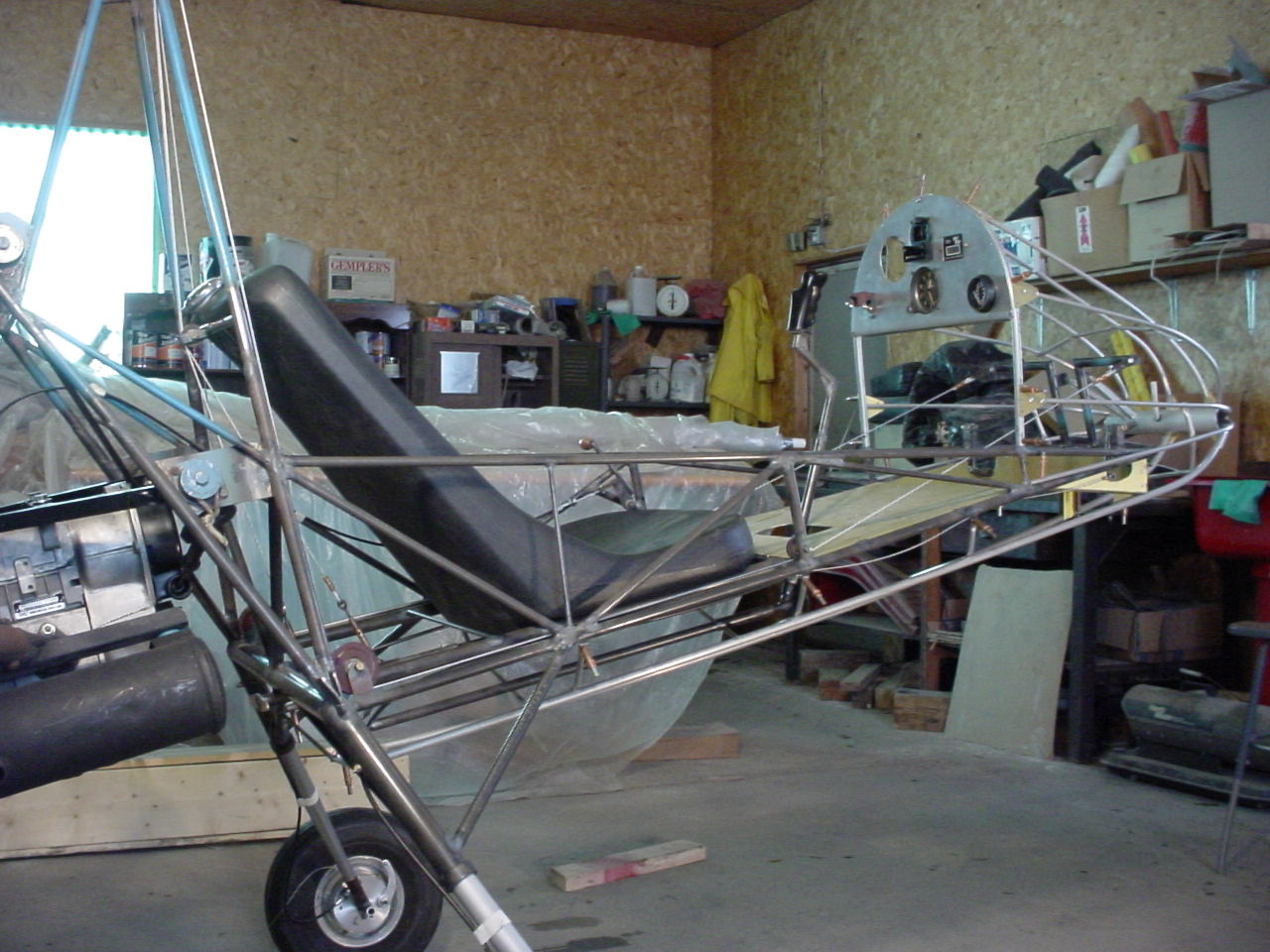

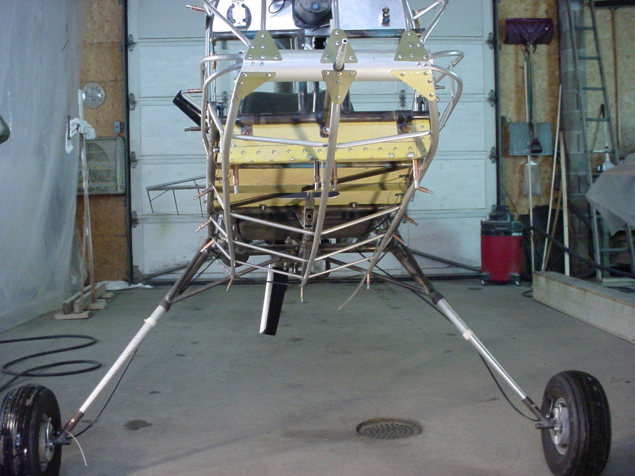

Subject: Progress of Modified Ultrastar Description: Here is the modified Ultrastar with all the mods I think will improve the original for my use.. better prop clearance with stronger Firestar legs, semi enclosure with light nose cone, Brock seat tank,heel brakes, center stick with ball bearing pulleys and cable,fixed trim tabs on elevators, steel ring on end of boom tube and butt ribs of wings, VG's, full length ailerons,and streamline struts.Power is a 2SI F35 - 460 ( lightest model) with a 2SI cog belt and 3 blade 50 inch Ivoprop. I hope to stay within UL weight but may be dreaming....stay tuned.
