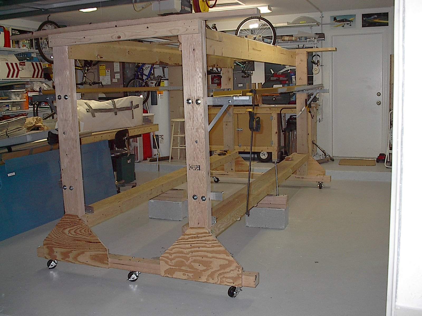

Subject: Wing Jig Description: I spent a little more than $200 building it, as well as 8 to 10 hours of part time work. I built it because I wanted to be able to open my garage door whenever I was working on the project and the Van's recommended jig would not have allowed it. At night, I don't mind being closed in, but on nice days it makes me feel good that I am enjoying the outdoor a bit and watching my kids play. The true advantage of the jig is that allows me to work on both sides of the wings at the same time without having to turn them each time. I have 3.5 feet of clearance between the two.
Also, my wing construction coincided with hurricane season. If one came our way, I wanted to roll the project out of the garage and into the house and put the cars in the garage. Perhaps too much thought went into it, but you never know.
wingjig.JPG Wing Jig
