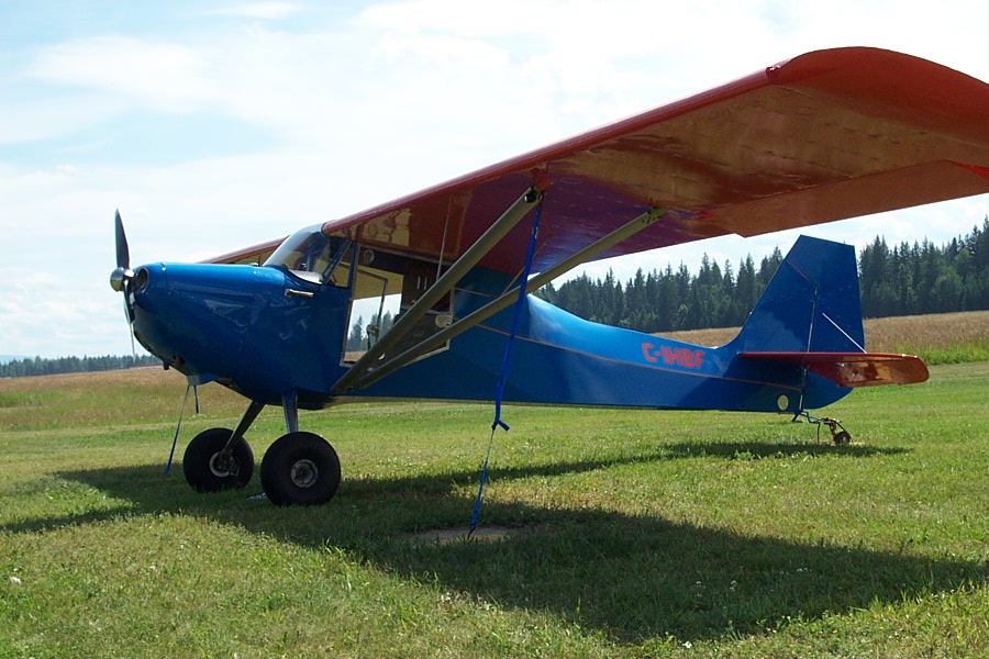

Subject: Razzorback Photo Description: Modified Aeronca Chief. Aluminum spars 39ft 4in wing span, stick control, aluminum spring gear, patrol doors , cuffed leading edge, antenna inside fuselage, eliminated the 20 lbs of wood formers on the fusalage.
