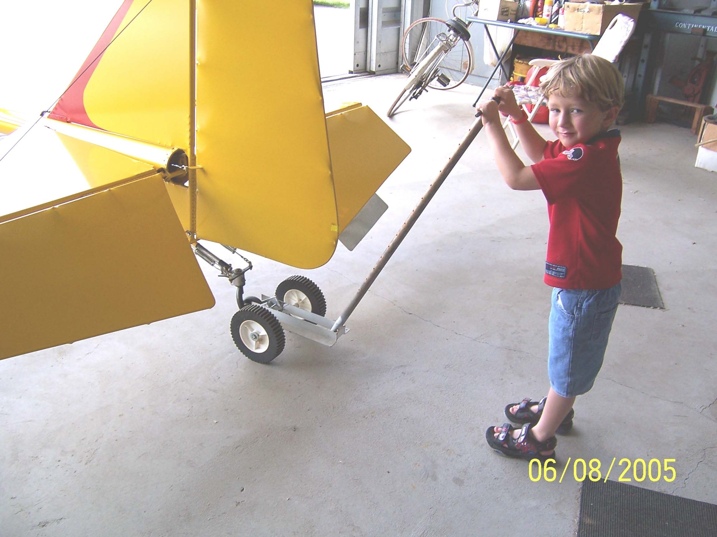

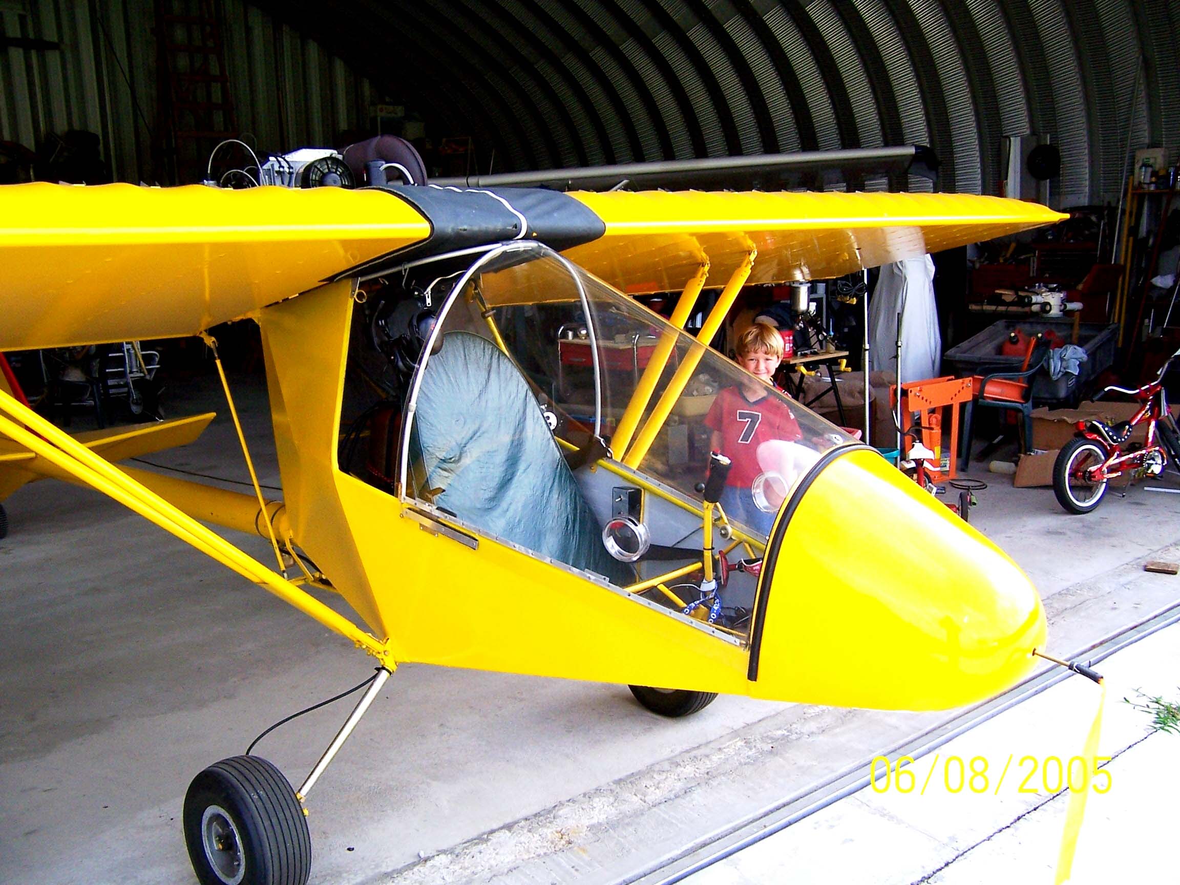

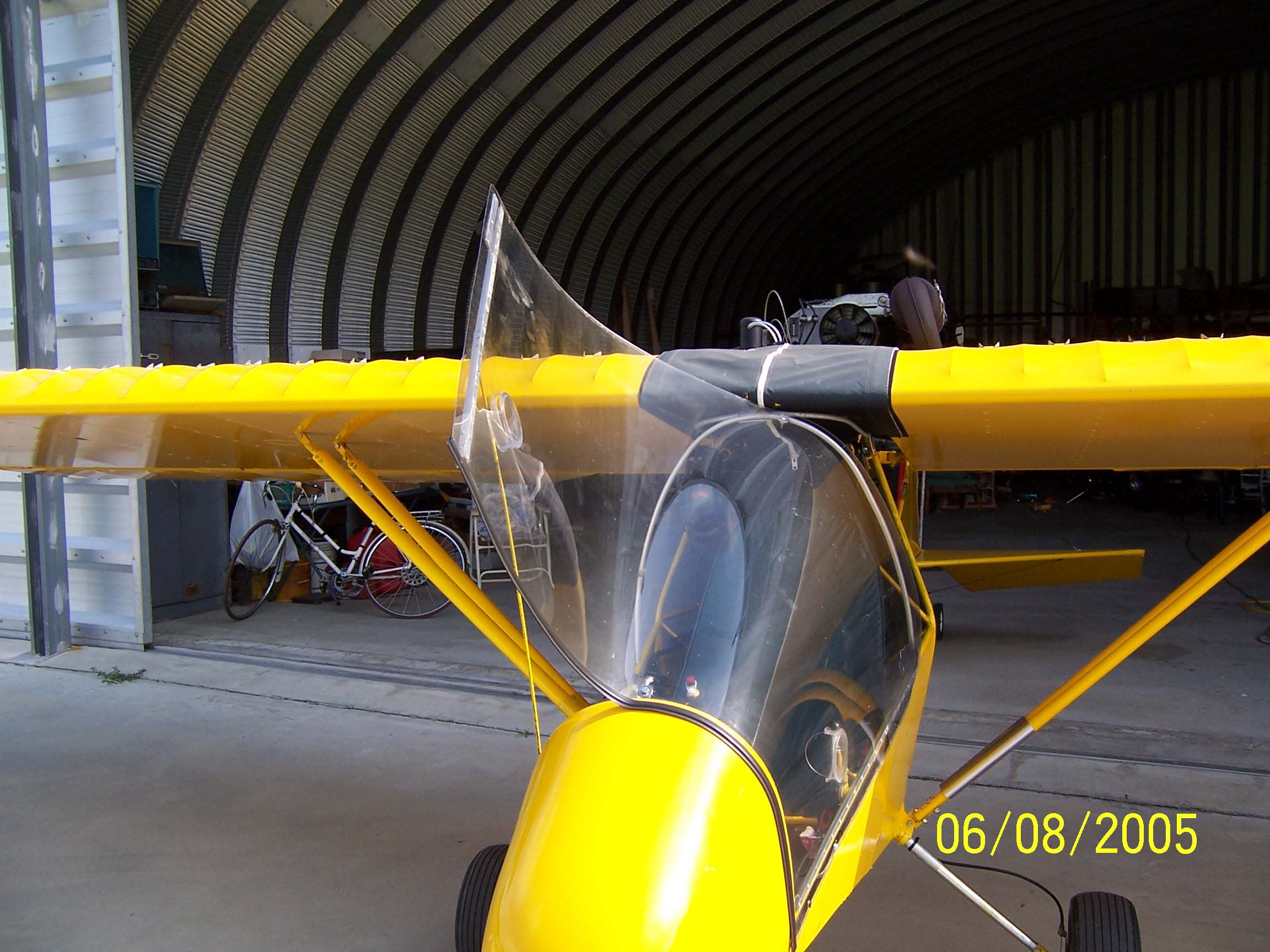

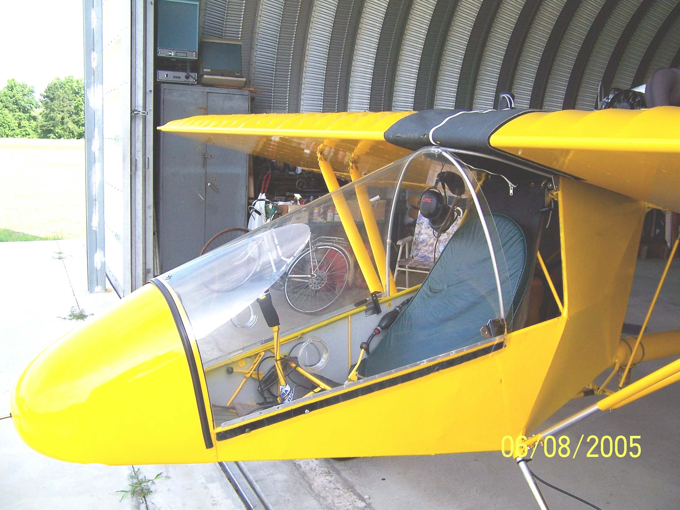

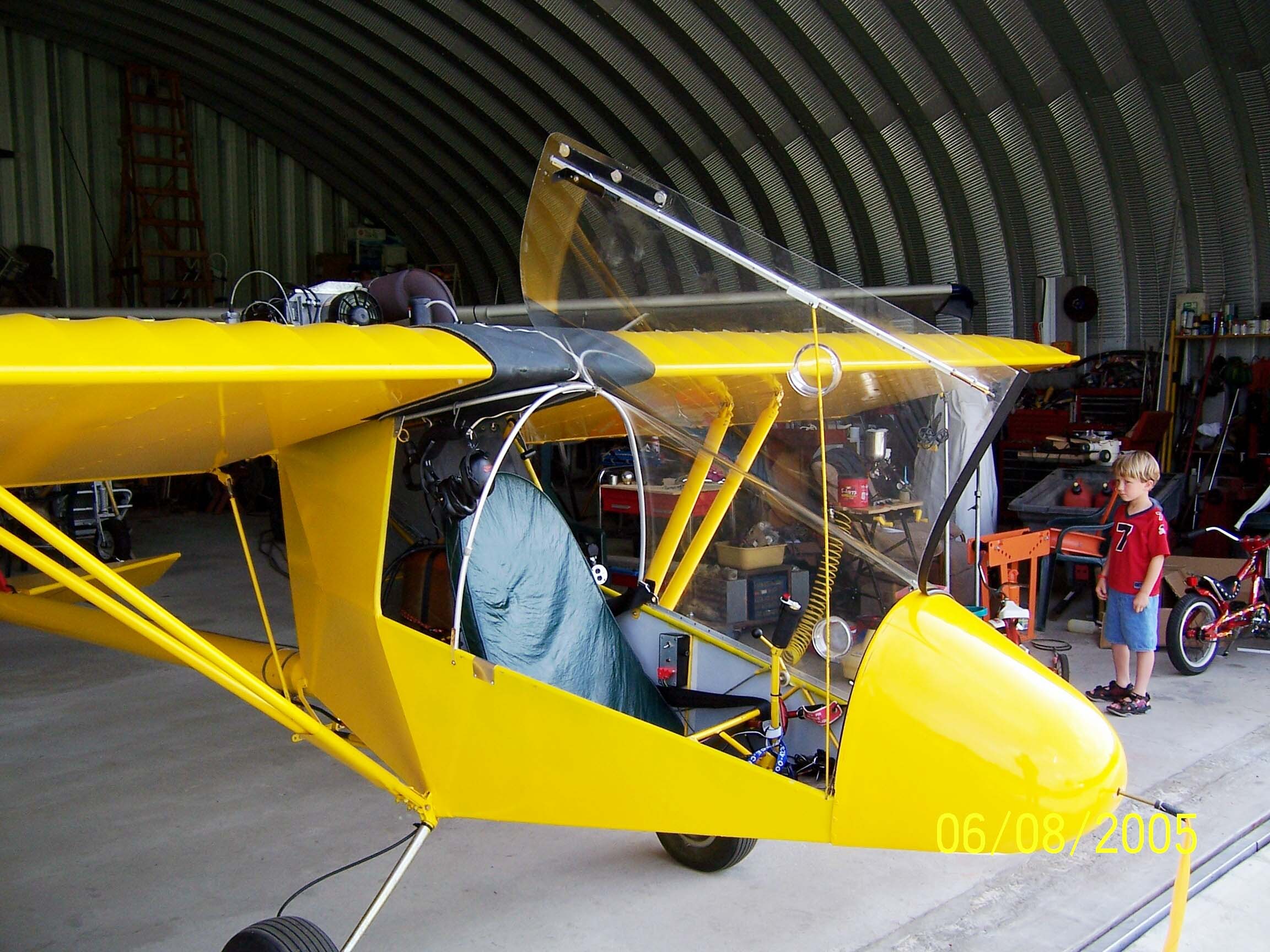

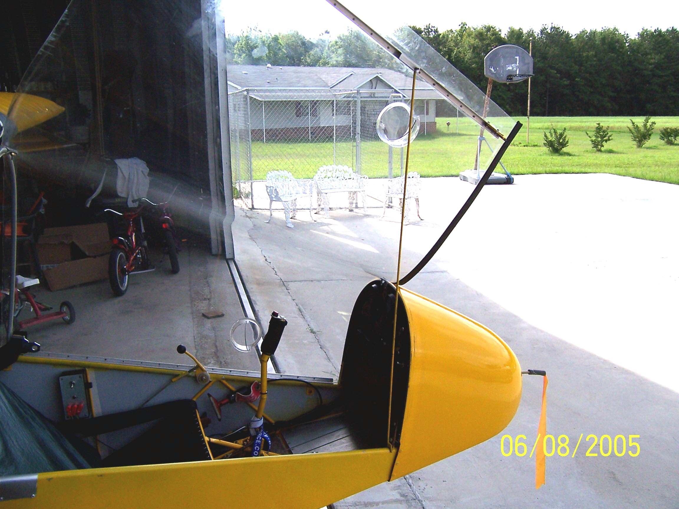

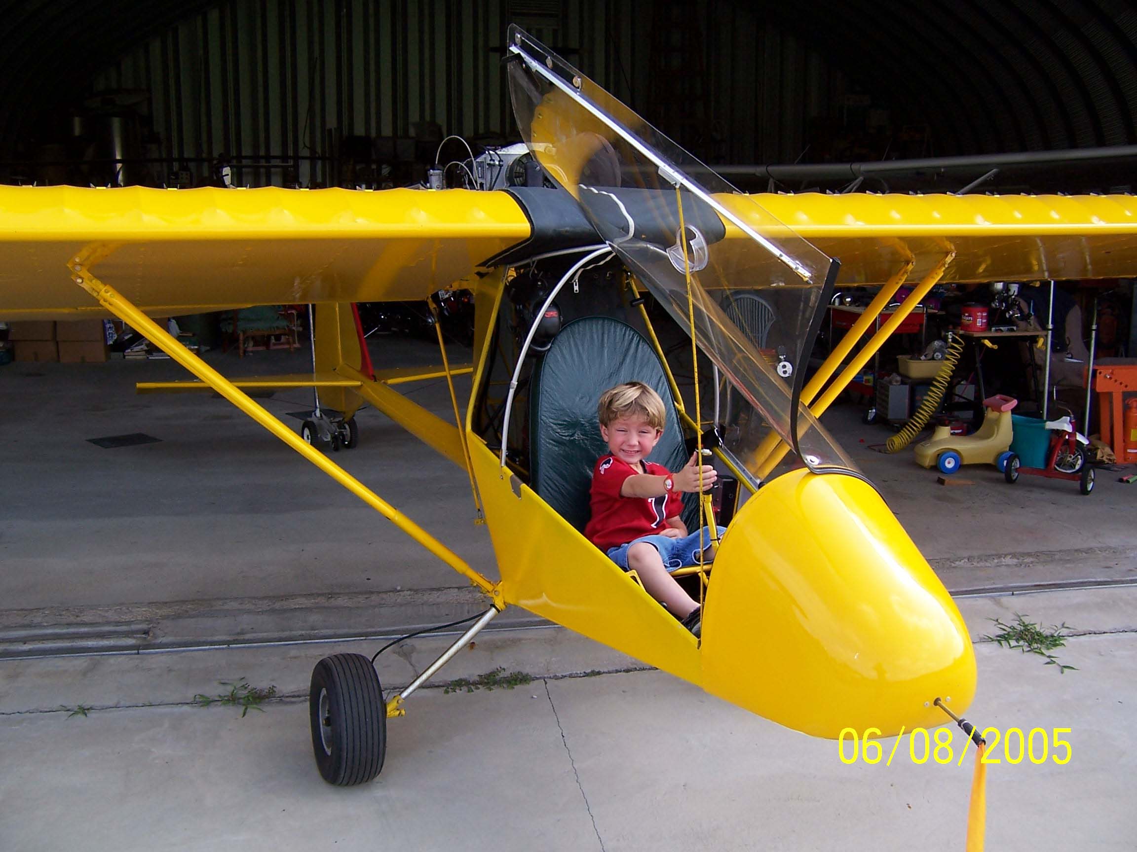

Subject: Jimmy Hankinson Full Enclosure Description: These are pictures of my full enclosure on my Firefly, Has been on since 1999 and shows no sign of cracks or fatigue. Rod stored up in nosecone during flight, easy to open when exiting craft. Top of rod has a 90 degree bend that's fits into the inside handle and the bottom has a 1/2" washer cut in half and welded to the bottom of the rod.
100_0316.jpg Full enclosure right side 100_0317.jpg Full enclosure left side 100_0318.jpg Enclosure open right side with support rod 100_0320.jpg Enclosure front view 100_0323.jpg Front view 100_0325.jpg Future Kolber 100_0326.jpg Tail dolly
