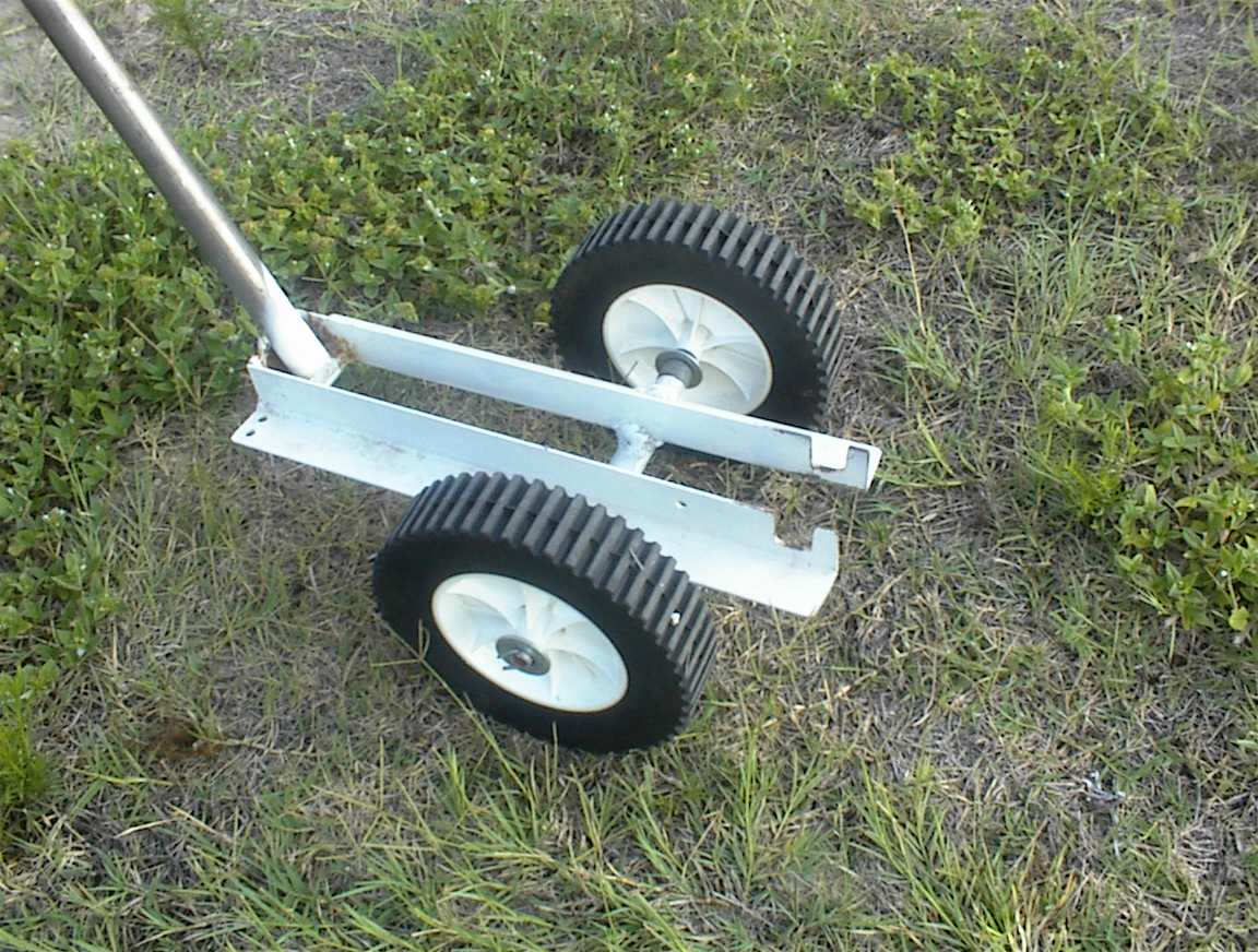

Subject: Wheel Trolley Description: This is a picture of my rear wheel trolley that I use. Made out of aluminum and lawn mower wheels. Handle is a length of 3/4" pipe with a t-bar on top. Place notches under axle and lower handle, lifts wheel off ground.
DSC00008.jpg Wheel Trolley
