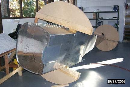

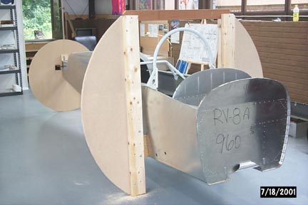

Subject: RV8A QB Jig Description: Here's a jig I made to ease construction of my RV8A QB fuselage. It's one man operable and makes life easier getting into tight places.
fjig4.jpg Upright ftipped.jpg On the Side
