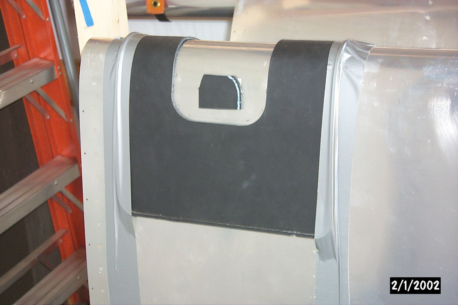

Subject: Landing Light Hole Description: Here'e another way to cut out the landing light hole.

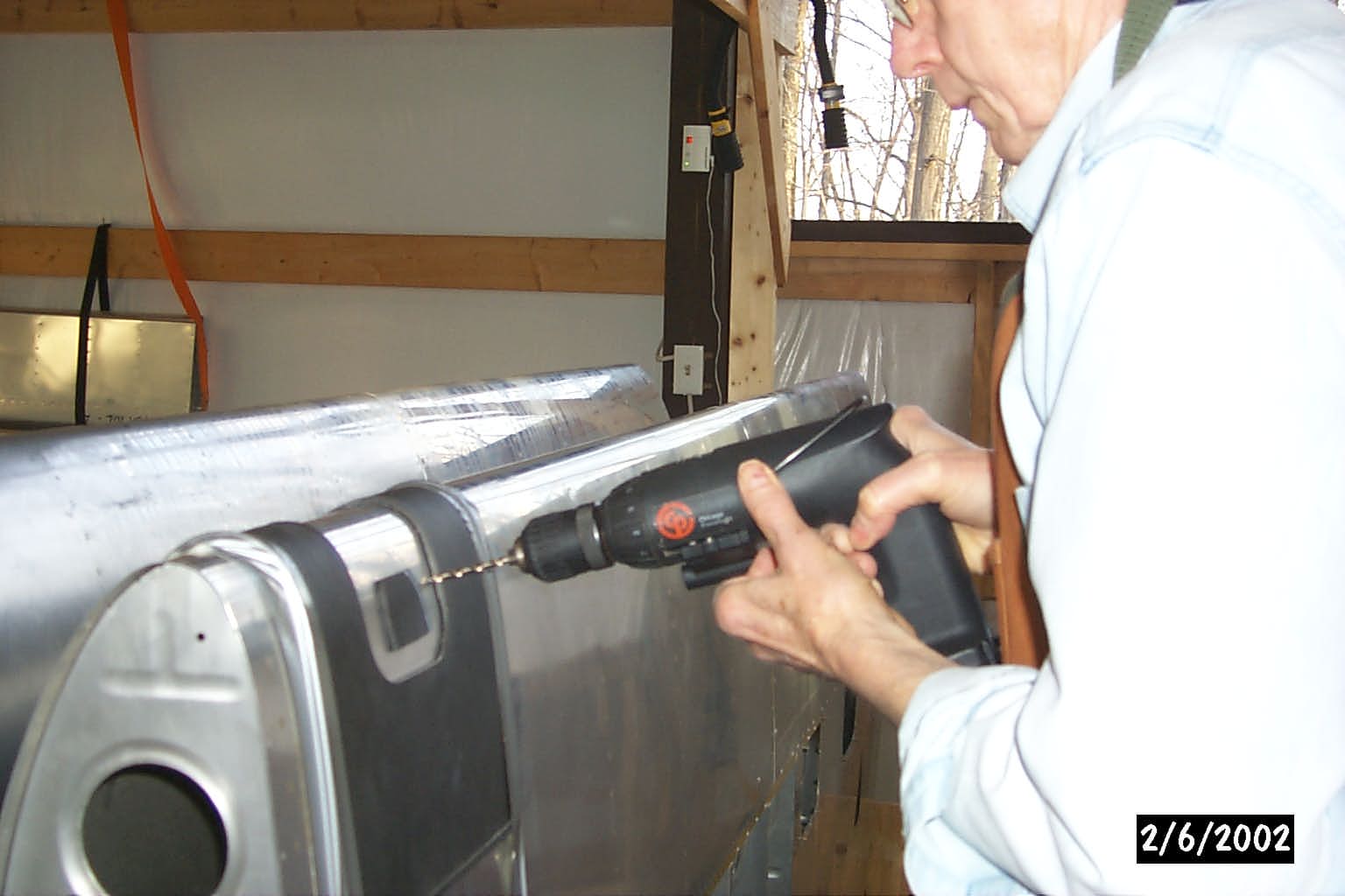

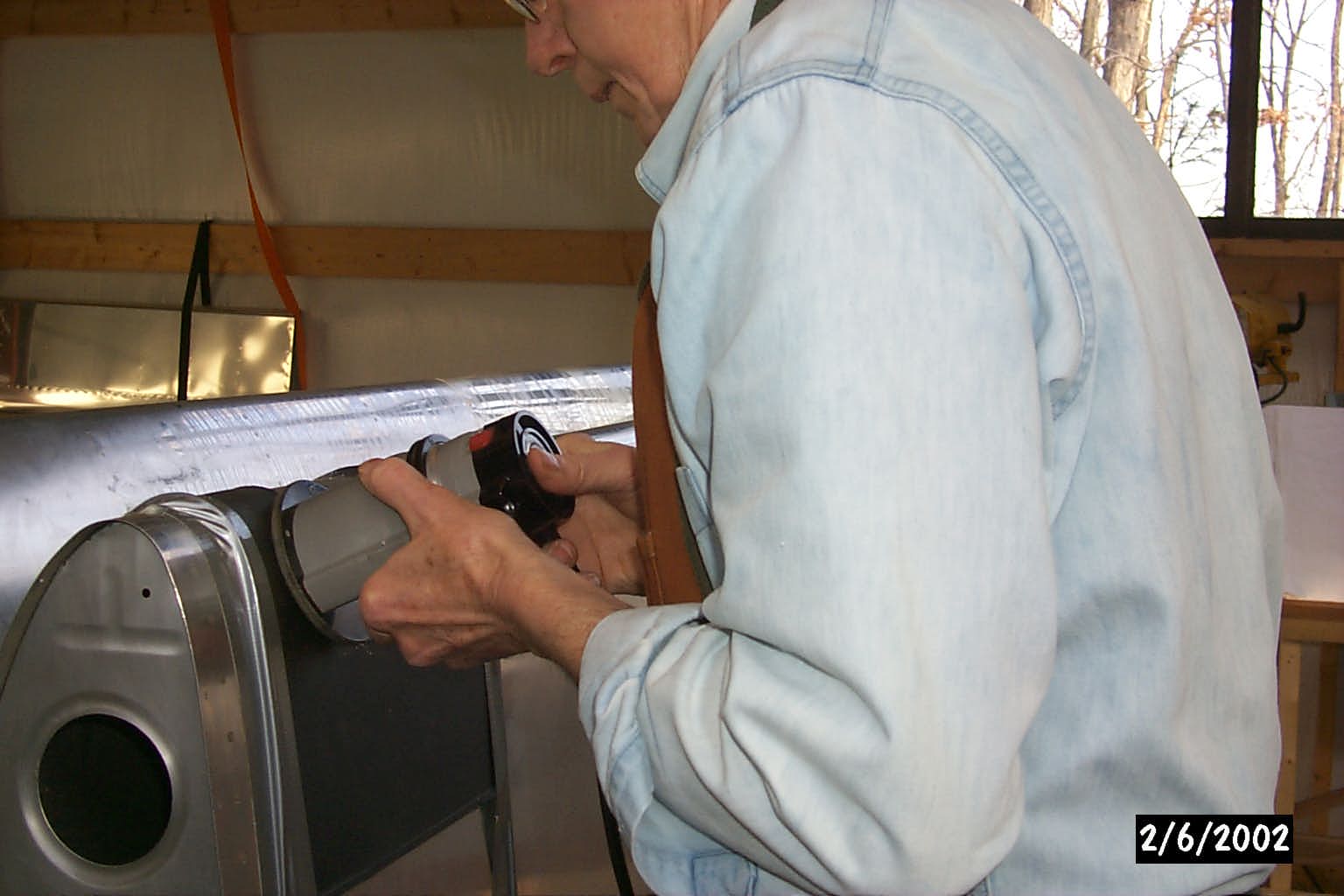

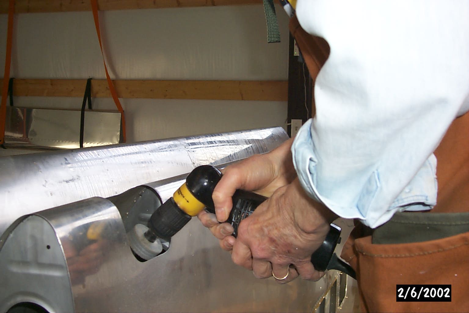

lndglite2.jpg I made a template from a heavy duty rubber mud flap (adjusted for the router collar) and taped it on using an aggressive double stick tape and duct tape. lndglite3.jpg Drilling a starter hole for the router bit. lndglite4.jpg Routing out the hole with a carbide cutting bit. lndglite5.jpg Polishing with a Scoth-brite wheel.
