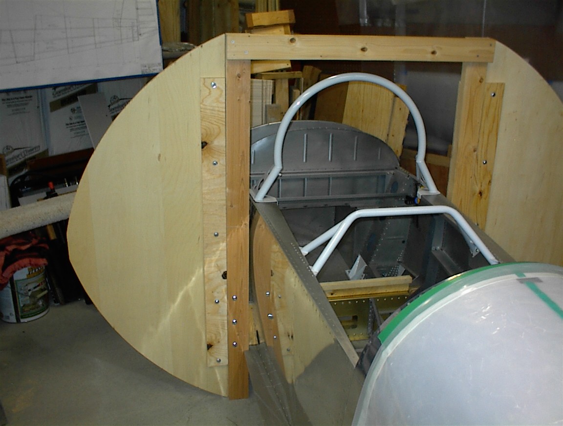

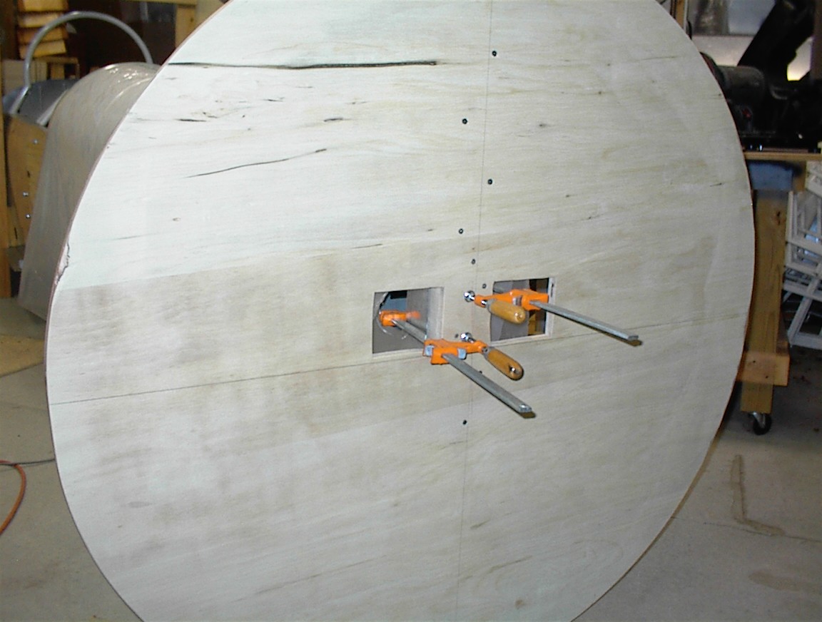

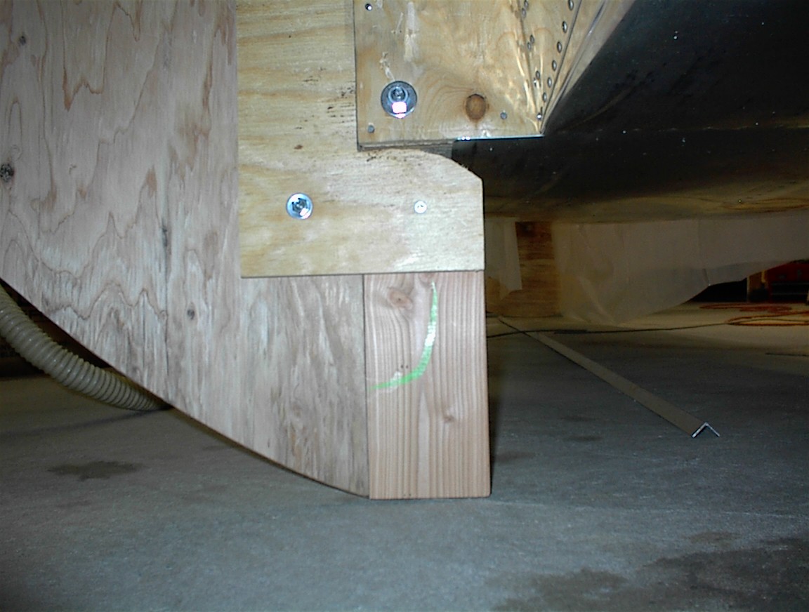

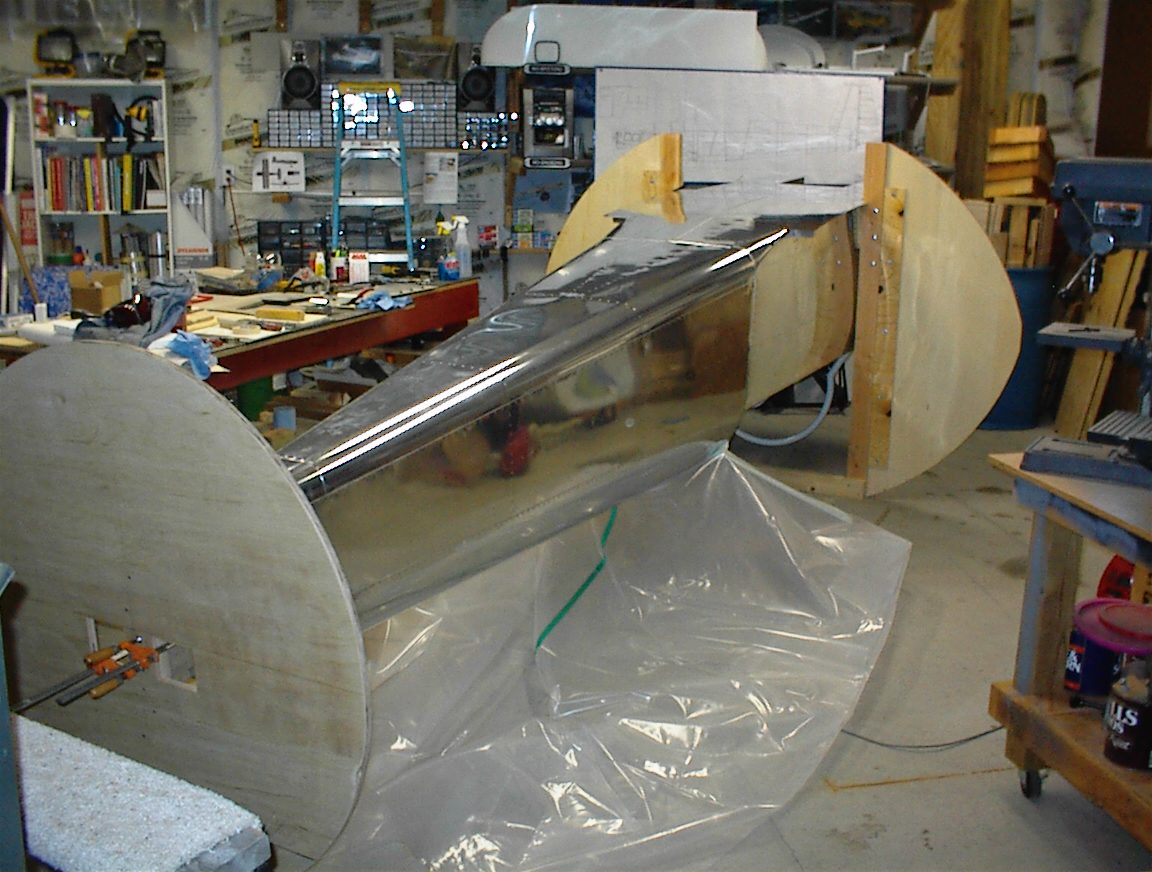

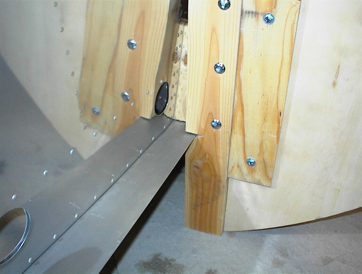

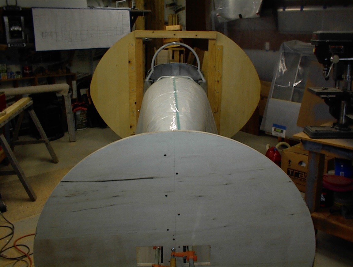

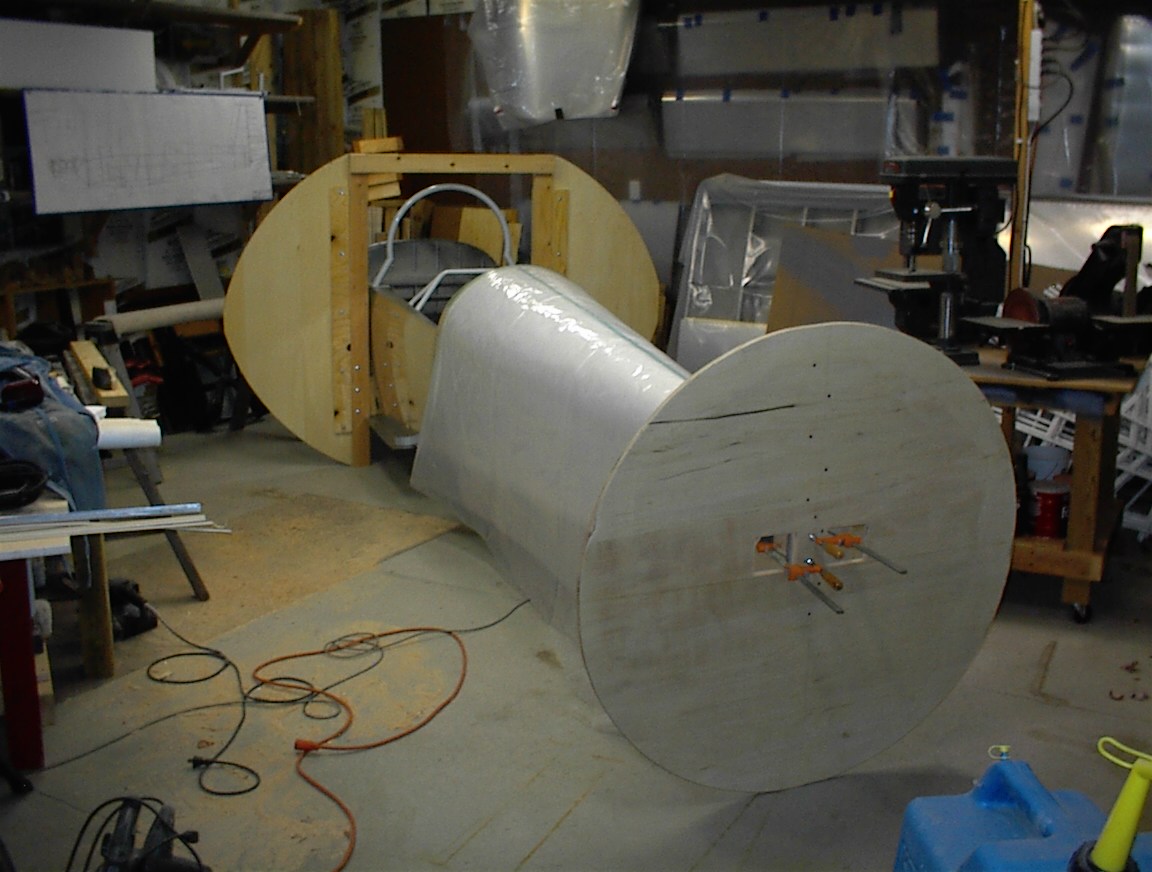

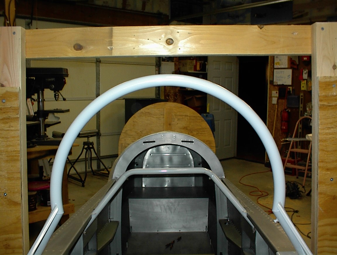

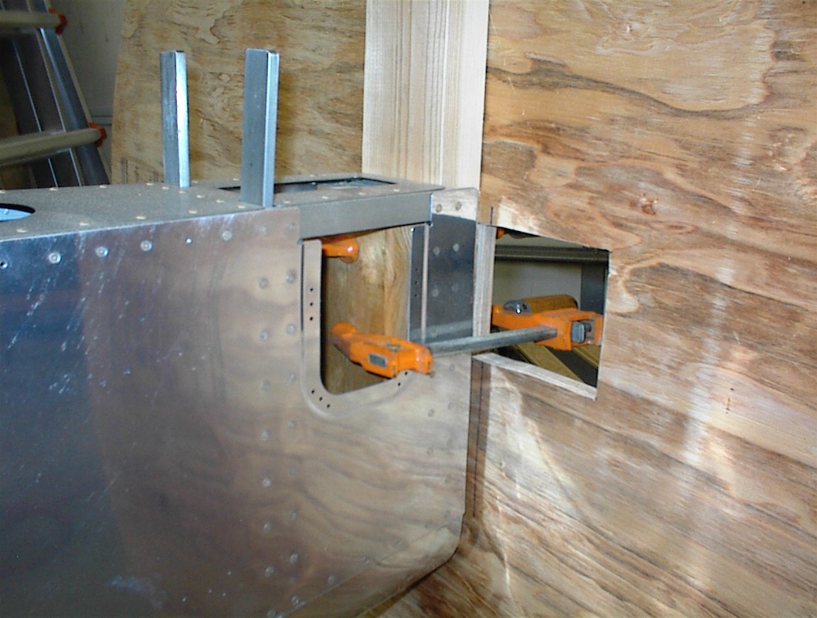

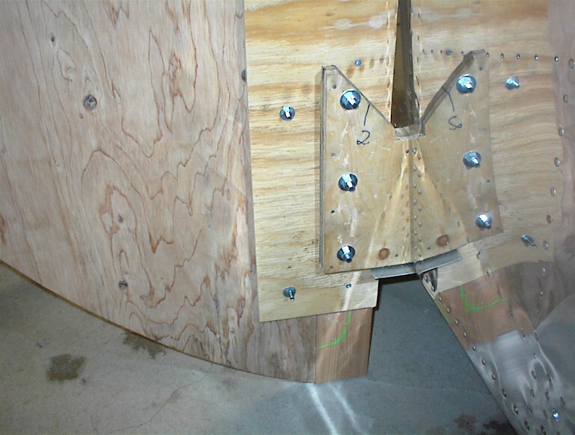

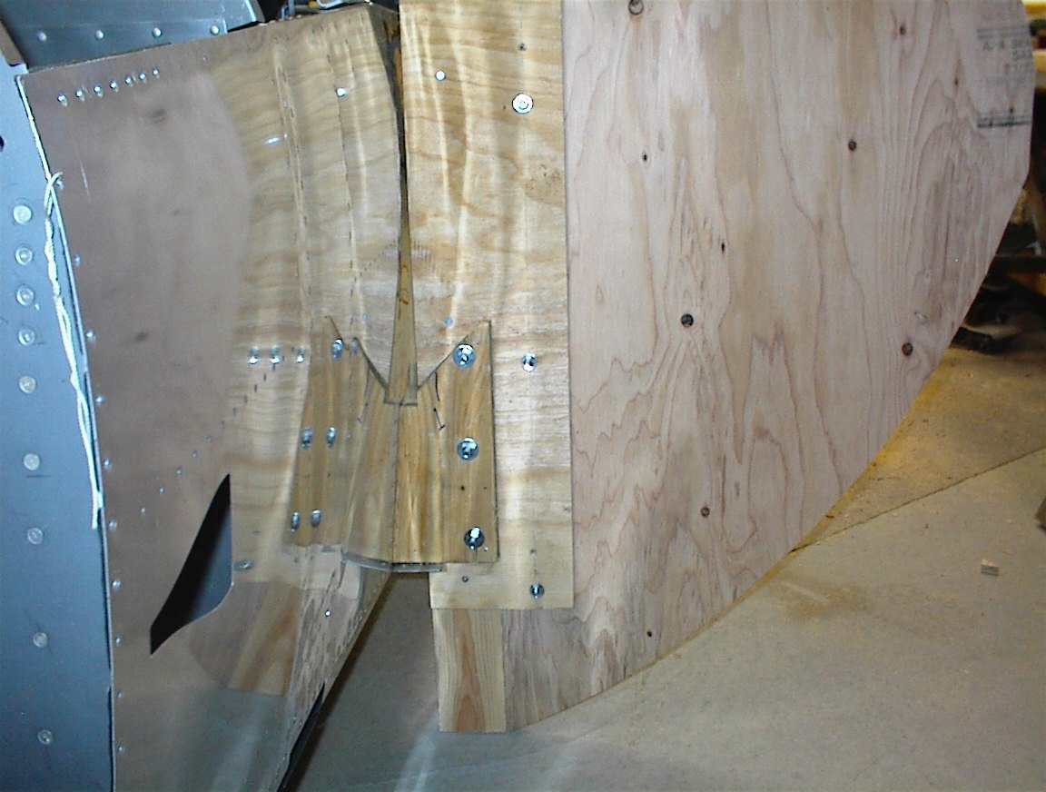

Lister Tom Garner posted some photos of this handy one-man fuselage jig from which I made mine out of plywood and 2 x 4s. When you're working on the fuselage by yourself and want to rotate the fuselage for easier access, it's a simple matter of rotating the jig. To do it "in place", simply rotate, slide, rotate some more and slide. Thanks, Tom
    011106.10_fuse_rolr_lkng_fwd.jpg Rear Looking Forward
    011106.1_upsd_dwn_fuse.jpg Upside Down - Ready For Gear Legs!
    011106.2_fuse_rolr_aft_cup.jpg Aft Attach
    011106.3_fuse_rolr_aft_cup2.jpg Aft Attach

    011106.5_fuse_rolr_rfwd.jpg Looking Rearward

    011106.7_fuse_rolr_lfwd_cup.jpg Front Cutout Detail
    011106.8_fuse_rolr_lkng_aft.jpg Overview
    011106.9_fuse_rolr_lfwd_cup.jpg Front Cutout Detail
    011116.1_fuselage_roller_lrear_qtr.jpg Left Rear Shot
