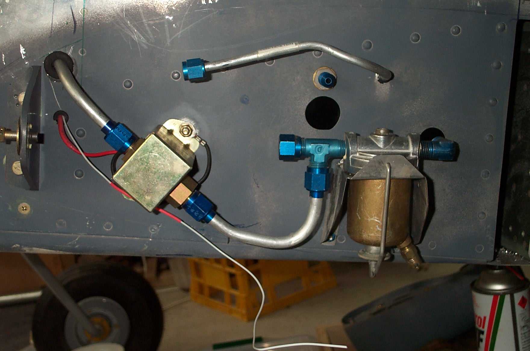

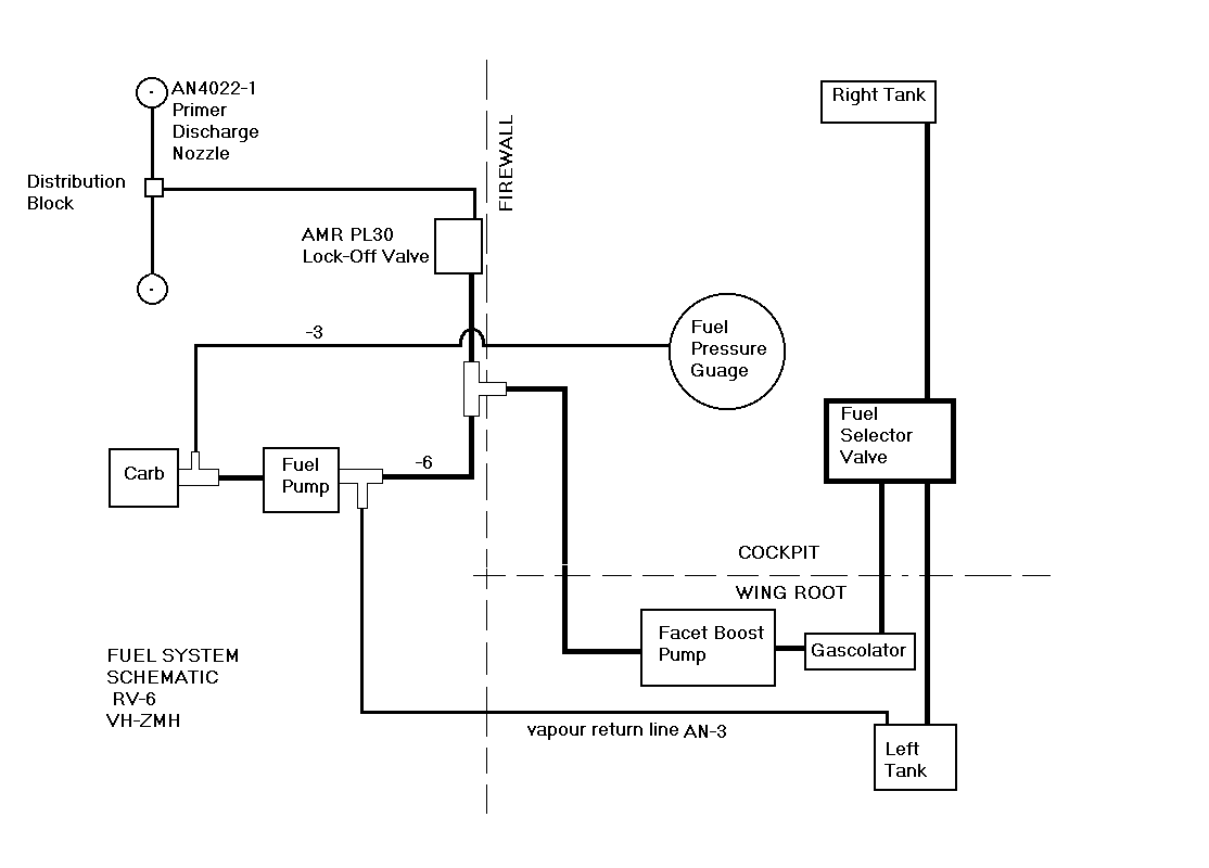

Subject: RV6 - Gasco Pump in Wing Root Description: Pic of my wing root installation of the fuel boost pump and gascolator. I have placed the pump downstream of the gascolator so that there is at least some filtering of debris before the pump. I have also included a schematic of the fuel system, which shows the basic layout and primer set-up. Martin Hone
