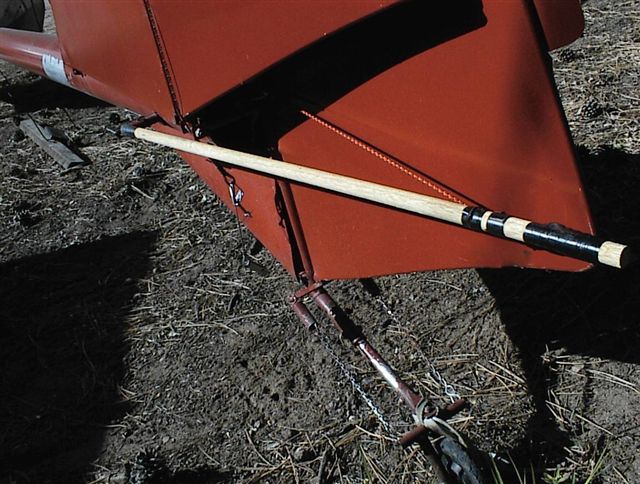

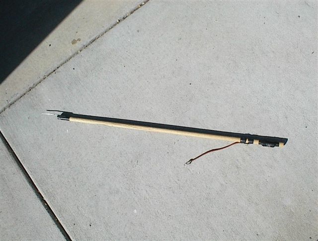

Submitted By: pelletier@cableone.net Email List: Kolb-List,Ultralight-List Name: Dave Pelletier (AzDave)
Date: Apr 24 2004
Subject: Wing Fold Pins Description: The pins stick out about four inches. The back end of eaqch pin is bent 90 degrees and goes into a small hole drilled into the side of the dowell and held in by tape. The bungee cord at the other end is the "Keeper" which keeps the pin in place while traveling. It hooks to the rudder tang. The bungee is held in place in the same way as the pin, a 90 degree bend inserted into a small hole and taped in. Close to the butt end of the dowell is a small piece of foam rubber taped so that it pads the dowell to keep it from damaging the rudder if it hits it during travel.
MKBuild1_009.jpg Wing Fold Pin MKBuild1_010.jpg Inserted - Wing Removed
