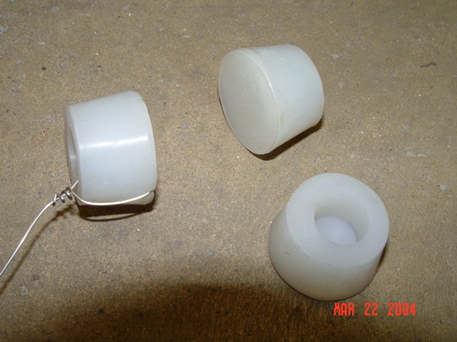

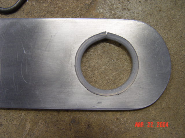

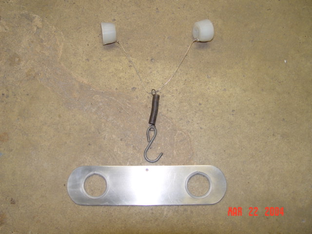

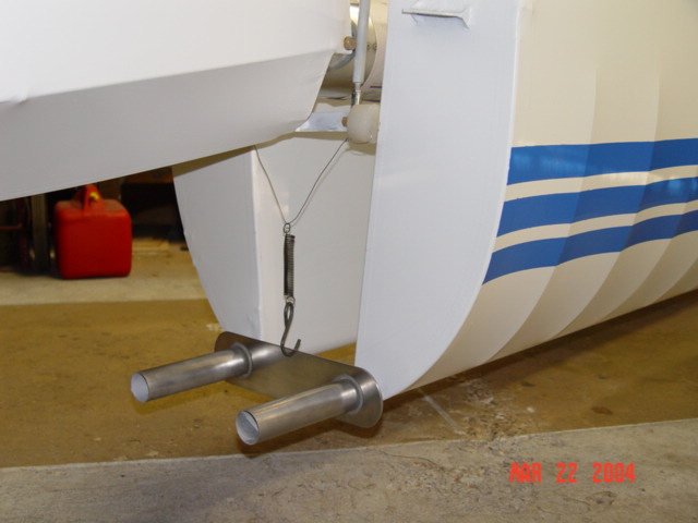

Subject: Kolb Wing Fold Bracket Description: Here are some wing fold brackets that I made for the leading edge tube. It keeps the wing from flopping side to side... The aileron control linkage will hit the wing, so I put some neoprene caps over them and with some safety wire and a spring, I tried to keep it simple and easy just to get the plane there in good condition.
