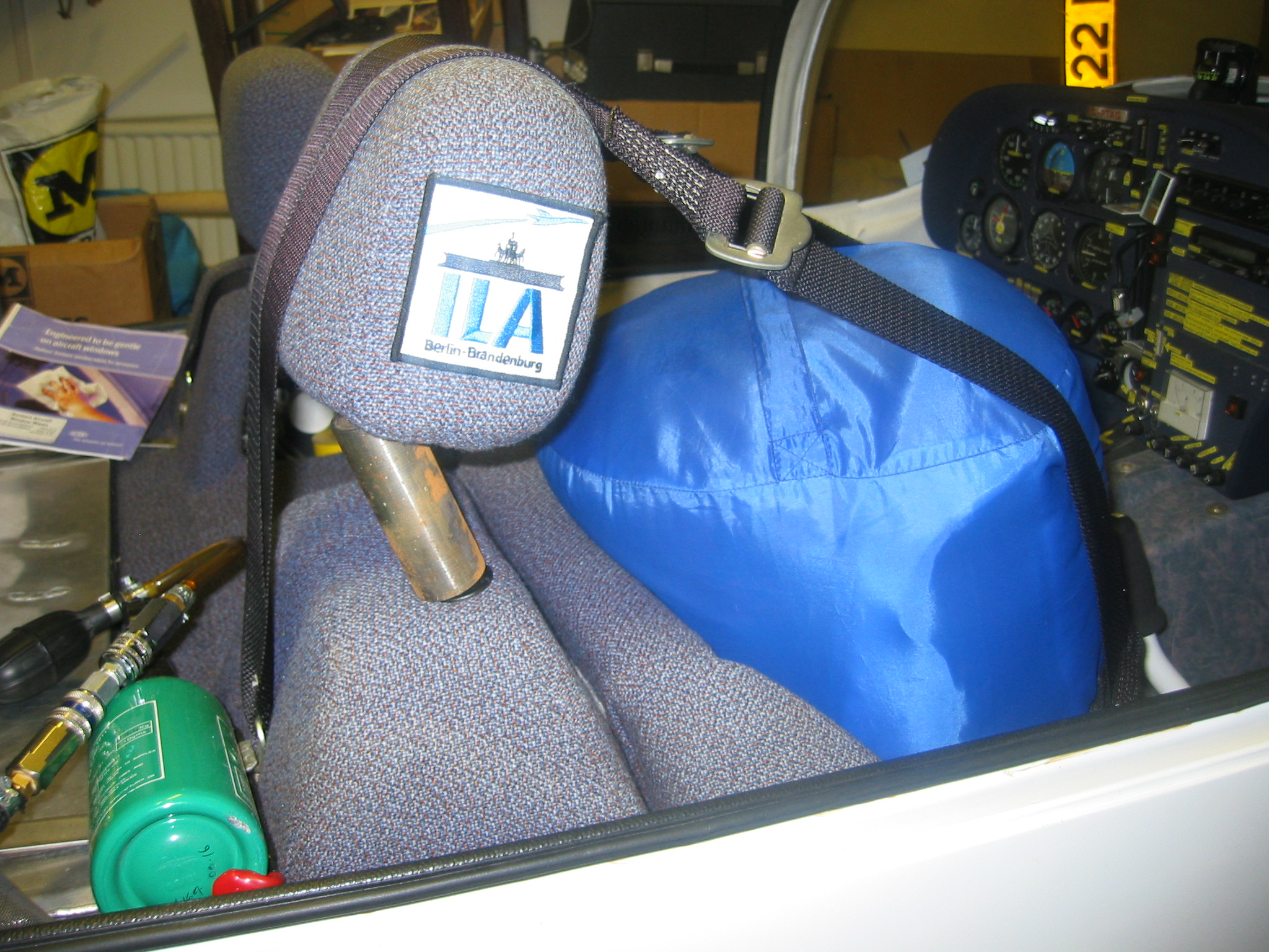

a) 3364 Existing BMW adjustable height head rest assembly in G-PTAG.(starboard side)

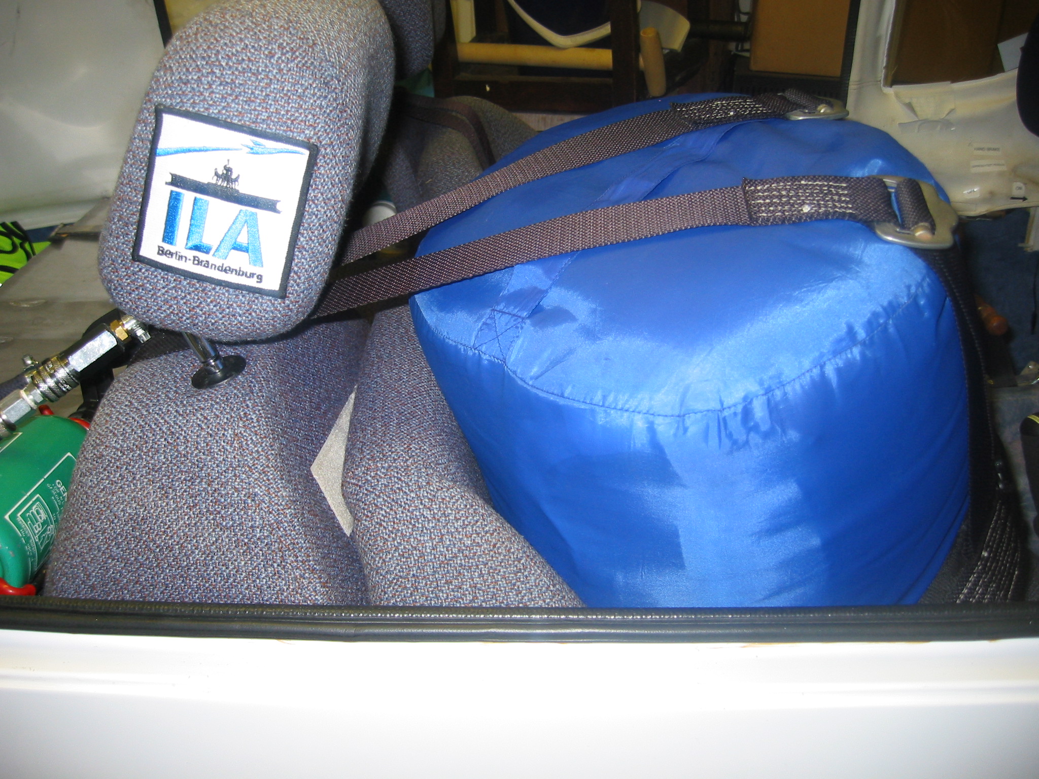

b) 3362 View from front starboard side of P2 Position of re-routed harness. (note the provisional spacer showing how the head rest could be prevented from telescoping down.)

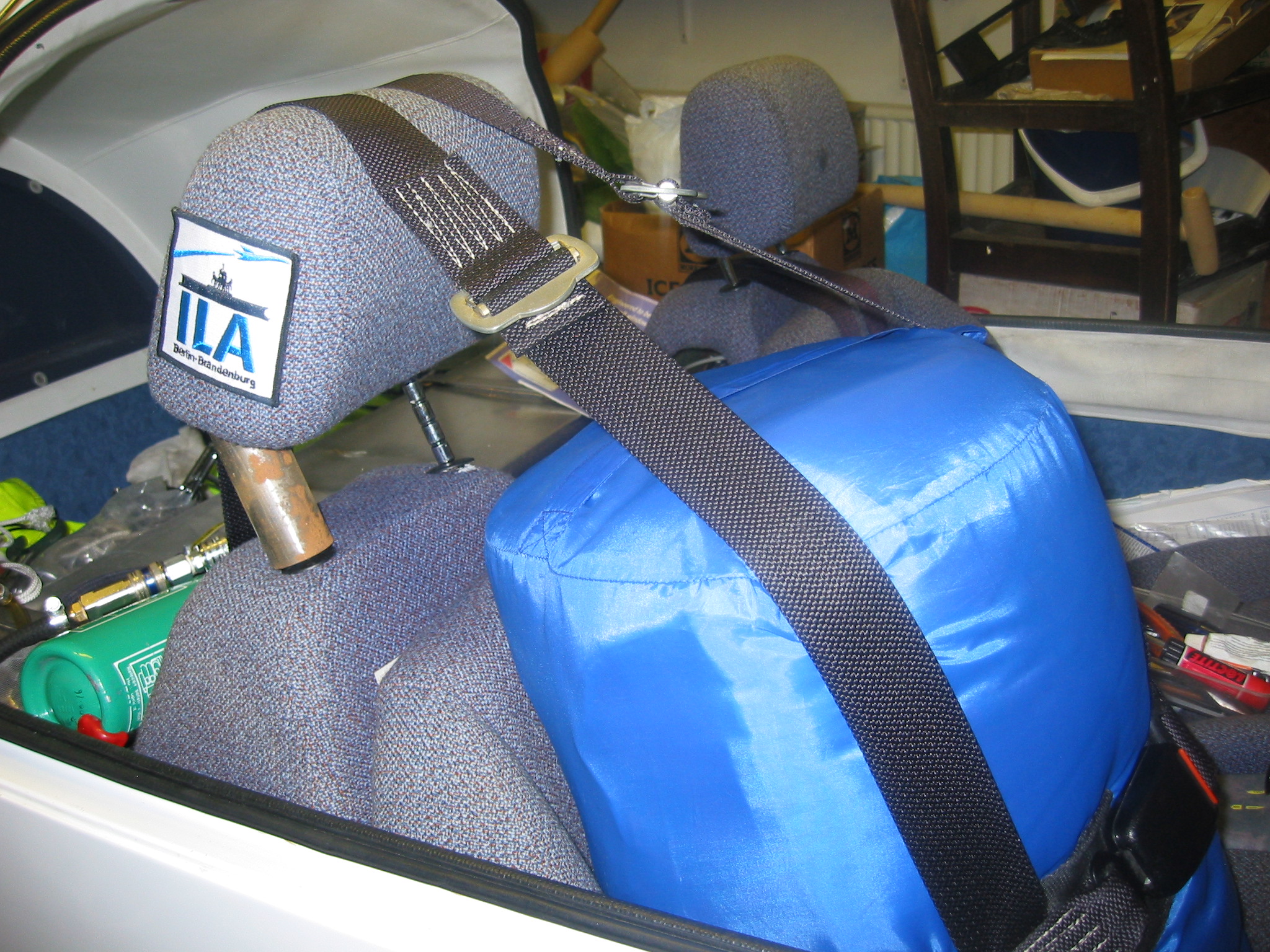

c) 3363 View from rear starboard side of P2 Position of re-routed harness. (see the crude spacer needed on both sides to prevent head rest telescoping down.)

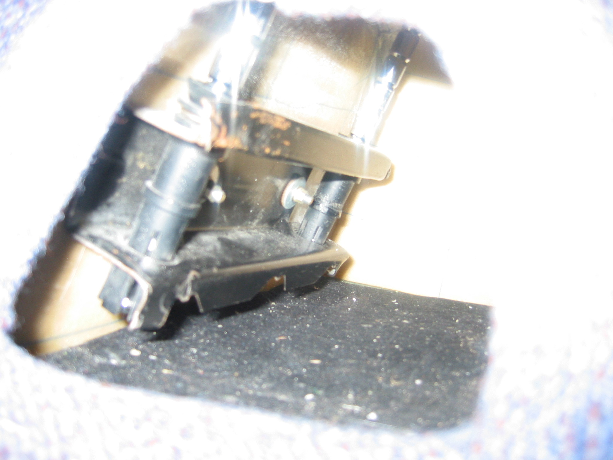

d) 3365 View of the existing inside of the starboard Europa HEAD REST showing the BMW adjustment slide fixing tubes Hopefully you can put these on the Picture Share page for other builder/flyers to discuss.
