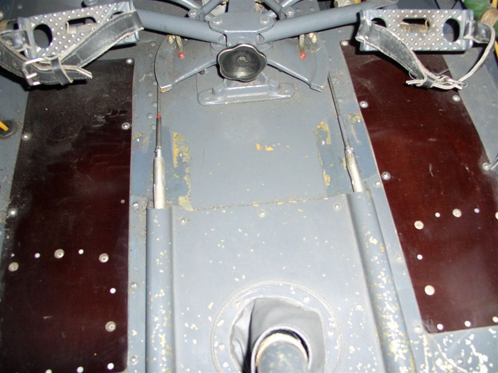

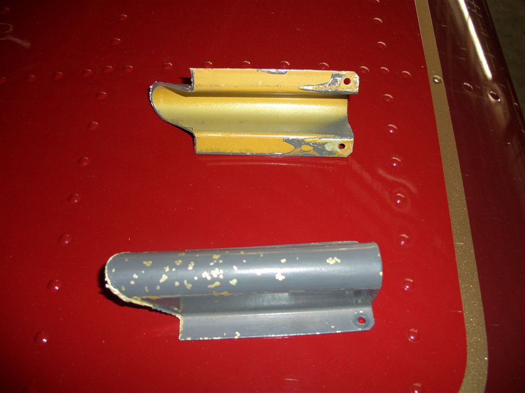

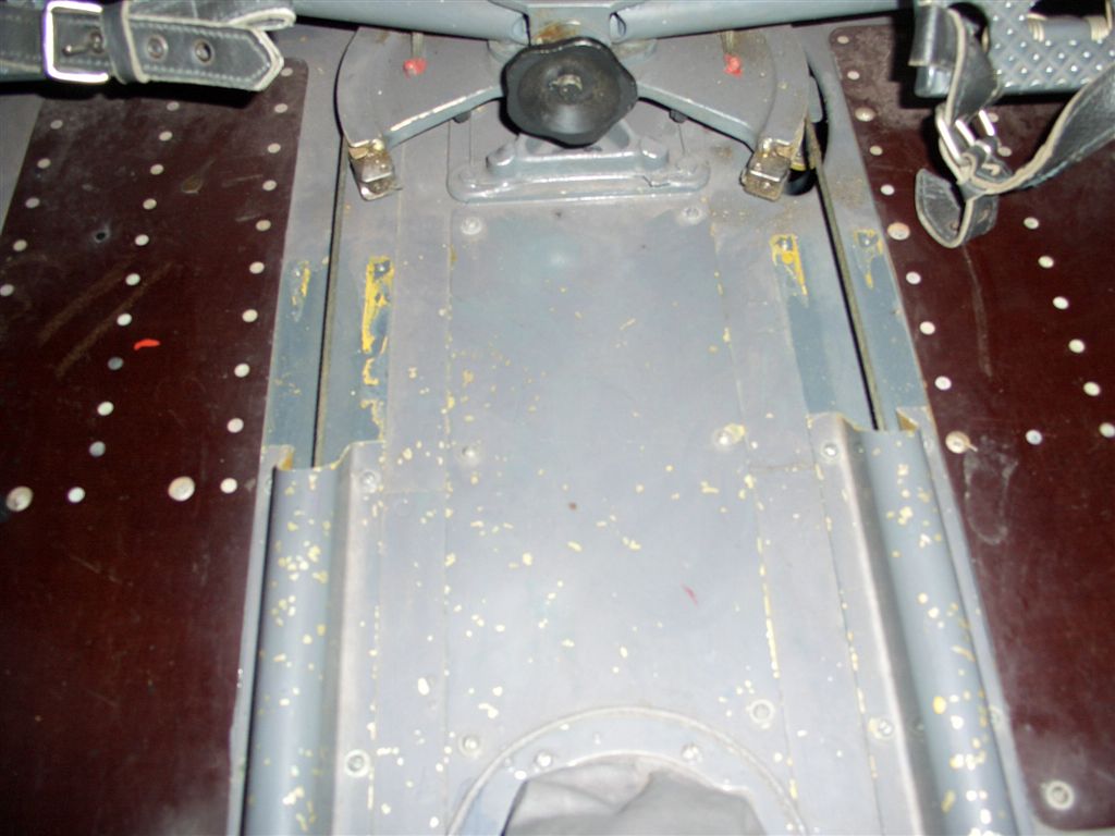

Subject: 3 pictures-Yak-52 tunnels Description: These pics show the floor of my '93 Yak after modifying the tunnels. Note in #1 (front cockpit) you need to angle the cut to keep a screw at the top end of the floor plate. #2 shows the rear cockpit difference. #3 shows what is cut off the rear tunnels. All cuts need to be on a 45deg angle to keep things smooth.
