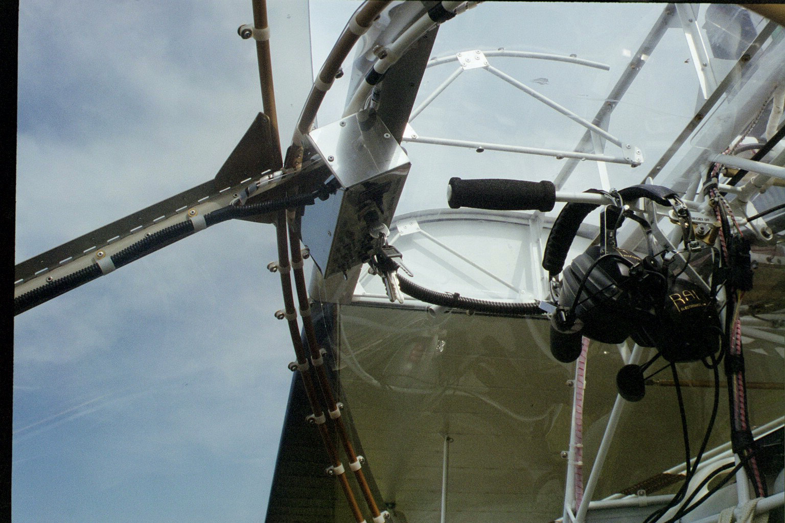

    IMG02.jpg This is photo is looking up from the left side of the aircraft at the overhead switchbox. The box contains the ignition keyswitch, the kill switch, and four accessory switches and circuit breakers. It is formed out of bright anneal stainless steel sheet. Very easy to see and reach in flight.

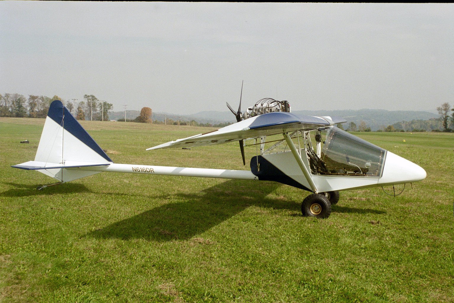

    IMG13.jpg This view shows the Gull doors and tapered lexan rear enclosure. The 800-6 tires combine with my lower than stock tailwheel fork to put the Mk-3 in a little better attitude for landing than the flatter stock attitude.
