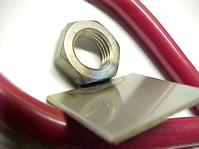

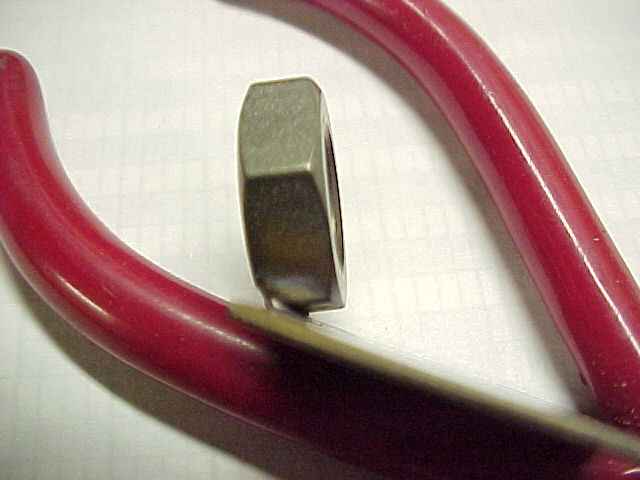

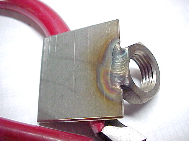

Subject: Manual trim cable mount Description: This is the part that mounts the manual trim cable sheath to the inside of the elevator. It came with my manual trim kit for my RV-9A. The description in the pick list indicates it is also used on the 4 and 6. I expect it is also used on the 7. Not sure about the 8. You can see where it is welded only on one corner of the nut. If this breaks, you will lose control of the pitch trim. This reportedly has happened inflight in at least one case.
