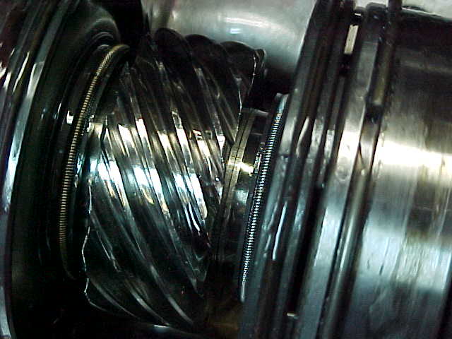

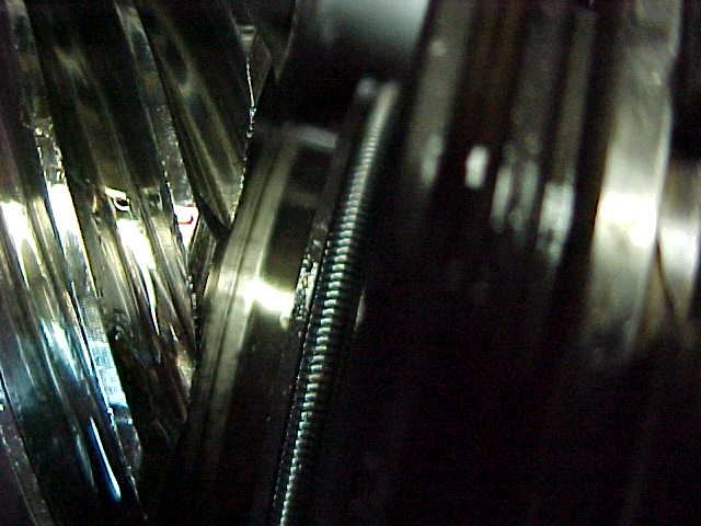

Subject: 532 crank gear slippage Description: Here are the pictures of the crankshaft gear that turns the rotary valve on a 532/582. The gear slipped to the left about 1/16" and turned on the crank, causing the intake rotary valve to get out of timing. The engine would run at about 60% power, and be very baffling to troubleshoot.
