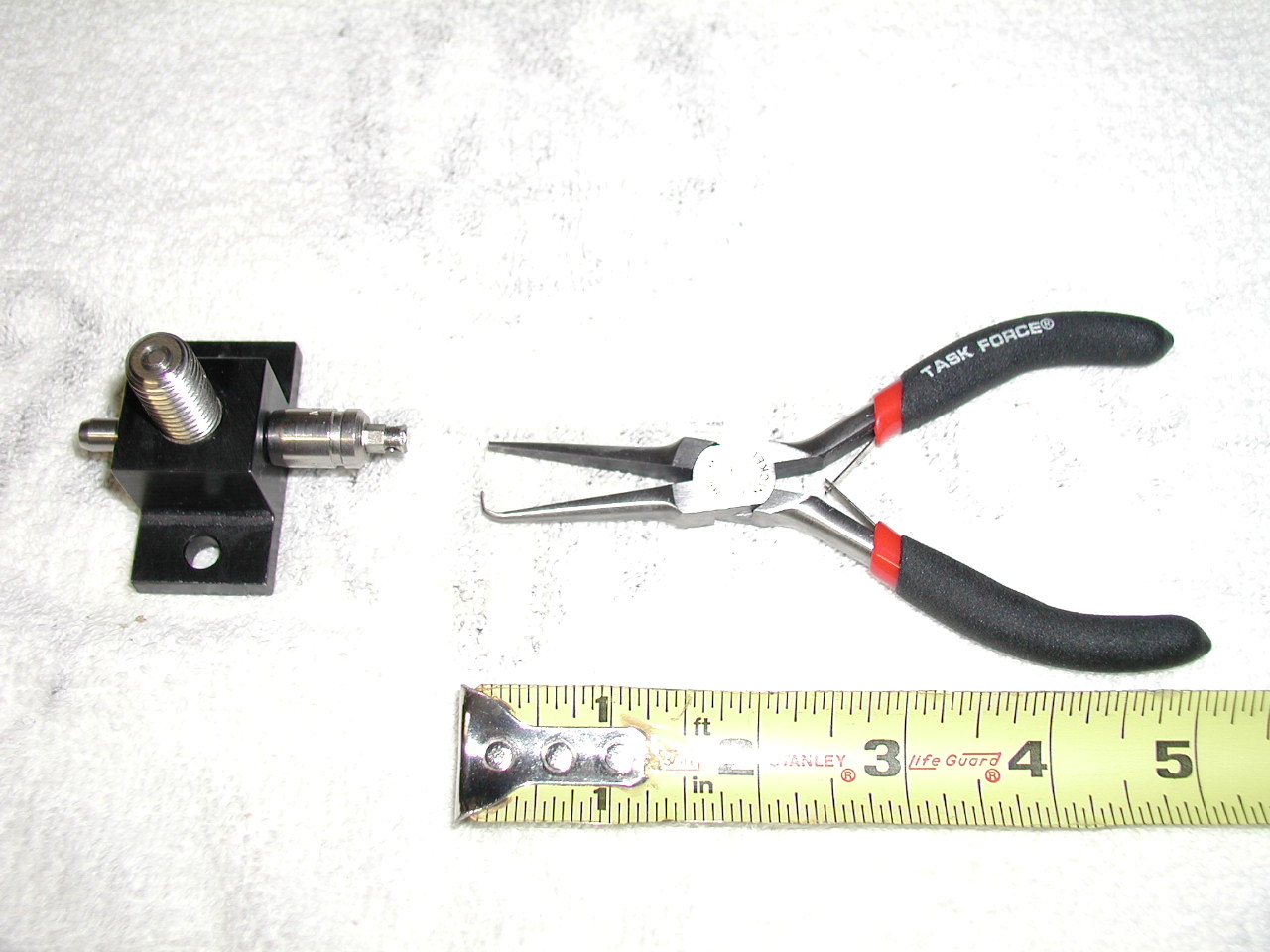

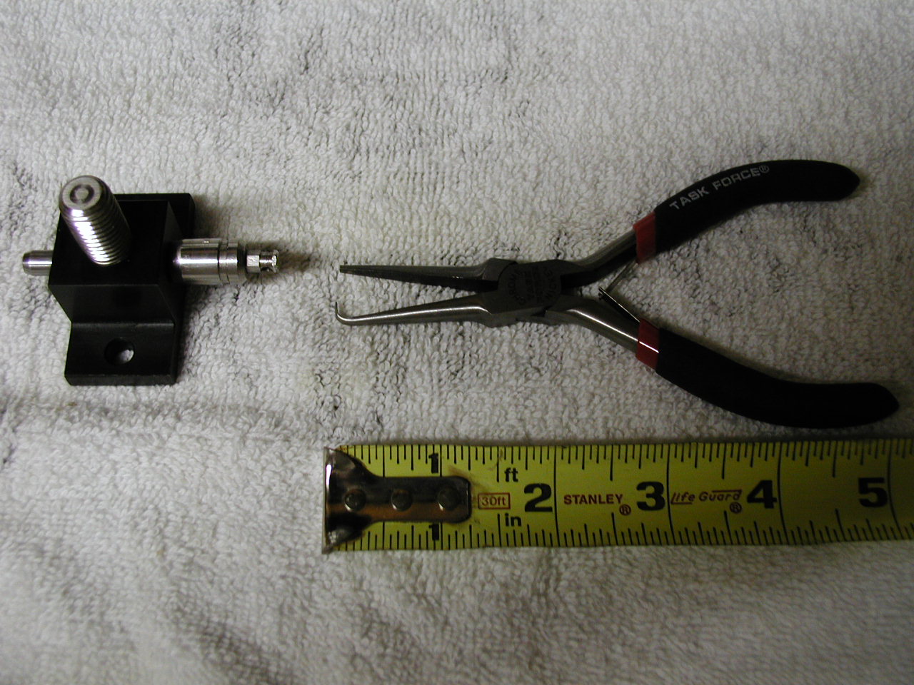

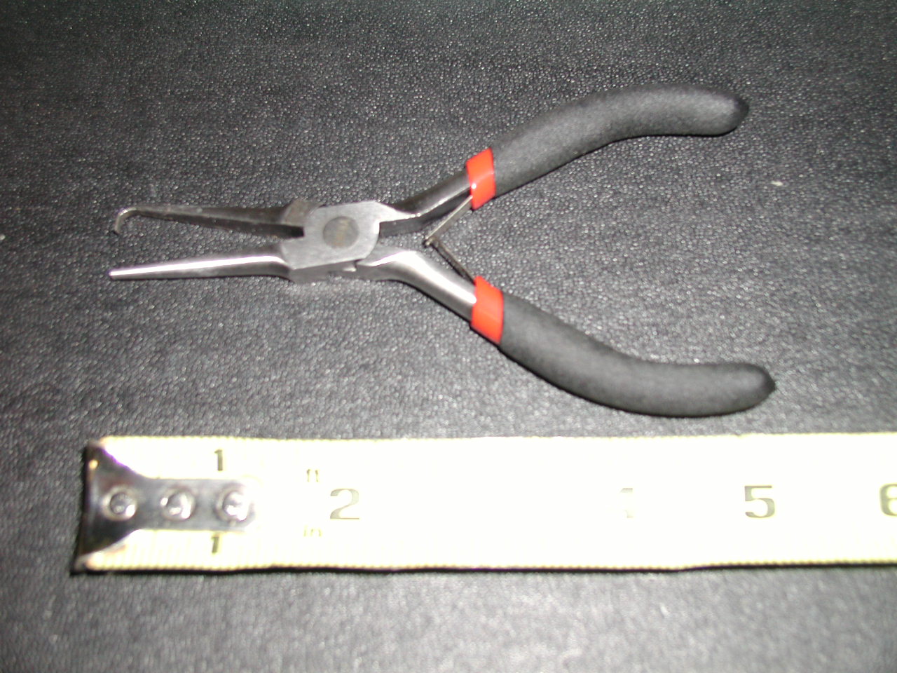

Subject: Wing Pin Puller Description: This is a modified set of needle nose pliers that I modified by bending the end on one side to 90 degrees and ground down the other side to the correct length. The puller works great both as a puller and inserter.
