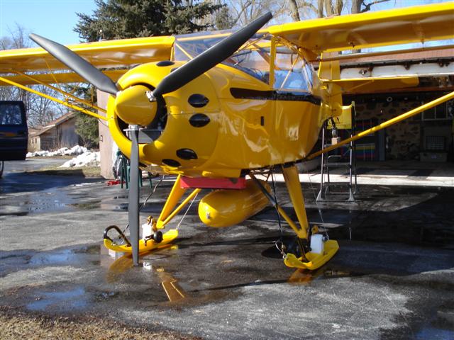

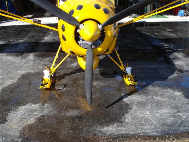

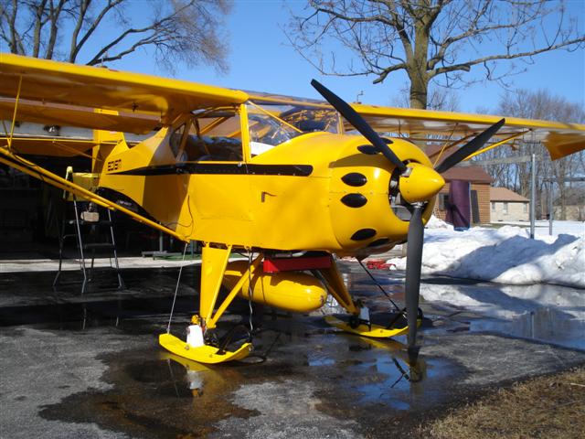

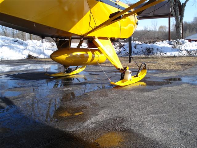

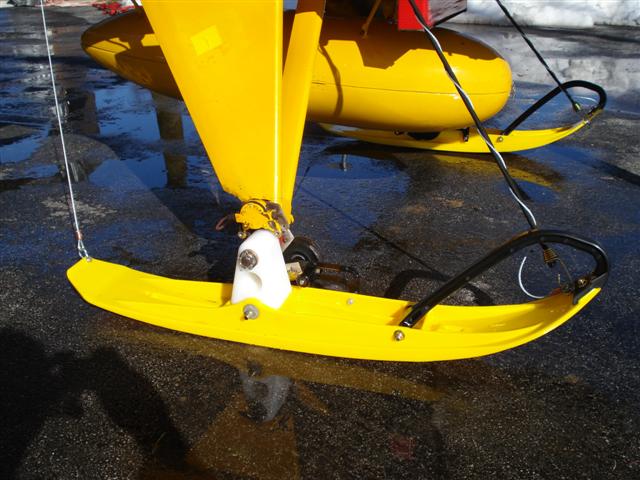

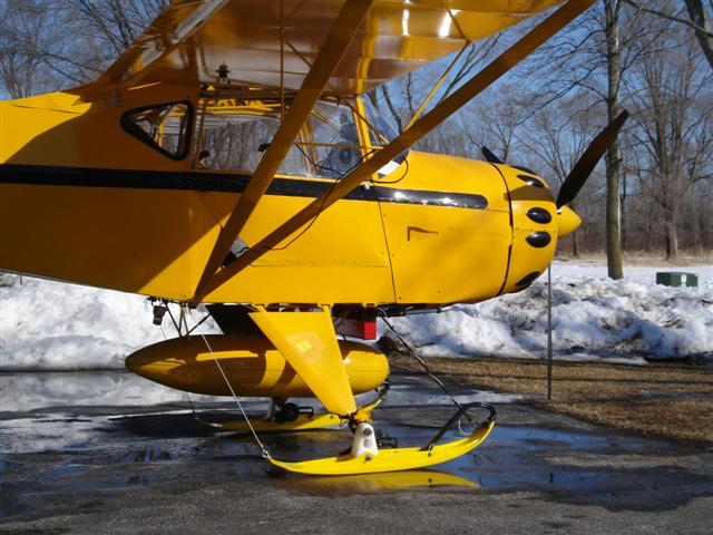

Subject: Model 3/4 Snow Ski Mounting Description: Several views of my snow ski mount with the ReTrax wheels. Enables me to move the airplane around on the hard surface a bit easier. Small wheels retract and stay on the ski permanently. The whole assembly with plastic skis doesn't weigh any more than the tire, rim and brake rotor assembly. The ski is a standard Polaris part number.
