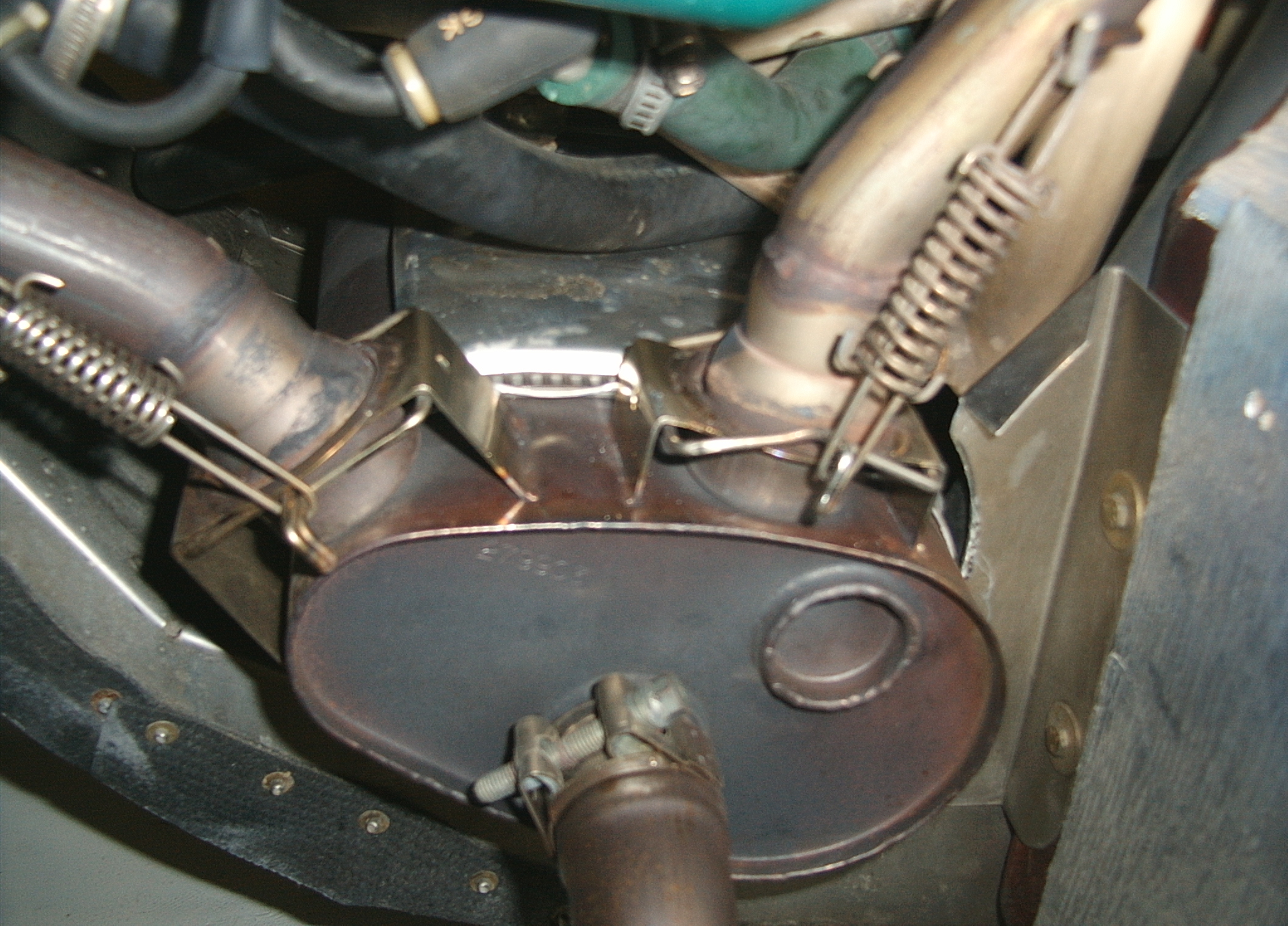

Subject: Aft Muffler Springhinges Description: Please find enclosed a picture of the aft springhinges of the muffler bending upwards allowing the exhaust to leak enough exhaust fumes to make my CO warner go wild in the cockpit.
During an inspection of the engine it was noted that the LH backside spring attachment of the exhaust to the pipe was bent upwards, allowing engine fumes to pass and trigger the alert. Please find enclosed a pictures of my exhaust system, showing the difference between the forward and aft springhinges. Part total time is 42 hours.
Andy Drapers reports he has never seen anything like this before, anyone of you perhaps did!?
