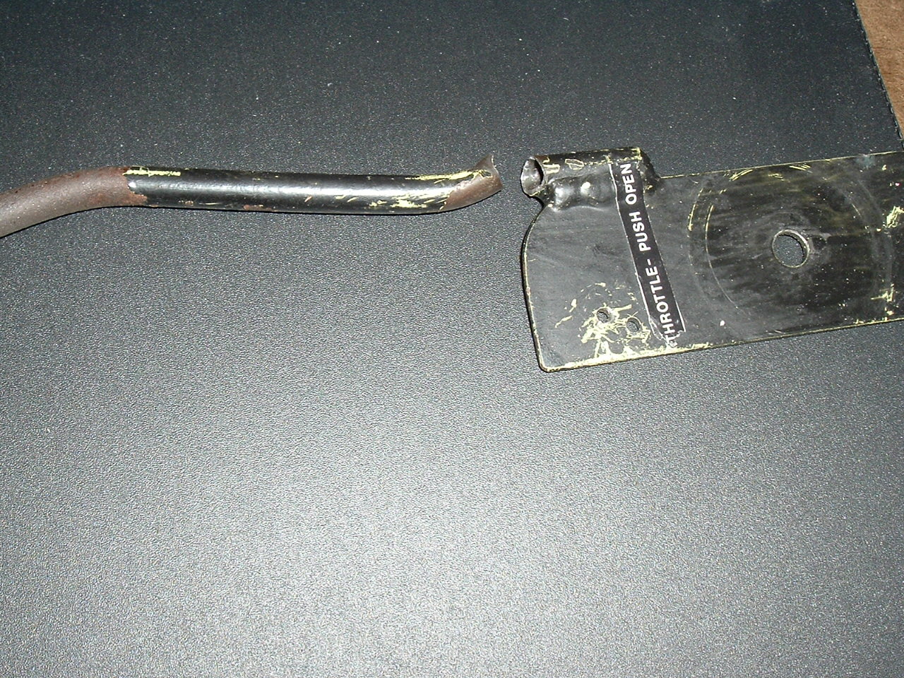

Subject: Broken Throttle Lever on Firestar II Description: After 460 hours of use, the throttle lever broke on my Firestar II. This picture of the break shows the location so others might be able to inspect the similar location on their installation for signs of developing weakness.
07-09-23_006.jpg Broken throttle Lever on Firestar II after 460 hours
