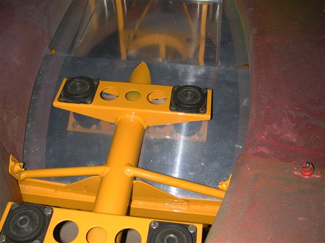

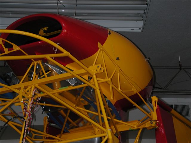

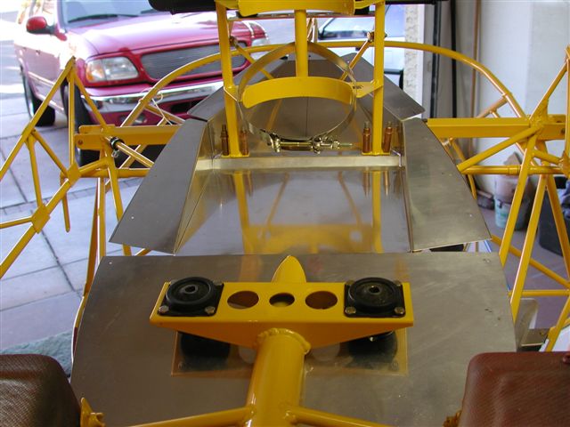

I know that with the wider windshield there has to be a low pressure in front of it, should make a difference in the pressure in the cockpit. Here's some picks of the fire wall in the works. Made of .o16 2024 alclad. It seals the engine compartment from the cabin. I'm going to put 1/4 in insulation over it to help reduce engine noise. This fire wall will make all the air that enters the cowling exit at the rear of the cowling rather than flowing into the cabin where a low pressure may exist improving cooling.
