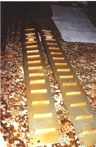

Primed main spars W-606A, assembled and rivetted R spar (1/8" rivets),
assembled L spar for rivetting (1/8" rivets)    |
8 |
| 27 |
Bolted R spar together.   |
3 |
| 28 |
Drilled through tight rivet holes R spar, disassembled, deburred, reassembled.    |
4 |

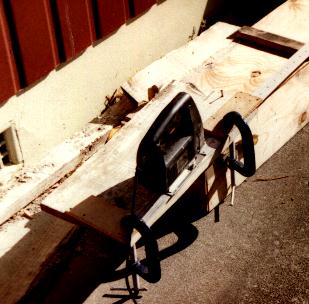

Cut out W-607Ds and FL-607B??s from 1/8" plate with jigsaw. Practised
driving 3/16" rivets -- rivet gun & 3lb hammer. |
3 |

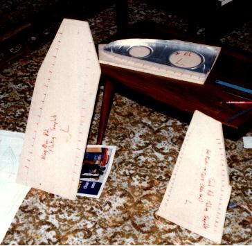

Drove 20 3/16" rivets. Cut rib reinforcement angles.Made fluting templates.
Fluted R Wing ribs.   |
8 |

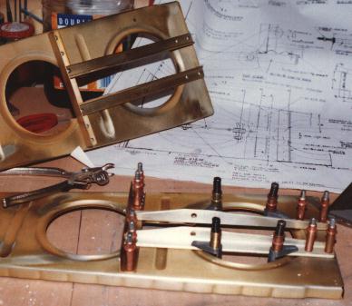

Deburred remaining tank ribs. Drilled & deburred most holes in
tank ribs. Made bellcrank spacers, drilled bellcrank parts.   |
7 |
| 10 |
Drilled & deburred 7/16" holes in tank ribs. Marked lightening
hole positions in flap spars & braces. Marked flange centrelines on
flap spars & ribs.  |
3 |
| 11 |
Pilot-drilled lightening holes. Drilled flap spars to bottom skins.
Drilled L hinge to spar. Squared L rib flanges, adjusted L spar flange.  |

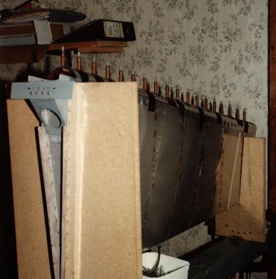

Squeezed TE of both ailerons.
 Squeezed TE of R elevator. Set up elevator jig, drilled elevator skin
to skeleton, deburred, dimpled.  |
 5 |
| 08 |
Rivetted R elevator skin to skeleton. |
