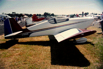

N790DW on the display line at the '94 Portland Rose Festival Airshow in Hillsboro, OR. Bill Benedict's RV-4 and the RV-6T in the background.
Photo courtesy of Joe Miller

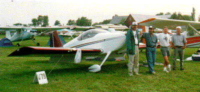

N790DW in showplane camping at Oshkosh 94. From left to right Rion, Doug, Don, and Dan. .
