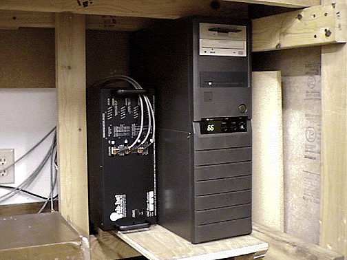

The AhHa! CNC Controller is shown on the lefthand side. The gray cables on the front connect to each of the stepper motors on the mill. The controller will accomodate up to 4 axis - X, Y, Z, and W. I have hardware installed for 3 axis. The limit switch inputs are on the back of the controller, as well as all of the aux. I/O. The step rates for each axis are selected from the controller by way of a small DIP switch on each axis controller board. Step rates include 200, 400, 800, and 1600 steps/rev. The CNC Controller is enclosed in a very nice, all metal, 19" rack mountable case.
AhHa! provides a 16 bit ISA controller card for the PC instead of a parallel port connection. This allows them to send a greater number of steps per second as well provide a wide varity of aux. I/O. Initially, I had some problems getting the limit switch inputs to work correctly until I discovered that that I had an interrupt conflict with the sound card. Once that was resolved, everything worked fine.
I am using a 66Mhz 486 PC (circa 1993) for control. This has proved more than adequate for the CNC software. Since the CNC ISA controller board produces 1000 interrupts/sec, AhHa! strongly recommends disabling programs like EMM386 and Smartdrive, and I have found that the software does have problems with running with these installed. I have a bootable floppy disk that has just the bare system on it that I use when I'm going to use the CNC controller.
