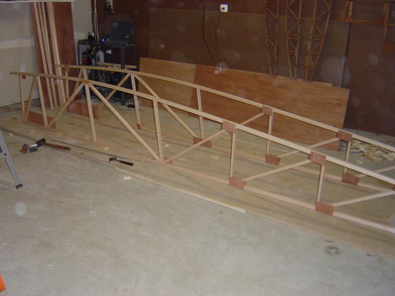

| Subject: | Cutout at tailpost, any great tips? |
I have my fuse sides done! http://www.subarubrat.com/misc/pietfuse3.jpg
And I was wondering if there is any great trick to use to cut the
"wedge" out at the tail post where they join?
-Scott

Nice shot Scott! Wow is the only thing I can say! How roughly did that take
you? just curious?=0A=0ABen=0A=0A=0A----- Original Message ----=0AFrom: Sc
ott Schreiber <got22b@SubaruBrat.com>=0ATo: pietenpol-list@matronics.com=0A
Sent: Thursday, November 23, 2006 6:02:52 PM=0ASubject: Pietenpol-List: Cut
out at tailpost, any great tips?=0A=0A=0AI have my fuse sides done! http://
www.subarubrat.com/misc/pietfuse3.jpg And I was wondering if there is any g
reat trick to use to cut the "wedge" out at the tail post where they join?

| Subject: | Re: Cutout at tailpost, any great tips? |
Scott
Thats a job that seems simple, but it's one of those technical things
that has to be done right. You will need to make a straight line on
your jig and block the fuse in place. Find the center line of all the
cross members that you have installed so far. Make sure each member
and the tail post falls exactly on the centerline. Then there are a
couple of ways to proceed. with the halves together, make a mark on
each half to rough cut with a hand plane or use a small saw. Re-fit the
halves and if they are somewhat close, use a belt from a belt sander,
cut open, 80 grit and pull it back and forth to final fit. Others may
have diffrent methods of sanding or cutting but there is no shortcut on
getting your fuse trued up straight.
Dick N.
The same is true with giant scale R/C, I am fine with the process, what
I was reffering to in specific is the actual cutting of the tail post
area. When you talking about 1/2x1/4 spruce and 1/4 by 1/4 balsa it is a
simple matter of a razor saw. I was wondering if some great method had
been worked out.
-Scott
