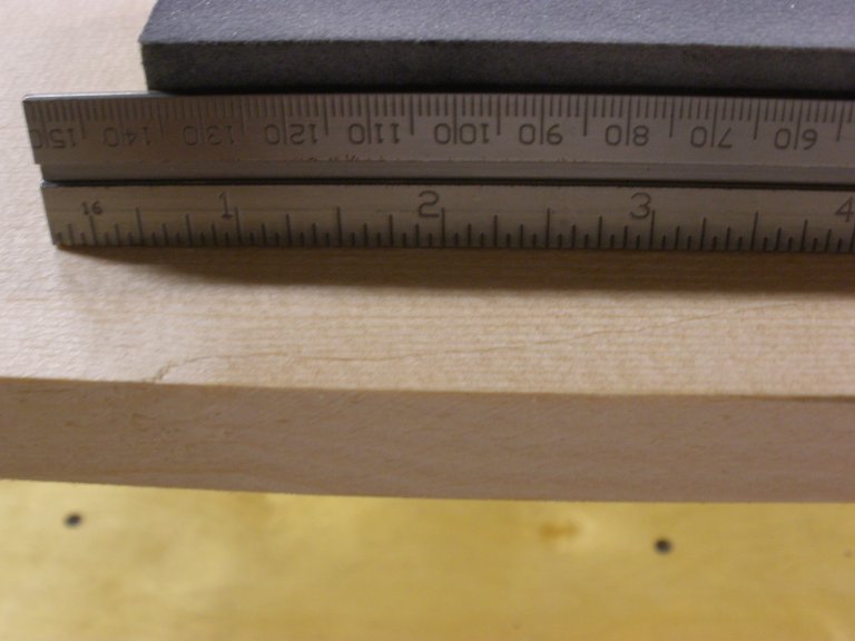

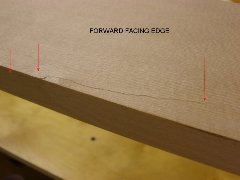

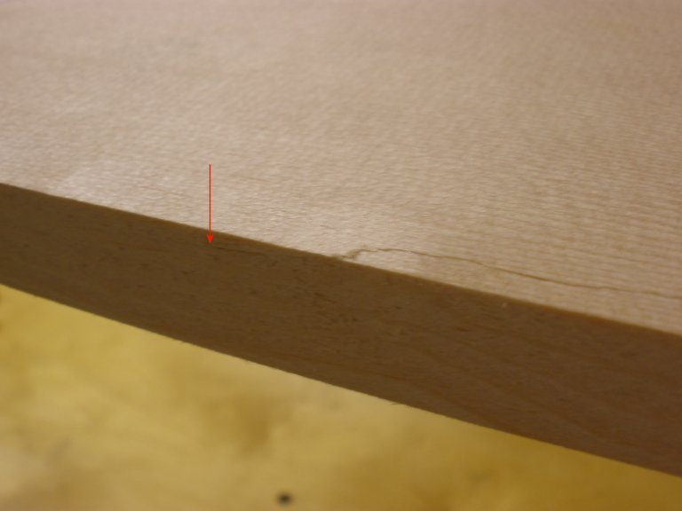

Mark, it certainly looks like a crack. With it being in the middle of the
spar, I'd be hesitant to use it. Every time you find yourself flying in
turbulence you'll be wondering if that spar will hold.
Your options are:
1. Try to determine if it is just a scratch - hopefully it is, and you can
use it without worry
2. Try to get AS&S to replace it (good luck)
3. Cut it up into smaller pieces for use elsewhere in the project. If it
is a 1" thick spar, you might be able to get some longeron material out of
it (will require scarf joints unless your spar was as long as a longeron)
One other possibility exists. If it is truly in the middle (and I'm
assuming you are making a 3-piece wing), it will fall about where the lift
struts attach. There are heavy 1/8" plywood doublers on both sides of the
spar there. If you make those doublers longer than the plans require,
spanning maybe a foot of spar on each side, and add doublers on the top and
bottom edge of the spar, it might be capable of sustaining the loads. You'd
want to run a quick stress analysis to make sure it would suffice, but my
feeling is that it would probably be okay. I'd still try option (2) first.
Jack Phillips
NX899JP
Raleigh, NC
-----Original Message-----
[mailto:owner-pietenpol-list-server@matronics.com] On Behalf Of K5YAC
Sent: Saturday, September 19, 2009 9:31 PM
Subject: Pietenpol-List: Opinions Please
I know this is a long shot, but I'm trying to decide what I am looking at.
I received my wood package from AS&S back in July, and opened it all up
shortly after. It all looked to be in good condition, although I did not
perform a thorough inspection until a few weeks ago. Everything I expected
to be there was indeed there, an I didn't notice any blemishes or damage. I
hung my spars and several ribs a few weeks ago and haven't done much since
because of the weather (rain).
Ok, ok... I'm getting to it... with a break in the weather, I went to the
hangar today to do some work and found what looks like a crack. I didn't
notice this before, but it was pretty obvious today. It actually looks lie
someone was careless with a blade (not me, I'm sure of that... was very
careful). It extends from the top or the spar, around the corner to the
front side of the spar, across the grain. I've seen damage like this when
being careless with RC model wood and the like, but I know I've been very
careful with this stuff thus far, and the only time I used a blade was to
carefully remove the tape from the bundles. I placed the spar on the edge
of my work bench (scratch down) and applied pressure with my hand. The
scratch didn't seem to expand or open under pressure (notice I am calling it
a scratch now).
Anyhow, I wonder if it is just a scratch that wasn't very noticeable a few
weeks ago, but after a couple weeks of rain and humidity at looks worse than
it is. I can't tell for sure, and I'm sure that it is difficult to know by
looking at photos, but...
Opinions? Tips? Suggestions? Anything telling, like split against the
grain, etc? It looks like it may just be a shallow scratch that I may be
able to remove with light sanding, but it is hard to tell for sure, and I
hate to destroy the evidence before I get some expert eyes on the subject.
Thanks for looking.

Definitely looks like a crack. I would not use it for a spar as that
crack would probably just get bigger and bigger until it split off. If
they won't replace it you might be able to cut it out and splice it or
use it someplace else. It probably was a very tiny crack to begin with
and the variation in humidity and temps have already cracked it further.
It will just continue cracking unless you repair it.
Rodney

> the bundles. I placed the spar on the edge of my work bench (scratch
> down) and applied pressure with my hand. The scratch didn't seem to
> expand or open under pressure (notice I am calling it a scratch now).
> few weeks ago, but after a couple weeks of rain and humidity at looks
> worse than it is. I can't tell for sure, and I'm sure that it is
> difficult to know by looking at photos, but...
> the grain, etc? It looks like it may just be a shallow scratch that I
> may be able to remove with light sanding, but it is hard to tell for
> sure, and I hate to destroy the evidence before I get some expert eyes
> on the subject.
> Thanks for looking.
> Mark - working on wings
> http://forums.matronics.com/viewtopic.php?p=263901#263901
> http://forums.matronics.com//files/p9190051r_624.jpg
> http://forums.matronics.com//files/p9190052r_120.jpg
> http://forums.matronics.com//files/p9190053r_345.jpg
> http://forums.matronics.com//files/p9190054r_922.jpg
> http://forums.matronics.com//files/p9190060r_303.jpg
> http://forums.matronics.com//files/p9190064r_195.jpg

It sure looks like a crack to me. Being in the center of the spar, that
looks to be the are of highest stress, even with the doublers. I'd try
for a replacement first. Otherwise as others have mentioned, every time
you hit some turbulence, or occasionally at 02:00 AM it will cause an
anxiety attack. Its really a shame because it looks like an otherwise
beautiful board. As Jack mentioned, I'm sure you could find other
places to use it such as longerons. If Aircraft Spruce will replace it
I doubt they will want it back.
>Your options are:
>a scratch now).
>Thanks for looking.

My suspicions are being confirmed. I know it is hard to tell for sure, but since
there is no way of knowing the extent of the damage (short of an MRI) I am
inclined to replace it, one way or another.
I am fortunate to have Roger White and other knowledgeable folks in my chapter...
I may ask a couple of them to stop by before the meeting tomorrow night and
have a look, just as a last ditch effort at ideas and suggestions. Ahem! Jim,
I said meeting tomorrow night. Ha ha! I know, it's a long drive.
I appreciate the input. I'll certainly be offering the photos to AS&S for consideration
and their recommendation. Meanwhile, I'll grab one of the spars intended
for the other wing panel and press on. Hopefully I'll have a replacement
in the shop before I need to frame up the other half.

I concur, it looks like a crack to me.- Possibly caused during the planin
g of the edge, by a jointer.- I have done that on cabinets by feeding the
wood with too much speed,(or a dull cutting knife)-the blade catches the
grain and splits it.- Send it back, or use it elsewhere in the airframe.
- As long as the crack is not in pieces cut from it it will be fine for u
se in the tail etc.
Shad

| Subject: | Re: Opinions Please |
I was back at the hangar today making wood shavings when along came our resident
A&P/IA to take a look at my spar. I spoke to him about it yesterday, so he
brought a bright light and a magnifying lens. No doubt about it, it is cracked.
He advised me not to use the spar and said that he would back me up with AS&S
if they don't seem open to helping me replace it.
Shad, he too thought that it looked like damage caused during the planing process.
The spar also has a slight bend to it, centering right about the area of
the fracture. It really isn't too noticeable at a glance, and I may have just
thought that it was sagging under it's own weight a bit when on the wing jig,
but we turned it over and it was still there (sagging upward). It is very slight,
but noticeable when looking down the length.
Clif, you too are correct in stating that the crack goes further to the left than
I originally indicated. I didn't notice it yesterday, but we followed it along
the grain for several inches. Good eye to catch that in the photo.

Mark, one other option, and not one to consider until all other options have
been expended, would it be possible to cut out the damage and scarf the
remaining good parts to make a serviceable spar? No one wants this in a new
build, only as a repair, but as Jack pointed out, the splice might be in the
general location of the lift strut ply face plates and not be that difficult
a repair. Of course this is taking into account that you had the foresight
to order your spar blanks somewhat longer than required. However it works
out, I wish you the best outcome possible. This is a reality check big
Yes, the spars did come in a bit oversize (14'), but I've already already cut this
one (and another one) to 13' 5", which is what I needed.
No, I'm not really interested in making splices and such... I am building a new
airplane, I paid for new materials and one way or another I intend to use a good,
non-repaired spar.
I will be paying very close attention to the rest of the parts. I hate this feeling
of uncertainty. Reality check indeed.

Looks a little weird, the stress line cuts across
the growth rings, I would have to ask for a refund
and as far as a splice I would trust a proper splice
more than the flaw, this may have happened when the tree was cut down it was
tortured a few minutes
as the tree was coming down and hitting the ground.
I've heard of this before.
The grouth rings seem well with in the 1 to 16 run
out tolerance.
Ask that they send you a new spar maybe you can
use the rest for not as critical parts.
Russell
