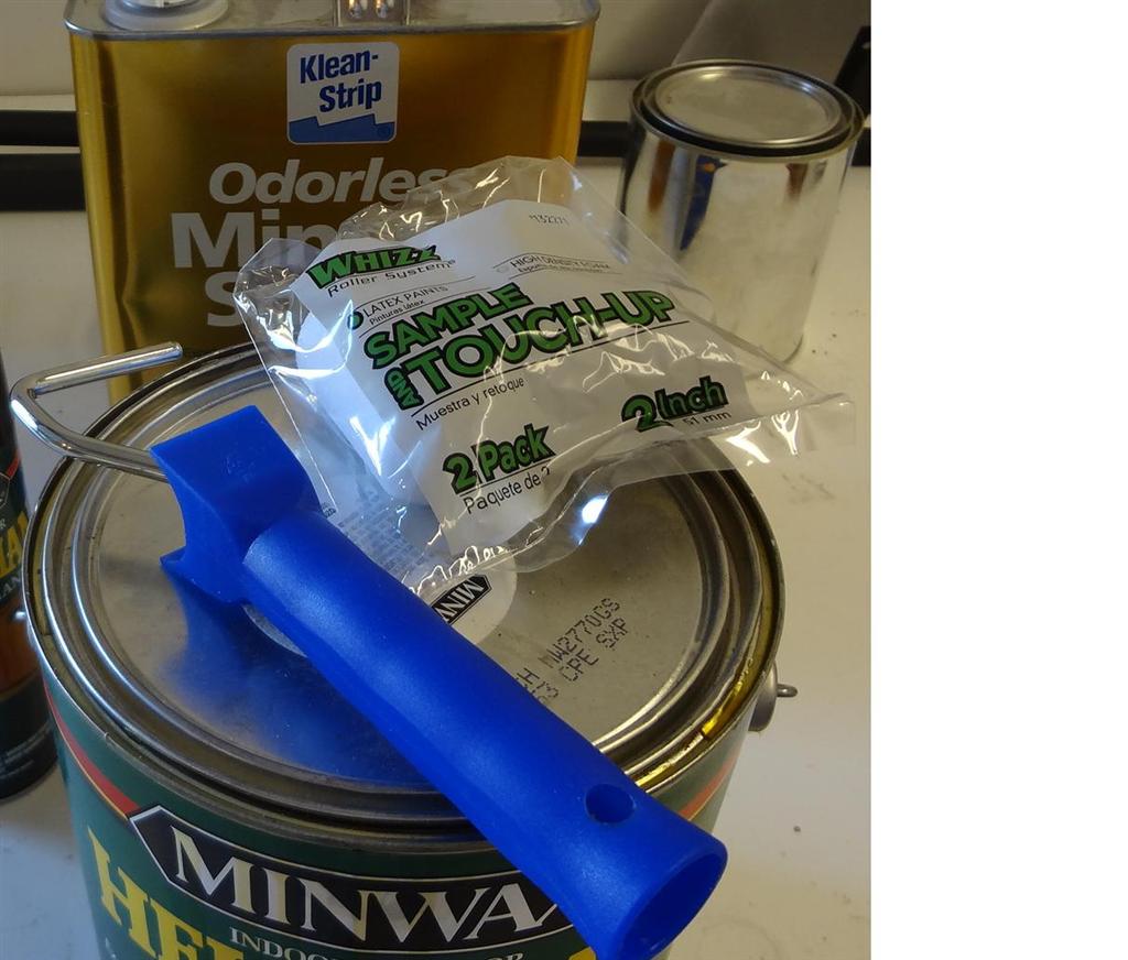

      The special love affair with varnish was more a fools errand than anything else,
      having spent too many hours looking at yacht interiors from the pages of Power
      and Motor Yacht these past 15 years.
      I started with good quality a 3" brush but always left tiny air bubbles (rookie
      I am). Experts use badger hair brushes. I now have lost count of how many coats
      I applied and then sanded down (or off) but I'm sure I am up to 6.  I am using
      helmsman gloss spar urethane thinned with Mineral spirits.  Through the process
      I found the best applicator (no bubbles, less mess) is a white foam roller
      on a j frame.  All tools and supplies came from the Aircraft coating division
      of Lowes.  I sanded down between coats with 320 grit non-loading sandpaper
      and it was a slow way to build up a finish.  Later I found a special pad (a white
      scotch brite pad) made just for "polishing" between coats of varnish.  Ii
      would say it has the grit of wet newspaper.
      TIP:  use a 2" white foam roller to coat all the fuselage members.  its a perfect
      size for the job and there is virtually no mess.  I can even get inside the
      gussets. (see picture below)
      Heres a good source of info on varnishing
      http://www.westmarine.com/webapp/wcs/stores/servlet/WestAdvisorView?langId=-1&storeId=11151&page=Varnishing-Tips

      Bob,
      Thanks, and thanks for the varnish info. I want to get all of that bare woo
      d protected soon. Happy Thanksgiving to you and everyone on this list.

      Keith,
      Thanks for the very kind words. =C2-This coming from a guy who is buildin
      g an incredibly nice Piet - I saw it a Barnwell and I was very impressed wi
      th your workmanship and skill.
      else, having spent too many hours looking at yacht interiors from the pages
       of Power and Motor Yacht these past 15 years.
      okie I am). Experts use badger hair brushes. I now have lost count of how m
      any coats I applied and then sanded down (or off) but I'm sure I am up to 6
      . =C2-I am using helmsman gloss spar urethane thinned with Mineral spirit
      s. =C2-Through the process I found the best applicator (no bubbles, less
      mess) is a white foam roller on a j frame. =C2-All tools and supplies cam
      e from the Aircraft coating division of Lowes. =C2-I sanded down between
      coats with 320 grit non-loading sandpaper and it was a slow way to build up
       a finish. =C2-Later I found a special pad (a white scotch brite pad) mad
      e just for "polishing" between coats of varnish. =C2-Ii would say it has
      TIP: =C2-use a 2" white foam roller to coat all the fuselage members. =C2
      -its a perfect size for the job and there is virtually no mess. =C2-I c
      an even get inside the gussets. (see picture below)
