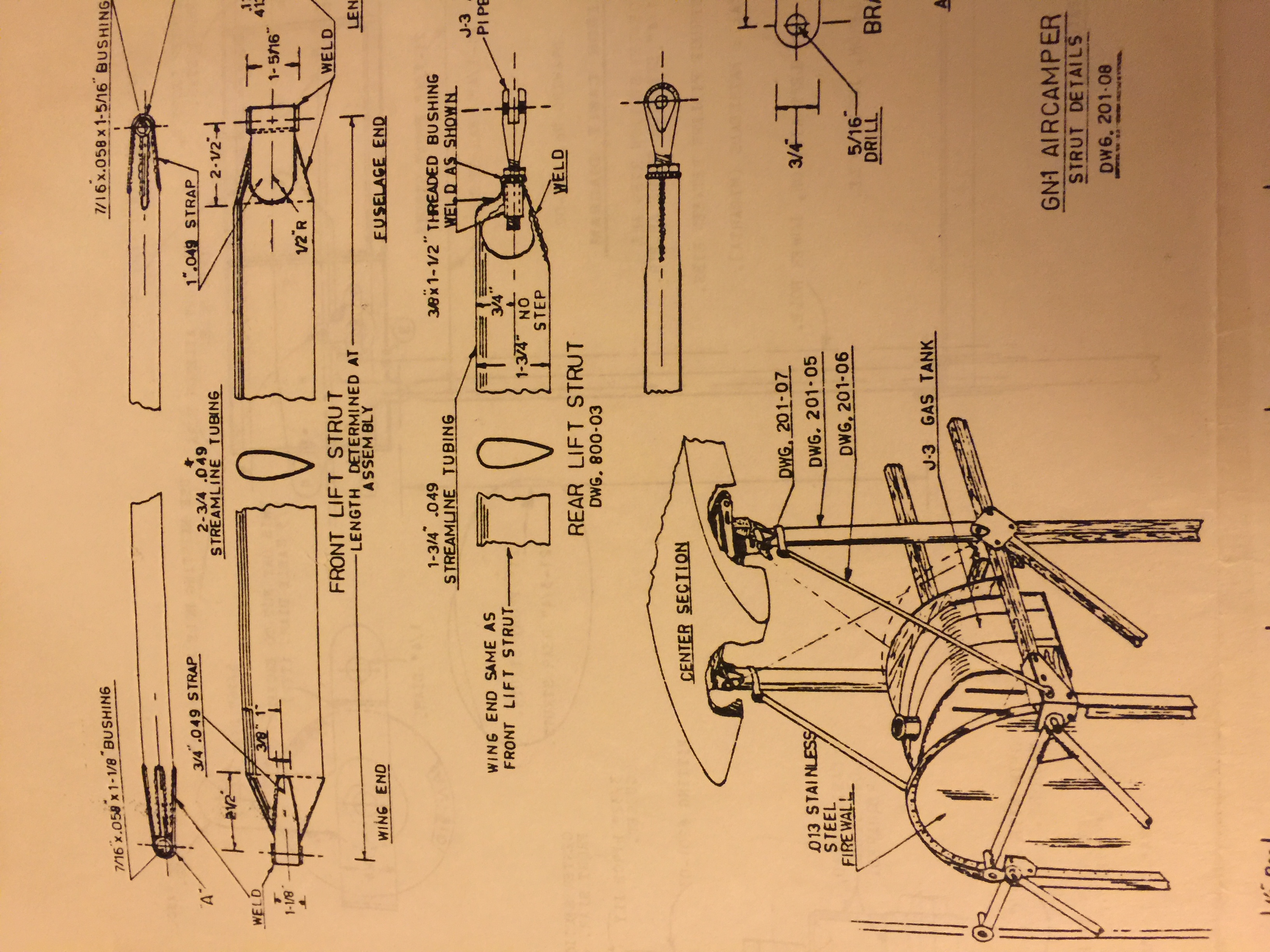

Scott, I just measured the cabane diagonal struts and they are made of
streamlined 4130 steel tubing with a major axis of 1.349", minor axis .571",
wall thickness .049.
Here are some pictures showing their construction:

To see how I made my forward cabane struts to attach the diagonals, look at
the next two pictures:
This is the top of the forward cabane strut. The slotted tab fits into a
slot at the front of the strut and is "pinned" by the tube which runs
through the strut, then the whole assembly is welded together. Simple,
lightweight and strong.
Here you can see how the tube pins the tab for the diagonal.
Here is the final assembly, installed on the airplane:
Sorry to bore you with so many pictures, but it occurred to me that if you

| Subject: | cabane brace diagonals |
Oscar, that is the reason I elected to replace my "adjustable" diagonals
with more rigid ones
Jack Phillips
NX899JP
Smith Mountain Lake, Virginia
[mailto:owner-pietenpol-list-server@matronics.com] On Behalf Of Oscar Zuniga
Sent: Wednesday, March 23, 2016 11:28 AM
Subject: Pietenpol-List: cabane brace diagonals
Marcus;
The reason why the Grega does not have the diagonals is because of the
geometry of the wing attachments at the top of the cabanes. The Pietenpol
Air Camper wing can pivot on the four cabane struts so it either needs cable
X-braces between the side cabane struts or diagonal braces to restrain
everything from pivoting. The Grega Aircamper mounts the wing to the cabane
struts with the bolts inserted longitudinally, so there is no pivoting of
the wing.
To see the effect on adjustable braces when you put an Air Camper over on
its back, here's what 41CC's braces looked like after it happened:
http://www.flysquirrel.net/piets/incident/PB130010.JPG . Once the assembly
yields at any point, it folds up like a two dollar suitcase, thus the
emphasis on connecting the diagonals to the uprights rigidly.

Message 9
| Subject: | Re: cabane brace diagonals |
1965 GN-1 plans Do show a diagonal brace.
Curt Merdan
Flower Mound, TX
http://forums.matronics.com/viewtopic.php?p=454031#454031
