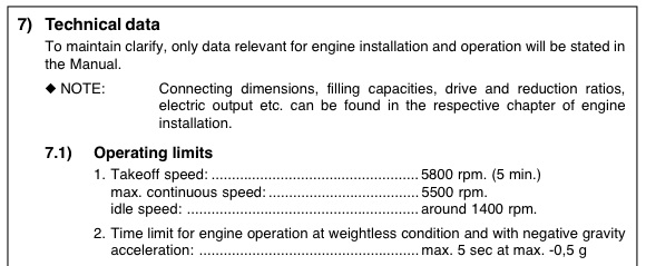

I keep hearing many folks on this list saying that 1800 rpm is minimum recommended
idle speed for the 9 series Rotax engines. Can someone show me in the Rotax
Documentation (not Lockwood) where it says that? The reason I ask is that the
attached file is a snapshot from my 912S Installation Manual.
As you can plainly see it says IDLE SPEED AROUND 1400 RPM. I'm going to piss off
some folks here with my next statement. If you can't get yours to idle smoothly
at less than 1800 rpm, perhaps you ought to have a professional mechanic do
it for you, because something may be amiss in your procedure or your engine.
As the owner operator of your airplane, you are entitled to set your idle speed
at anything you want. If you are happy with 1800, then so be it, but don't tell
me THE MINIMUM RECOMMENDED IDLE SPEED is different from what the Rotax Installation
Manual says unless you can document that in another Rotax Document.

You are right the manual does say that. Yes you can get it to idle at those lower
rpm's, but the reason Rotax teaches in their schools to idle around the 1800
mark is for the protection of the gearbox and other parts effected by vibration.
Because the 100hp has more compression than the 80 hp engine at low rpm's
it bangs away at the gearbox and the mating parts inside including the overload
clutch. No matter what the engine will idle smoother at 1800. The chance of
losing and engine at idle on approach is much higher at 1400 rpm settings also.
Those are the reasons, not that you can't make it idle at 1400 it's the higher
compression hammering and chugging along on the parts with the 100hp because
of the good compression. You may never have an issue at 1400, but later down
the line you may have to do more service work sooner than the other guy on your
gearbox.
You can prove this to yourself using a dial indicator. Set it up against the outside
area around the gearbox (so the motion will be left to right) and let the
engine idle at 1400 and then do it again and let the engine idle at 1800. The
dial indicator will have less impact and movement at 1800. A big factor in this
vibration is as Thom has pointed out that the carbs must be properly synced.

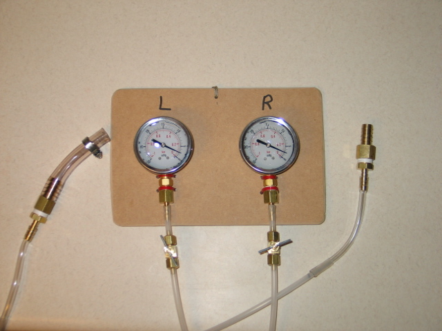

I have posted a picture of a gage set on this forum. It is a liquid filled calibrated
set you can put together for about $55 and it is very easy to work with.
I Have talked many many people through a carb balance over the phone and you
are welcome to call any time. You don't need to spend a lot of money on a balancing
system, but just understand what is going on when you do certain things.
Each person likes different instruments and tools.
520-574-1080 in Tucson, Az.
A carb balance should take less than 30 min. after you have done it once. It is
not something to be afraid of it is relatively easy once you understand what
certain things do when you turn a screw or cable.

I should add a few other comments. My engine is a 914T and if I understand it
correctly it has the same compression ratio as the 80HP engines, so my experience
might not be relevant for the 912S.
The other experience I can share is that although my idle is set in the 1500 ~
1600 range, I typically see 2200 RPM on short final with the throttle closed due
to the windmill effect, so I can say (for my aircraft at least) that a lower
idle speed is unlikely to result in an engine stoppage.
The other pratice I have adopted is to once I have exited the runway is to set
my throttle to 1800 RPM for taxi.
Just as an FYI, with careful adjustment I can get the idle down lower, but as others
have mentioned it really sounds like "rattle and roll" going on under the
cowling so its probably not a great idea.
