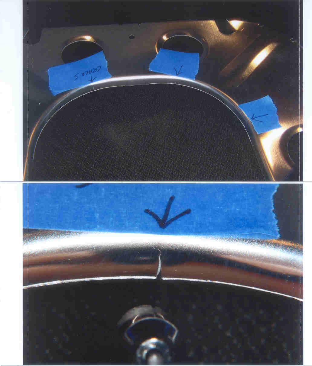

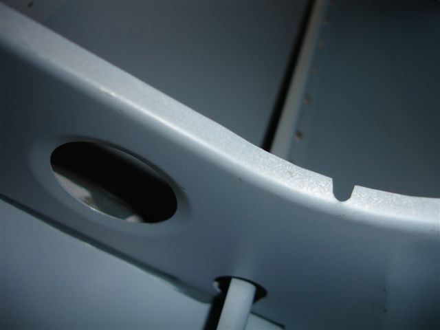

Thanks all for the insight. The bottom line is that I am a little pissed
off that the guy with the English accent was so quick to determine a fix
without knowing the extent of the cracks or how I felt about it. With
something like this, its about the customer's piece of mind, and this is one
case where the clients feelings are right.
Brand new plane, hours and hours of work, my family's safety, the longevity
of the aircraft, possibly someone else's safety, the effort to pull it apart
to remove the part....EEEEEEE! sounds like Charlie Brown.
I think John's, .02 cents is right. I guess I will have to send the parts
back with the form saying "defective". I'll pay the freight back, which I
shouldn't have to. If they charge me for freight to send the new parts,
then it is letter time. It should be letter time anyway and perhaps it will
be since this will delay my building for a week and a half or more. What
else will I do. This is bad customer relation from a very innocent thing
with potentially huge implications.

My .02, call them and tell Van's that you are returning the parts, and have
them send a new one. They will send it to you, and work on something else
until it arrives. I have learned that Van's is very good about replacing
parts, and they are just as interested as you are in getting a good product
out the door.
Jump ahead in the plans until the replacement part arrives. Or deburr
something.
Bob K

Posted: Tue Feb 07, 2006 2:31 pm Post subject: Re: Pictures of bulkhead cracks |
After reading about John G's bulkhead cracks, I checked mine over. I guess I got some of the parts that had stress cracks from hydro-forming the bulkhead and you can clearly see where Vans' filed them out.
I'm not too worried about it because I have plenty of flange leftover. It seems that Vans fix to this problem will be to shorten the flange on subsequent bulkheads.
Zack
