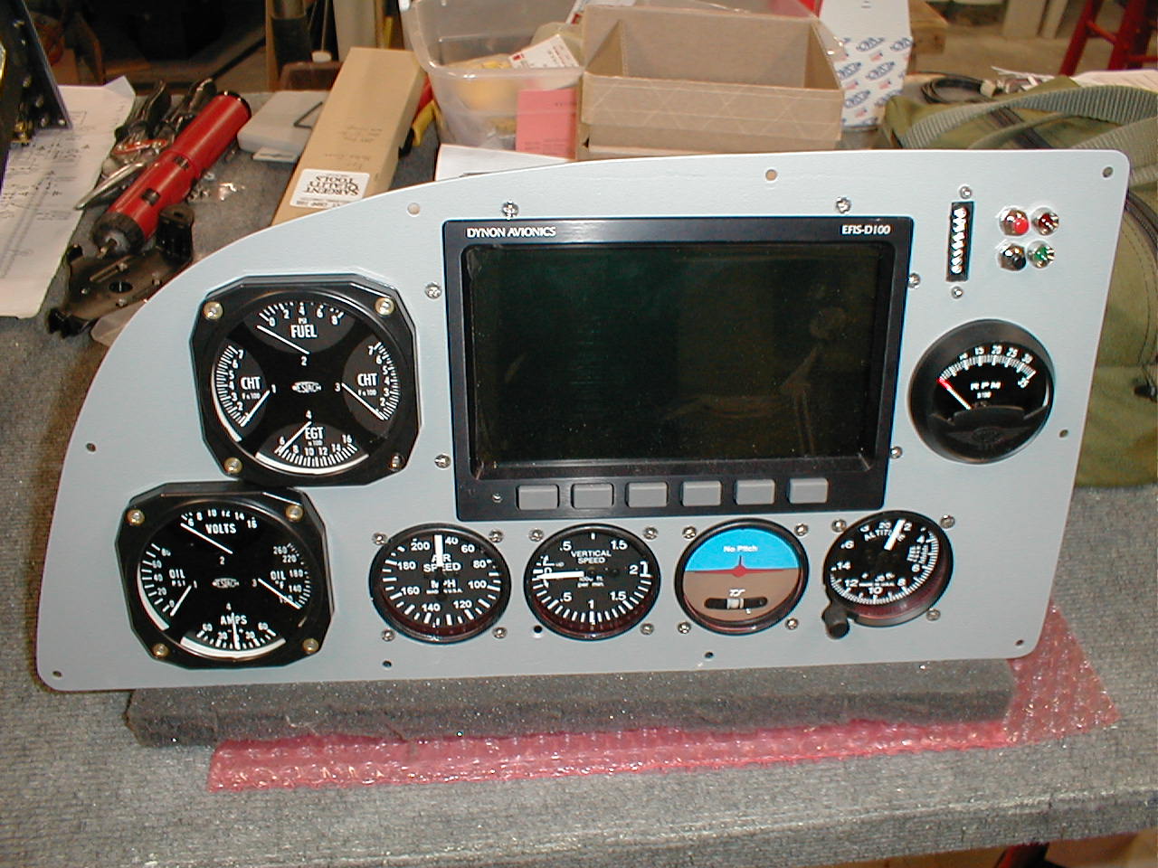

Just got back to my home computer. Here is a pix of my Dynon setup.
Mike Duane A207A

One other item I forgot to mention.....for power connection through the firewall I have installed a unit that has two plates with about ten positions for spade/quick connect fittings to attach to, one for each side of the firewall and has a large bolt going through the firewall connecting them together to which you attach the cable coming from the battery after going through the 30 amp fuse block. I have another one used for the ground side that doesn't have a inline fuse.
This is available from Electric Bob at AeroElectric.com. But I've attached the .pdf picture of it.
